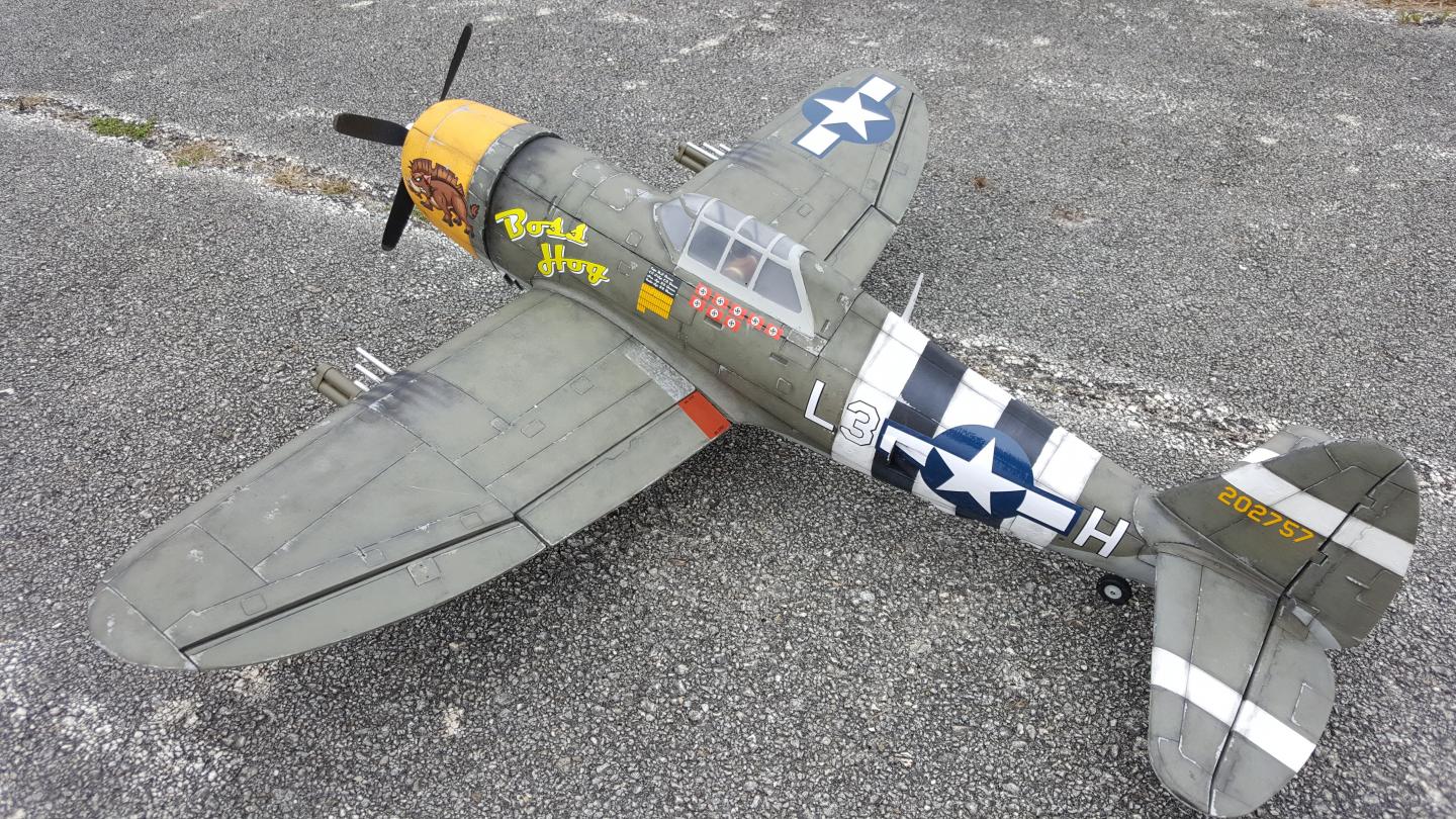

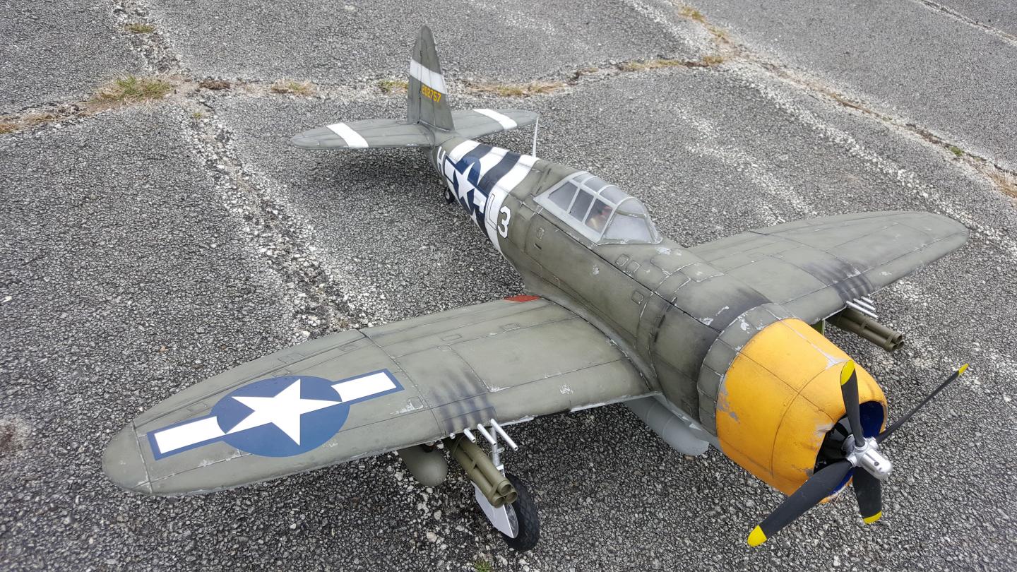

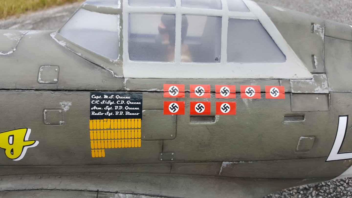

                        Paint it, dude! I know it is great when they offer multiple livery, but I always end up doing my own scheme anyway. The end results are worth it when that sucker flies by 10' off the deck. Looks fantastic in the air. Here is mine. This was done with Home Depot BEHR flat finish interior latex. I pick my color and have them mix up a sample can that is around 8oz, I think? Around $4 or so per can. They last, too, and one can could easily coat multiple planes. I apply it with a quality brush that doesn't have cheap plastic bristles. Use a painting brush made from hair. The trick is to put it on lightly, evenly and without a ton of strokes. As it dries, brush strokes will disappear.
                        In my humble opinion, I cannot recommend Dynam. They are cheaper, yes, but the quality, finish and flight characteristics have no comparison to other brands like Flightline, FMS and E-Flite.
                        *P.S. I forgot to mention graphics are from Callie Graphics, of course. She does great work, and typically my planes are maybe $25 - $35 per livery.
