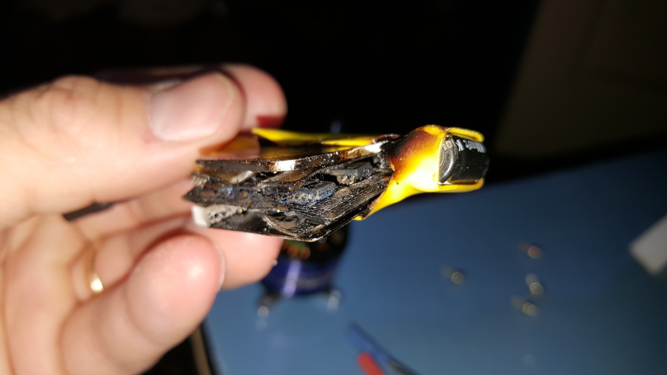

    I was attempting to take off on some grass and had a couple prop strikes... nothing serious all low speed stuff. Eventually gave up and gave it a toss to get her up and flying... it flew like before except it lost power pretty quick and I could tell something was wrong. I brought her in for a landing and when I walked over and picked her up she was smoldering.... low and behold the ESC burned up... just wondering if there is any correlation between the prop strike and the ESC burning up... Click image for larger version

    When you had your prop strikes did you immediately pull the throttle back or was the throttle advanced at all with the propeller stopped.
      The Detrum(Dynam) 30A ESC's have had a history of lackluster performance.
      Most of their ESC's below 60A had linear BEC's which is not an efficient method of reducing the LiPo voltage for the +5Vdc Rx output.
      Linear BEC's reduce the voltage via resistor circuitry which creates heat.
      Most ESC's manufactured now have switching BEC's which don't produce heat and are more efficient regarding voltage sapping the LiPo.
      Doubt that the prop strike had anything to do with the meltdown....more like old school crappy tech.
      Would recommend the newer Skylord by Tomcat which is a Dynam brand and has the new tech.

        Sorry....the days got away from me...phew! To answer your question oletimer....I IMMEDIATELY cut power..I would bet I even was able to cut it before the prop strike even happened...
        OV10....thanks for that info....I was hoping somebody would say that about the old tech...
