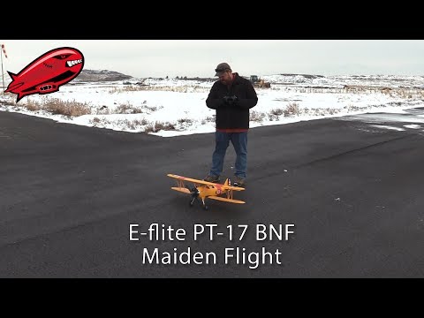

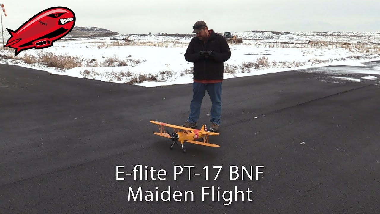

                I totally agree with not using this as a first model, it has proven to be difficult to get the CG right.
                Here we have Jared doing the maiden flight and he handles her like a champ.

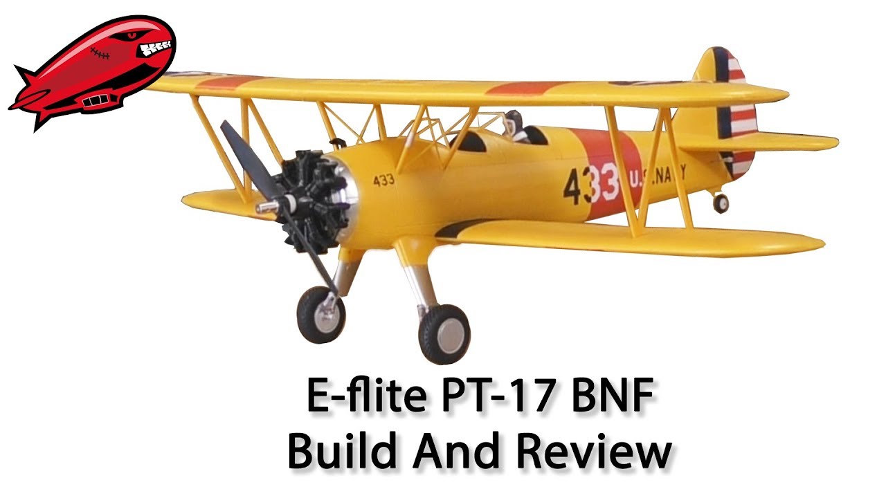

                                  This video helped me a ton.
                                  Good luck with the maiden - you got this!
