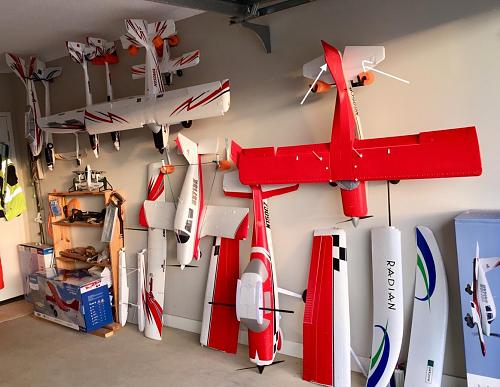

Name:	E-Flite Airplanes.jpg
                    A great flight at our nearby beach with the Timber & UMX timber both with on board camera 808 #16
