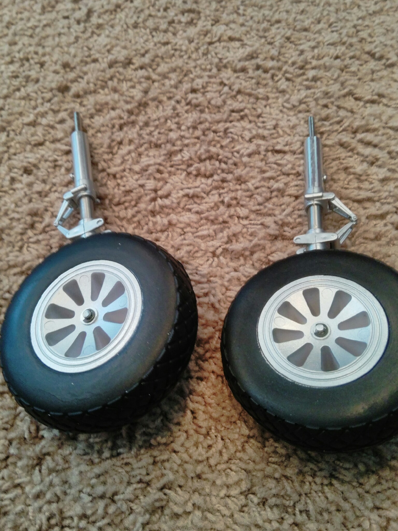

I have a 1700 mm gear set (main) that I have no use for. They are not the standard ones as I had them made for me. They are just gathering dust in the box on the floor. You may have them if you wish. I cannot charge you because this is a forum and not a sales and swap forum. If you want them, you will have to pay the shipping charge and nothing else.Comment
RE: 1700mm Mustang retracts
Roger. I will email you for you address.Originally posted by CTPhoenix,Originally posted by PheonixHere is a pic!
Looks good, I can use them , my email chrstinn@aol.com
Chris
[hr]
I just sent you an email for mailing address.Comment
