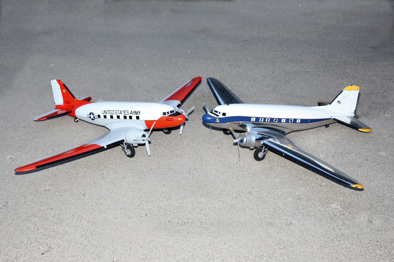

          I have had two of the Dynam DC-3/C-47.  They are very nice flying models.  I painted on in a 60's U. S. Army scheme and wrapped one as the Chesapeake and Ohio Railroad's first corporate plane in 1956.
          There are a few mods that are not absolutely necessary, but that make the plane more enjoyable.  It sounds like Motion had Dynam take care of the most problematic issue, the tail wheel.  In Dynam's defense, the real DC-3 tail wheel is a simple castoring wheel.
          The second is removing the down thrust in the motors.  It is a simple mod, remove the motor boards and trim the top mounting lugs then re install.  This helps with ground handling more than anything else, nose overs all but go away with this mod.

            Those are beauties! Thanks for the info. Wish I could get an unpainted one. Doc
