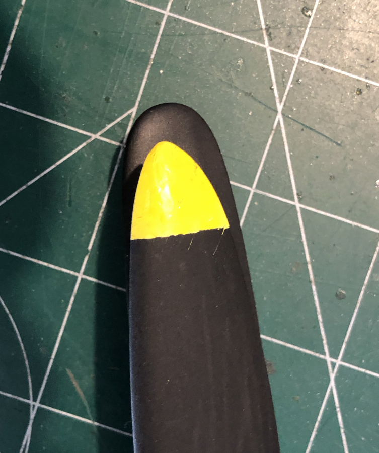

              Had to get rid of "PAT and WALLEYE". Don't like the fake blue for spinner and tail and they are now yellow. Matching the brown color was a beotch! Mine is now "Yellow Rose" with a Texas Maiden. Screaming for some weathering. I wish they had included the U.S.ARMY decals for the bottom of the wing. Will fly her on Saturday after I figure out how to cram the sound into her.
