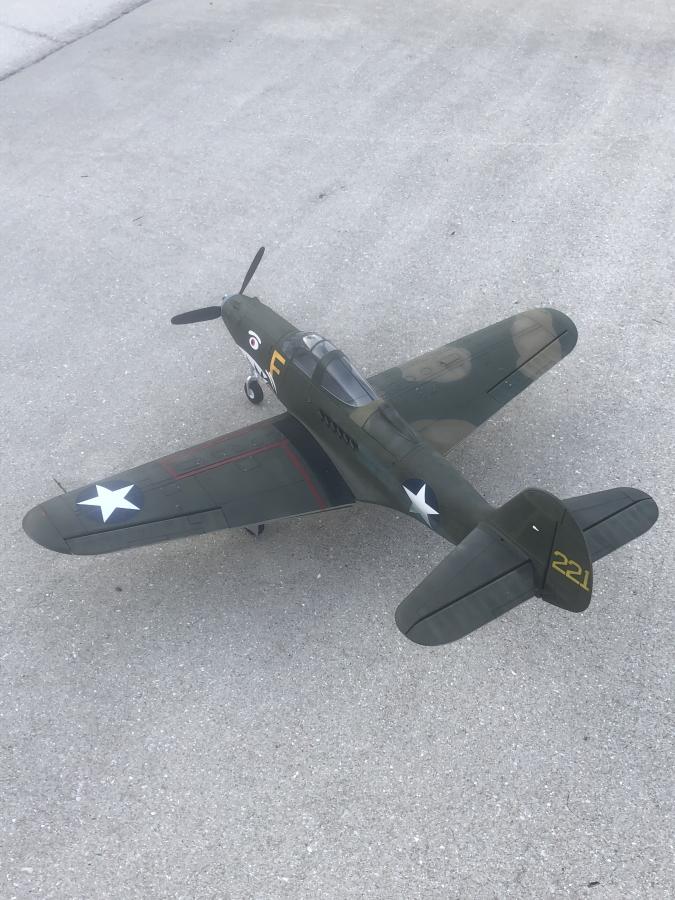

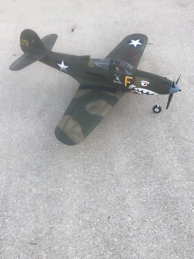

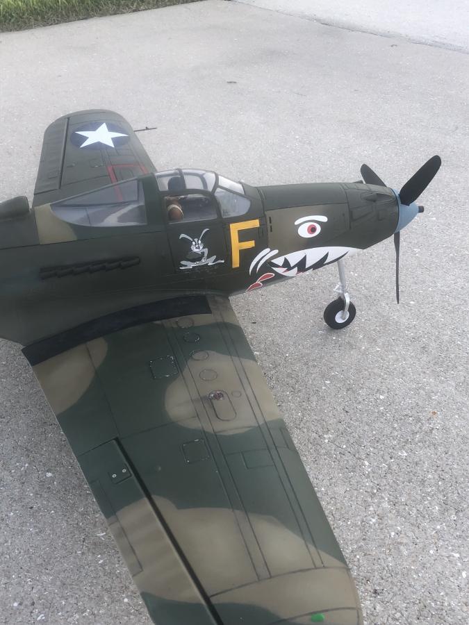

    Just finished my P-400. Callie did the graphics and paint masks. It represents a P-400 that flew out of Port Morsby and Milne Bay, New Guinea in late 1942 and early 1943. And yes the wings don’t match - the aircraft had a wing replaced “in the field” since at that time in WWII there was not a lot of planes available so they “kept them flying” any way they could.

        Very nice Alfer! I like the historic rendering.:Cool:
          • 7383
          #44
          Great to hear Alfer. Beautiful historic rendering BTW!

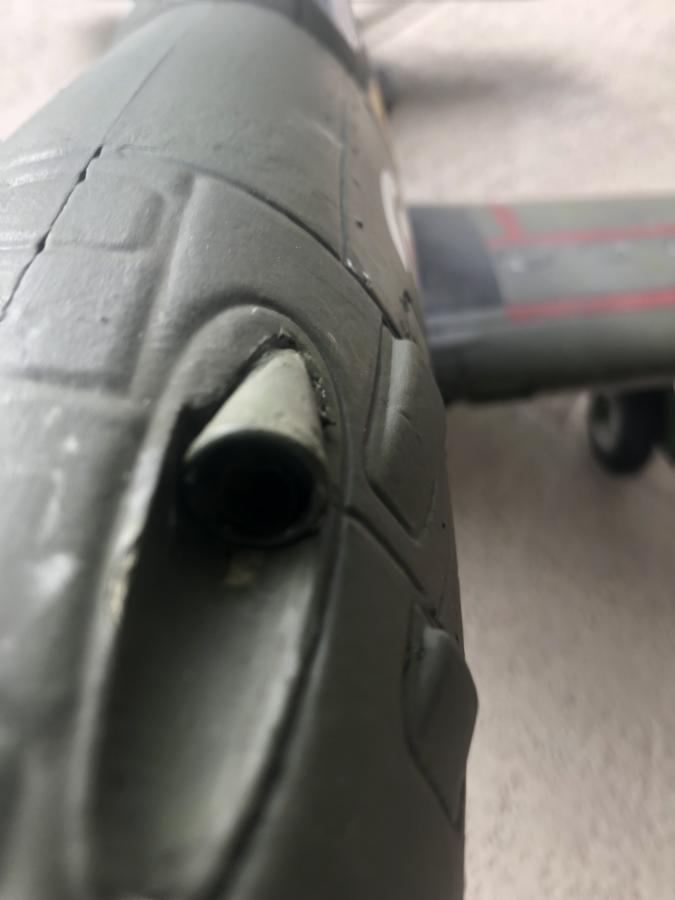

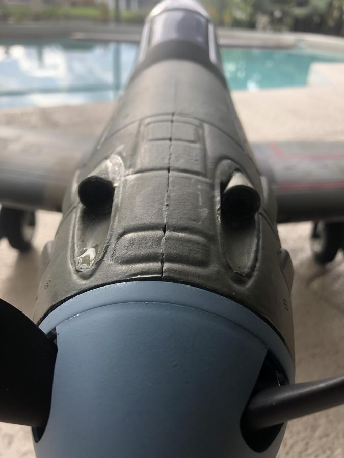

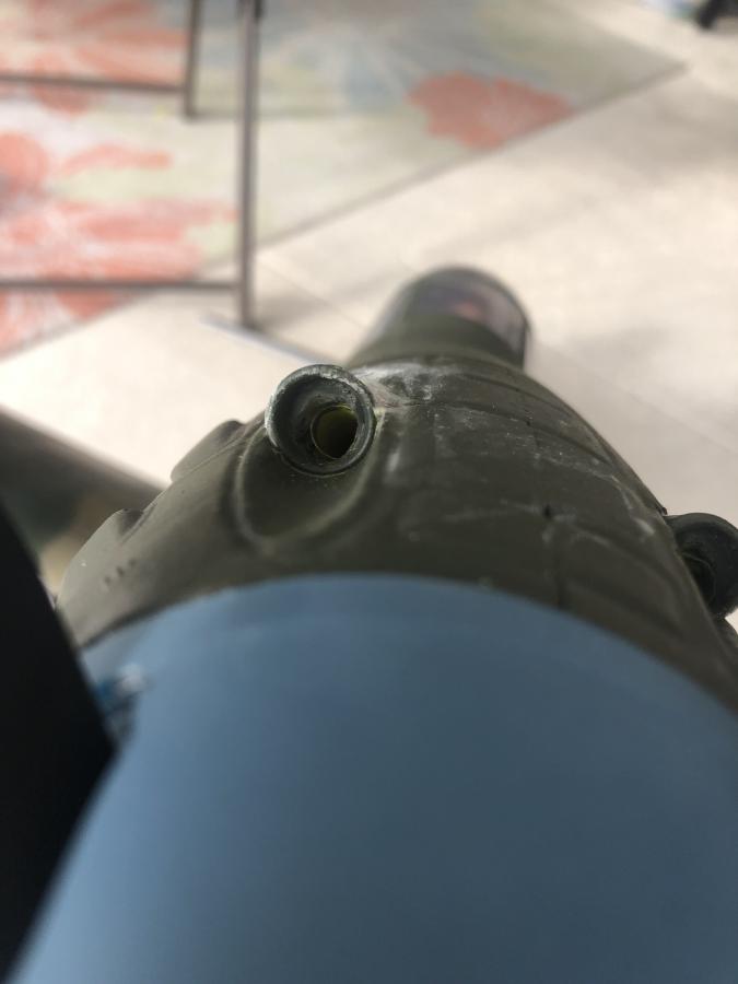

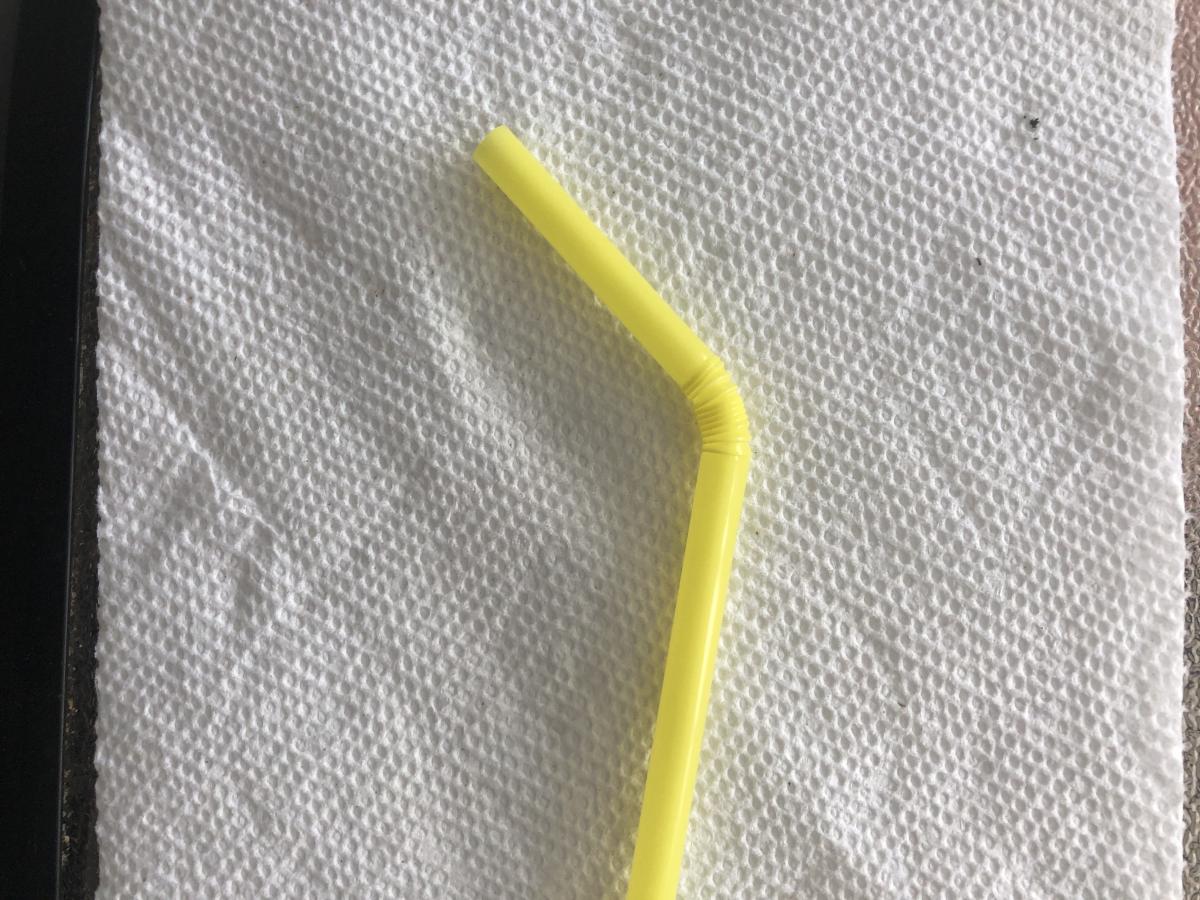

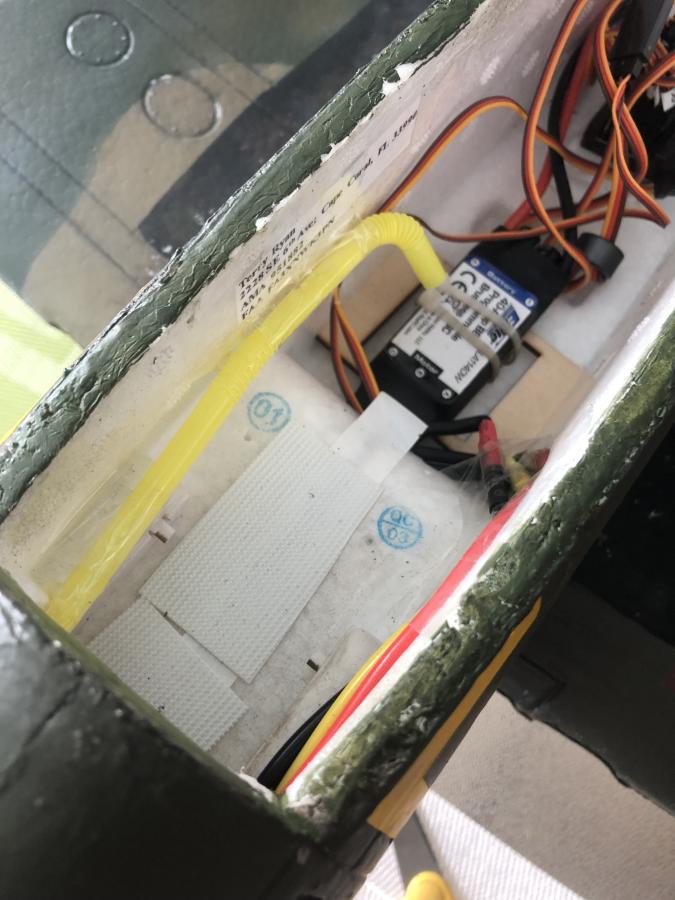

                    Spent a little over an hour this afternoon installing air ducts to cool my ESC and battery in the P-39. A couple of plastic “bendy” straws, X-Acto knife, drill bits (up to 1/4 inch), Scotch Tape, and some Gorilla Glue were all that were needed. The two flash suppressor is in the nose make for an excellent place to hide the straws that act as ducts.
                    Hope the pictures explain the “duct” system better than a long winded written one. Give it a try.

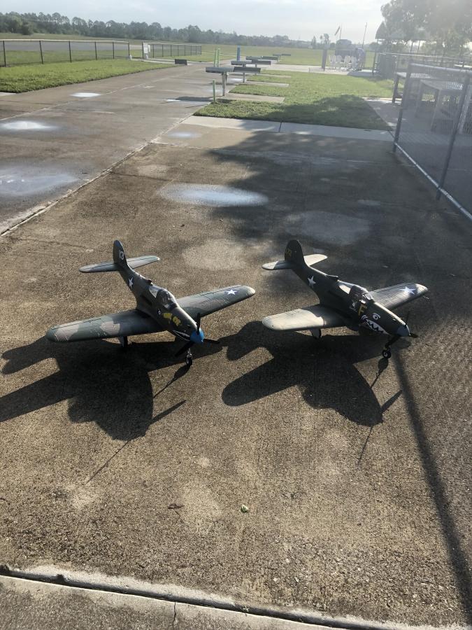

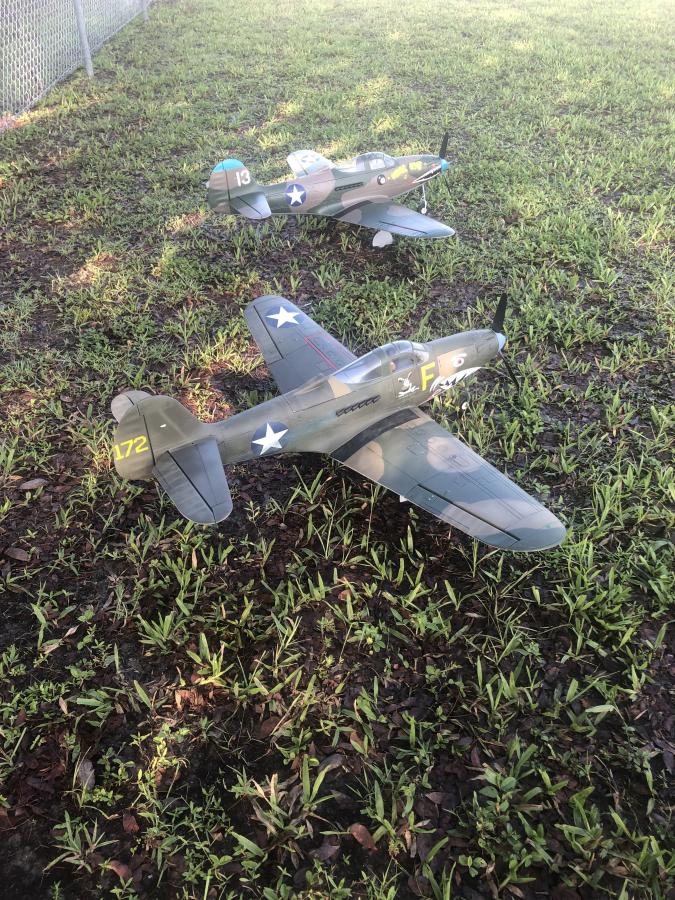

ID:	200953 Cape Coral flight awaits scramble orders :Goodbye:
                      Mission completed !
                      Awaiting next mission.

                        Nice work, dude. I just bought one of these Tuesday night. I walked into the local Hobbytown USA only to find out they were closing the store and everything was on clearance. Got the BNF for 15% off. Not bad.I had my maiden flight yesterday. I still need to fly it some more, and figure out how/where I like the battery to sit. I use 4S 3300mah lipos in all of my E-Flite 1.2m planes without issue. The P-39, however, sank like mad. Nose kept pitching down, so I need to dial in placement. In the air it flies great. It was a bit windy when I flew, kicking 8 to 10knots and a crosswind at that. I had to crab it in on my last flight and was doubting I'd pull it off. Happy to say I greased it. I -love- this plane on approach. It sets into a stable sink rate so easily and it doesn't take much to ease her on in.

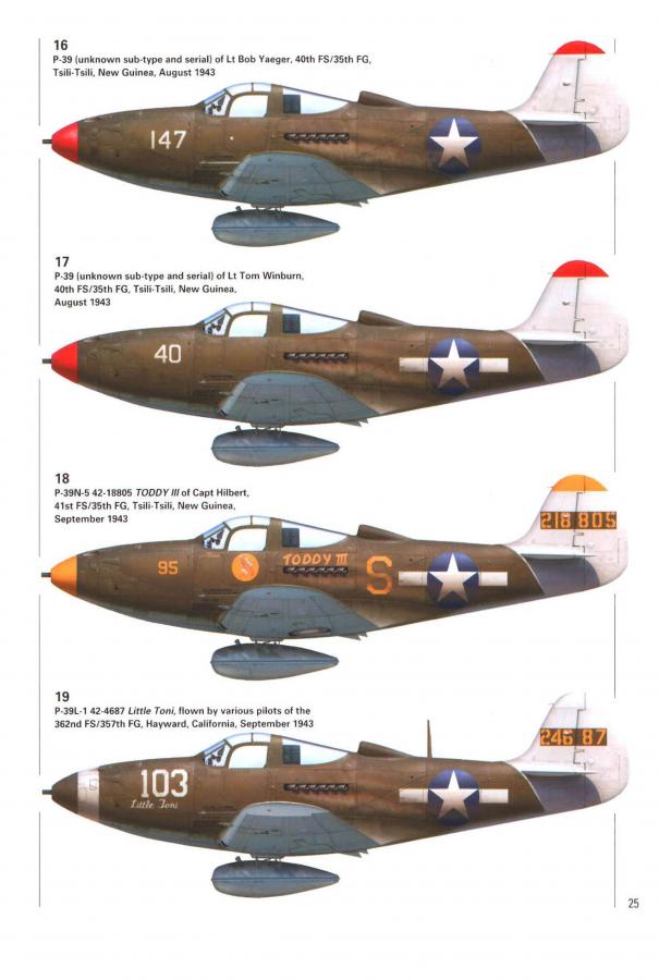

                        I have Callie Graphics working on livery for me. I plan to do the 103 "Little Toni," at the bottom, but might put some red on the top of the vertical stabilizer like the ones above it. It isn't 100% accurate to the livery, but it should help a lot with orientation.

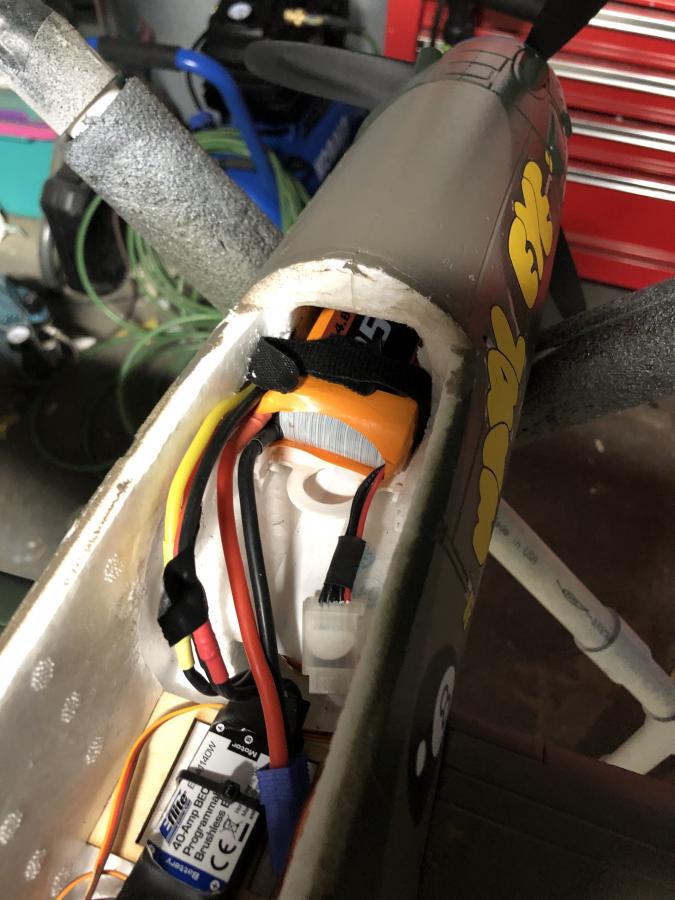

                                  You have to wedge it in there but the Admiral 4s 2500 pros will fit. That is what I fly mine with. I leave the tray in place and slide the battery under the strap at a angle and they twist it so it sits flat. Then tighten up the strap that you can reach. It is wedged in there pretty tight. I can get 5 min of full throttle flight with plenty left on the pack.

                                    Thanks Tim. When you say its "wedged in there pretty tight" is that due to Admiral Pro's length, width or height? I found a Gens Ace 4s 2600 which is 16mm shorter, 5mm less in width but 6mm more in height. Might be able to strap it on the tray outside the plane and slide it in if the height is ok?

                                      The width of it will fit tight against the sides of the foam, After a few times putting it in and out it gets easier. Click image for larger version
