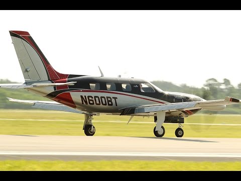

    Click image for larger version  Name:	EF9F003A-CCD8-4389-91D9-1566A80FF716.png Views:	134 Size:	429.2 KB ID:	193569
    I promise not to bore you with any off the shelf kits, although at least one will get put together during this build.
    At 1/6 scale I can keep it in the same footprint as the Ryan for transport.
    Spent 4 hours in one today and will get another 4 tomorrow as PIC from right seat of course.

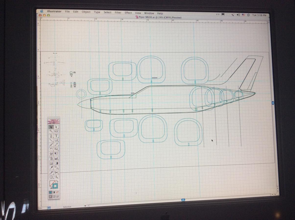

ID:	193881 I’ll start by drawing these and get them laser cut out of lite ply.

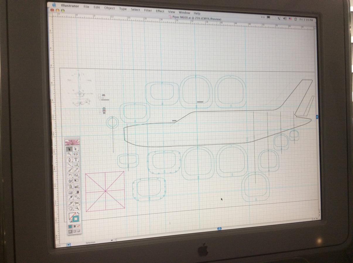

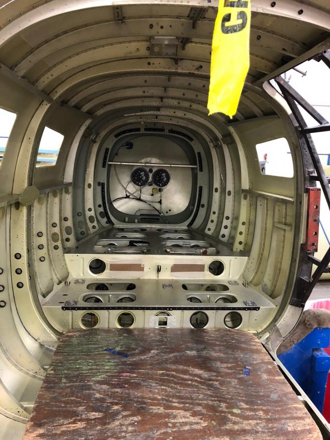

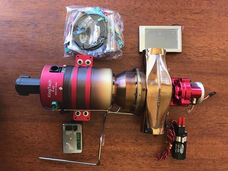

        So I decided to keep this first version electric, but if I can get a sponsor there is room to do a 1/4 scale and install this:

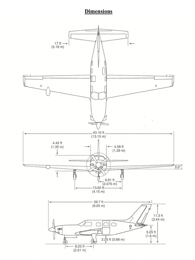

                    Alpha is correct on all counts. Still working on a liaison with my parent company, but as of right now I am using the published 3 view drawings and photos from my visit to the factory. Google the Piper M-500 and 600. The M-350 is a nearly identical airframe but is piston powered by a TIO-540 Lycoming, that maintains 350 HP up to 20,000’ and is pressurized.
                    I am building an electric version M-600 at 1/6 scale. The turbo prop from King Tech would need a 1/4 scale airframe. Since there are no plans I am drawing my own and figured I would start smaller. Also need a sponsor for that turbine and hope to get Piper to back that build. An electric model fits within my budget.

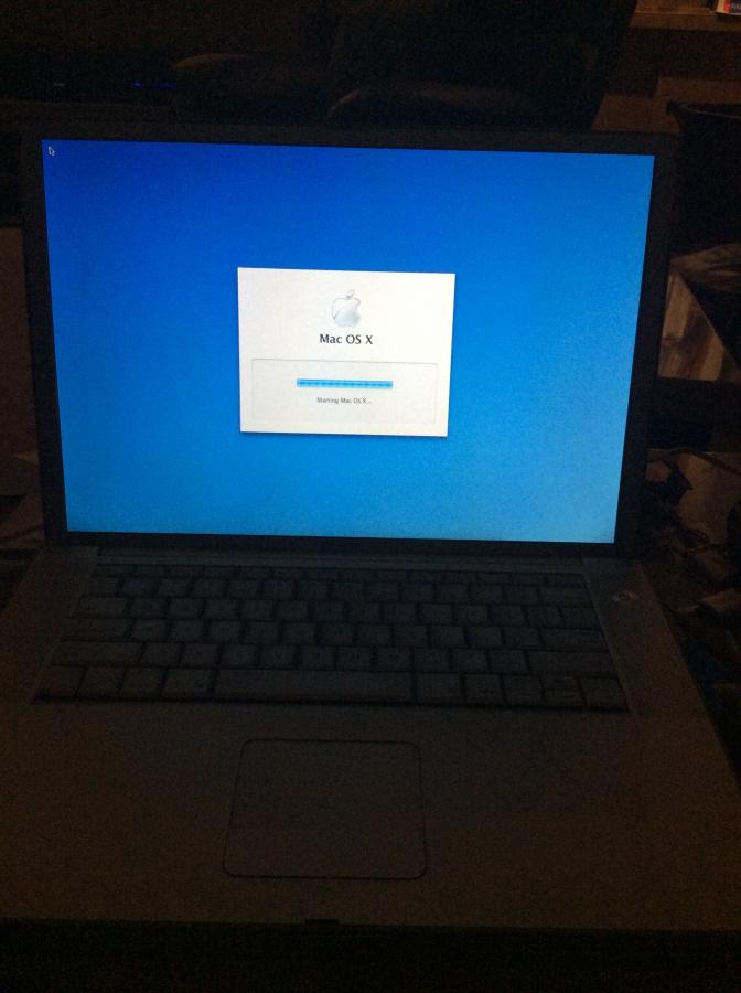

                        Anyone know a fix - PowerBook G4. Tried some of the UToob fixes, but no luck yet.
                        • #13
                          The worst possible issue is likely to be what happened. Failure of the boot track on the HD.
                          Stuck in the middle of loading the OS and, just keeps trying to read the drive?
                          Sometimes you can pull the data from the drive even if it can't boot the machine, by plugging it as an external to a different machine. (they make adapters to do this as a USB external drive)
                          Sometimes its just toast.

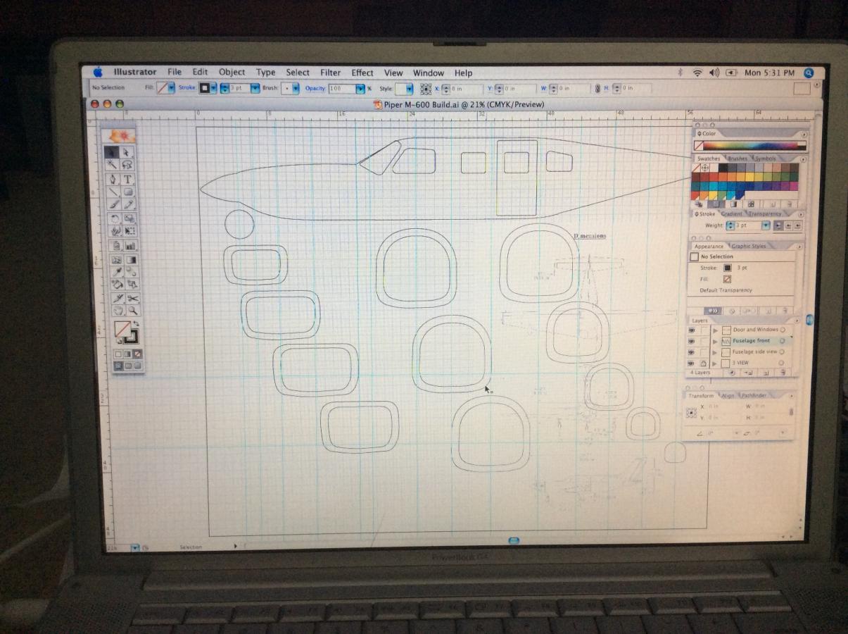

                                    Click image for larger version  Name:	8D6D7D82-543D-451E-BEBE-8EDDDEC31A10.jpeg Views:	0 Size:	125.0 KB ID:	213901 Upper and lower keel, fuselage outline and formers coming together. Wound up changing the power supply in my Mac before I could get started. Light plywood keel and formers will skin with 1/8“ Balsa sheet.
                                    • #19

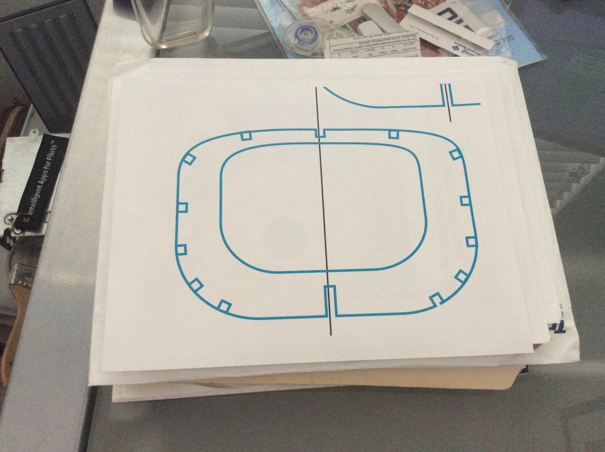

ID:	219582 That drawing board is set up for 72” x 60” and the 100% size former nearly filled an 8.5” x 11” sheet.
