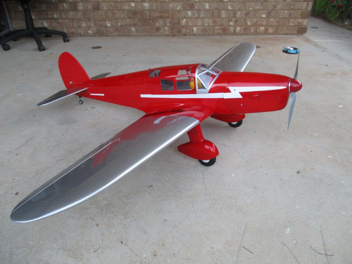

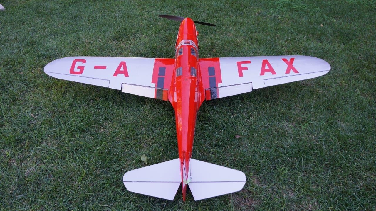

                              Here's my one, Just waiting for the new reg decals from Callie graphics..
                              For the spinner I use ones from theworldmodels.com - Zero Plastic Spinner with Aluminum Backplate 57mm
                              with a 63mm plastic spinner cone which I cut down to fit on the aluminum backplate - roughly cut 30mm off the bottom :)
                              might paint the spinner white of silver yet ...

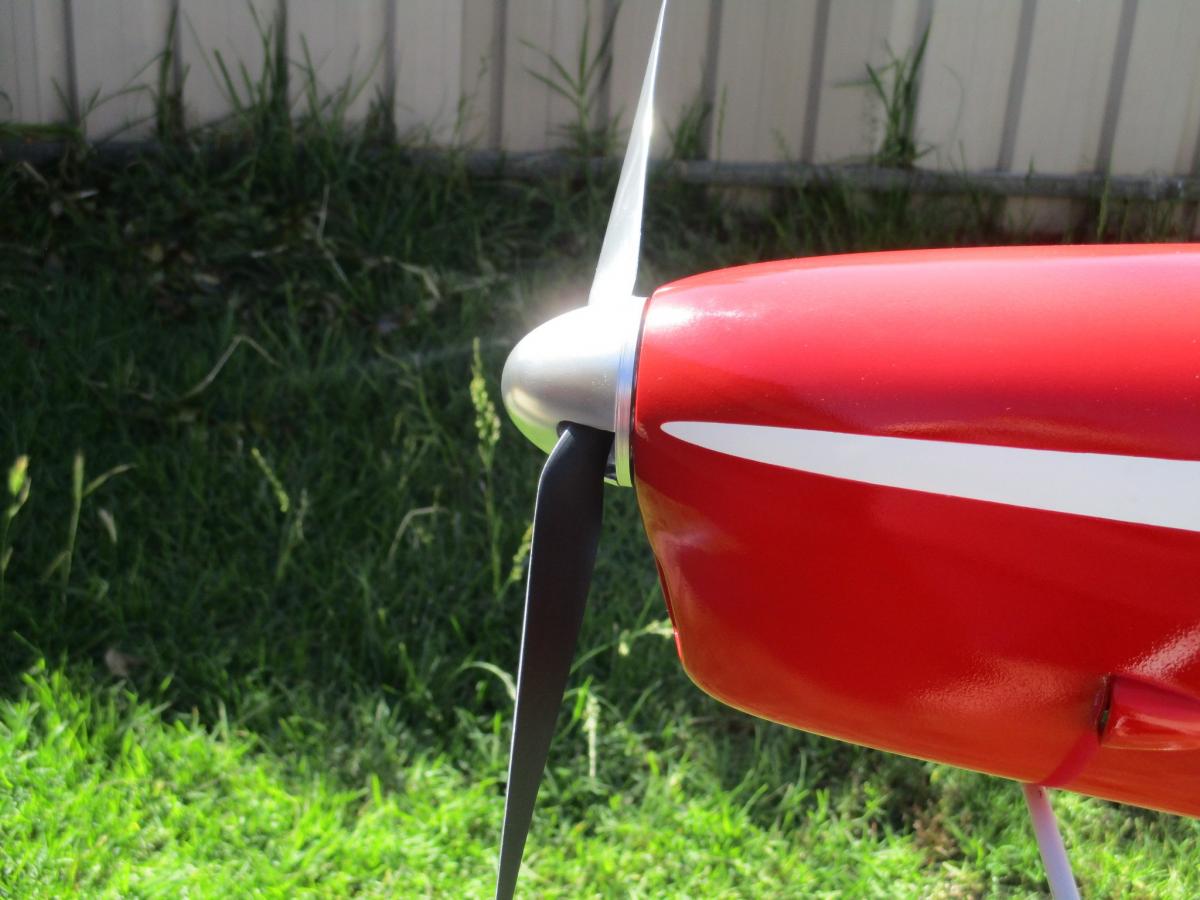

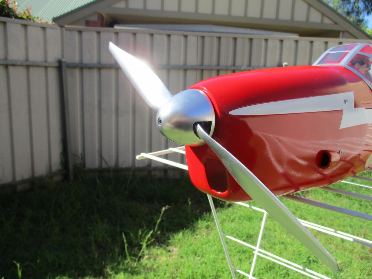

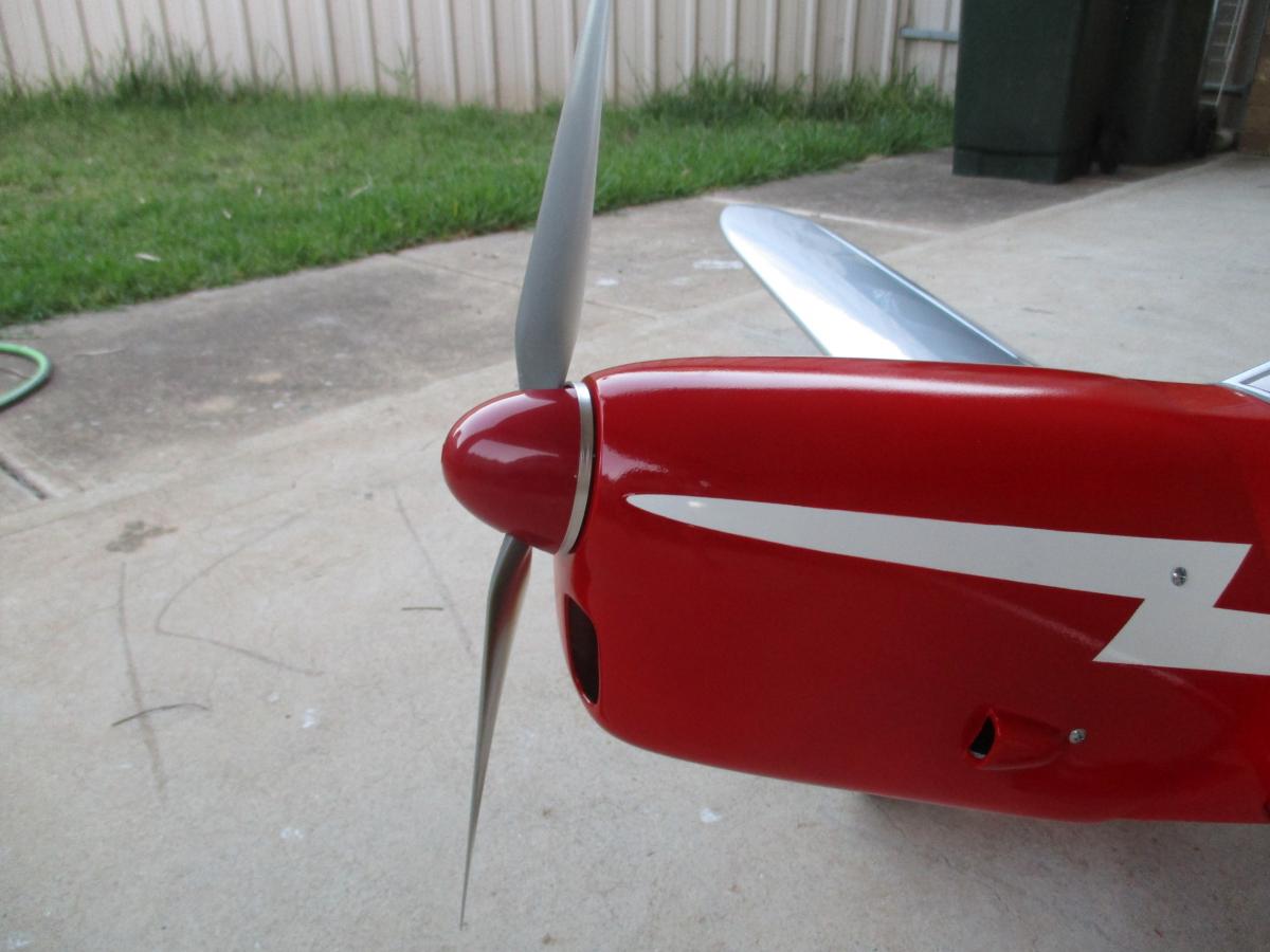

                                  Painted the spinner and prop Silver :)
                                  Click image for larger version  Name:	IMG_0804.JPG Views:	0 Size:	102.4 KB ID:	218720Click image for larger version  Name:	IMG_0805.JPG Views:	0 Size:	104.6 KB ID:	218721
                                  • #18
                                    Terminater007 That looks nice in the silver.
                                    • #19

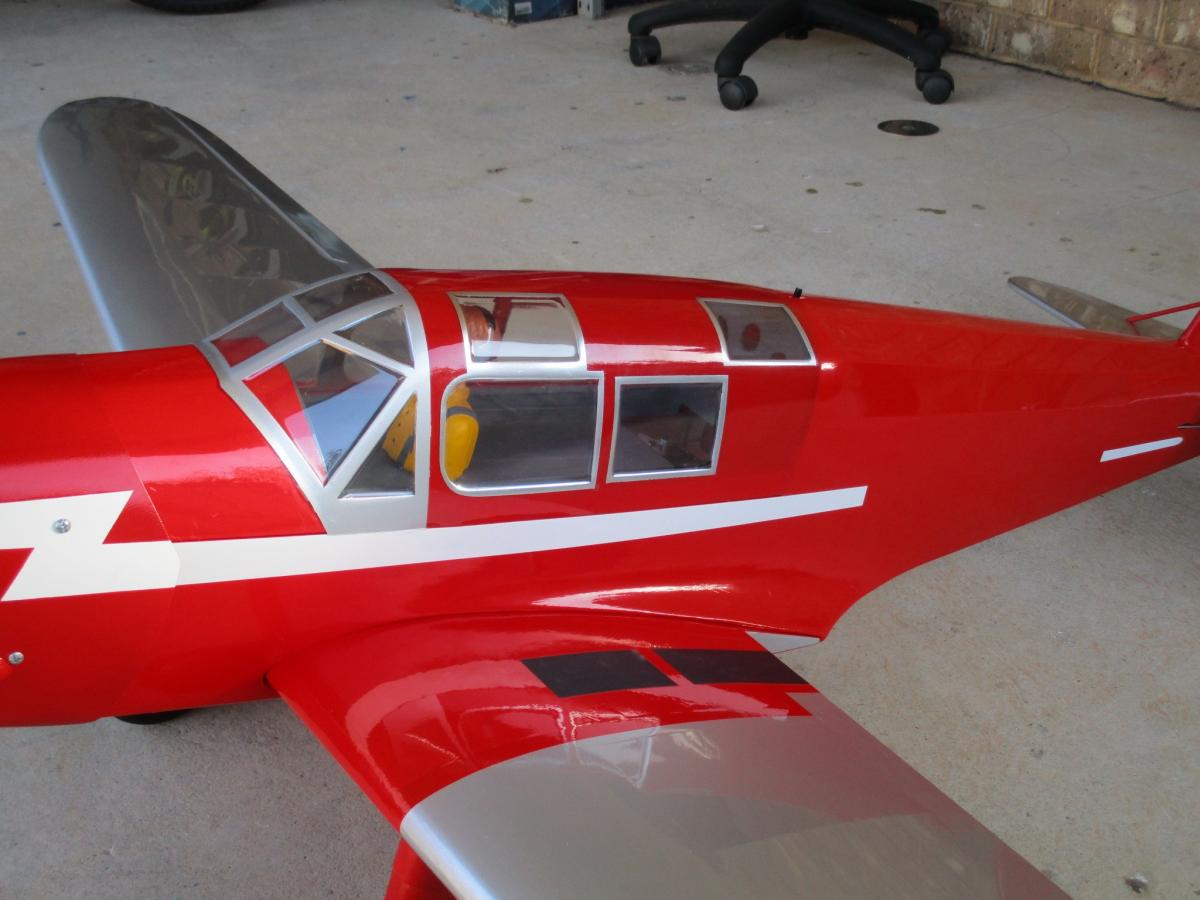

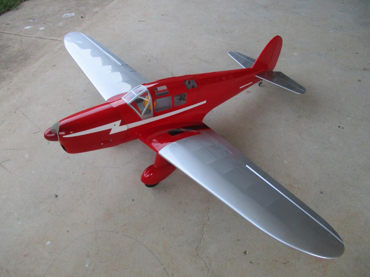

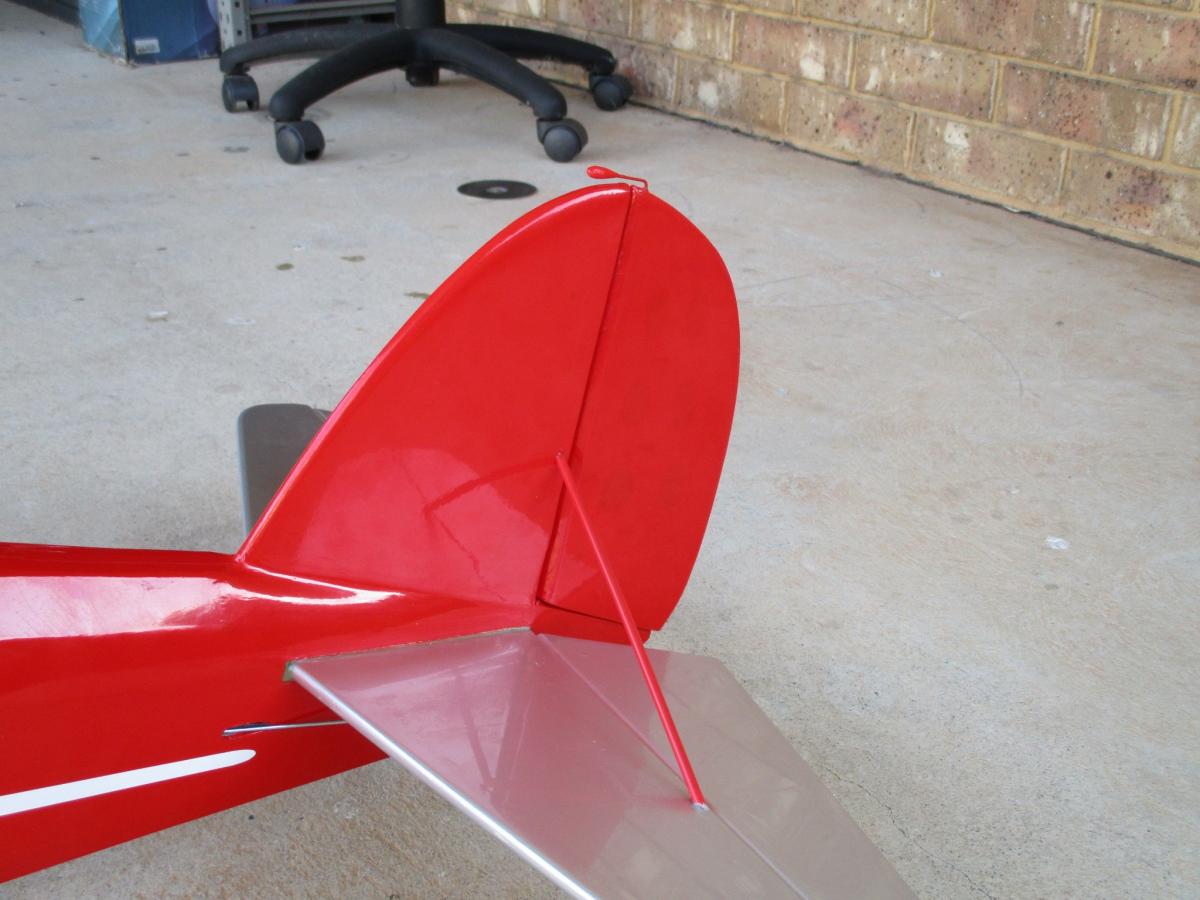

                                      Painted around the windows and added some struts and a mass balance :)
                                      Also flown the plane and it flies with a couple clicks of up trim and that's all , fairly quick little plane :)
                                      Powered by a turnigy L5055b 600kv on 5s 5000mah it flies quite happily on under half throttle.
                                      Still waiting for the rego decals from callie which should come this week..
                                      Click image for larger version  Name:	IMG_0874.JPG Views:	0 Size:	91.3 KB ID:	219608Click image for larger version  Name:	IMG_0875.JPG Views:	0 Size:	99.5 KB ID:	219609
                                      • #20
                                        That's a nice improvement! Every little bit helps; I really like the counter-balance.
                                        Your power system sounds like a spritely one. I only ever flew mine on 4s, so I imagine it's quick at full tilt on 5s! What kind of flight times are you getting at sub-half throttle cruise?
