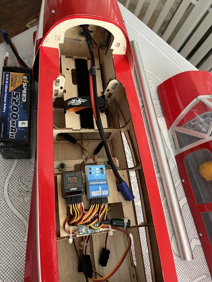

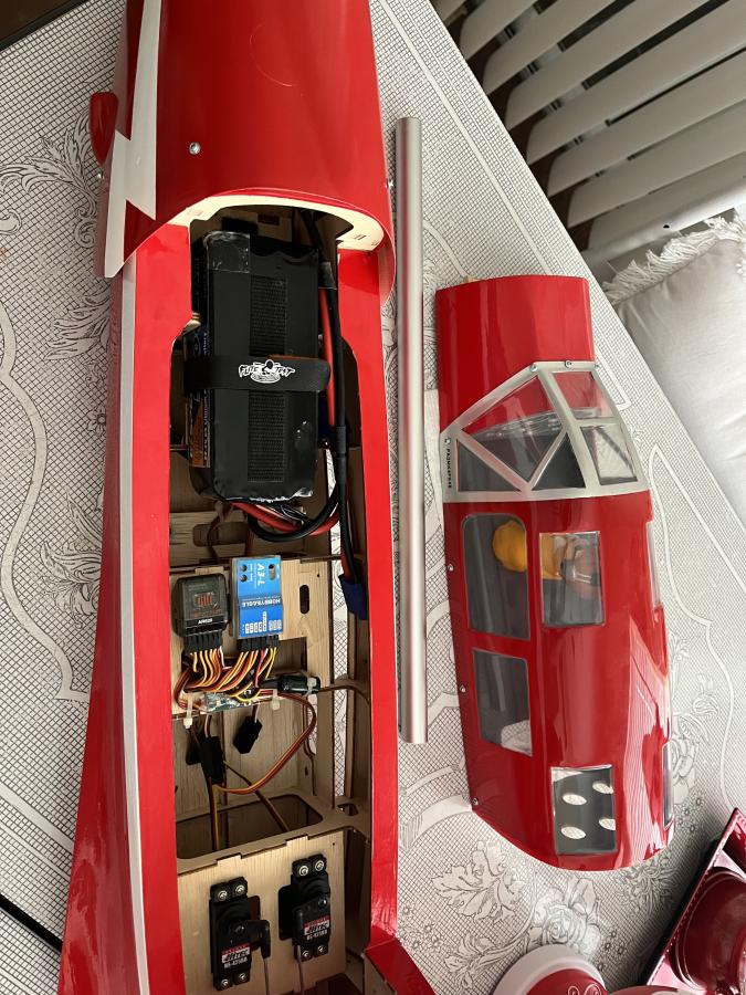

            I just picked one of these up and I'm at the point of balancing the aircraft.
            My setup is electric.
            62 6000 battery is positioned where the fuel tank would go. Is this the correct location for the lipo? It cannot be placed anywhere else due to restrictions of the canopy. I cannot pull it back toward the rear for the same reason. The manual picture for lipo placement seems to indicate it sits in a different location. But, then again it would hit the canopy floor.
            I am extremely nose-heavy.
            Does someone have a picture of the placement of the battery in their fuse?
            I am banging my head against the wall on this one.
            Thanks
            Jay
            • #46
              Tiger01,
              You are correct.....
              The battery sits on the same tray as the fuel tank would use. I found the CG with my chosen 6s 50c 5200mAh LiPo is met by placing the battery on the tray with the end of the battery even with the canopy hatch forward bulkhead.
              My set up is as follows:
              Admiral GP10-400Kv motor
              100Amp ESC
              ZTW 6Amp UBEC
              Extended battery wire from the ESC mounted to the motor mount in the cowl
              ESpeed 6s 50c 5200mAh LiPo (654grams)
              My power train uses an external UBEC to eliminate heat generation of my ESC from having to supply power to the RX and external stabilizer. Probably overkill since there are no retracts to pull power from the system....however I chose to deploy a UBEC to ensure the stabilizer has adequate voltage with minimum volt/amp sag.
              This model does NOT require stabilizer.....but I choose to do so for my own pleasure.
              Your set up may be completely different and thus your means of achieving the CG may be different.....
              According to the assembly manual....the CG should be 88mm from the leading edge of the wing and wing saddle.
              The two photos provided show the battery placement, battery tray, power supply, receiver and stabilizer mounting.....I had to use a servo reverser to one of the flaps.
              Hope this helps
              TwistedGrin​

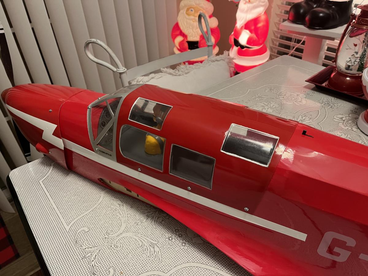

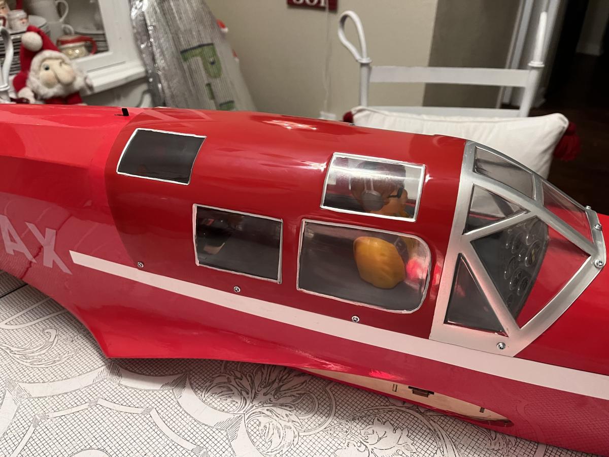

                  Decided to detail my Black Horse B.A. Eagle window trim......I started to tape it all off then use silver paint......then chucked all that to simple use a Silver Paint Pen and do it freehand.....clean off smudges or mistakes with DW-40 and Qtips
                  Easy greasy!!
                  TwistedGrin​

                    TG, Looks like you screwed the canopy down instead of gluing it. I like that a lot. Wish I had done that. I glued mine.
                    I intend to put up a full build review in the coming days. For now, I'm showing the canopy that I chose to pinstripe.
                    JZ

                      I seldom glue my canopy's anymore after I had a pilot eject himself and the dreaded hanger rash crash on the canopy.....the pinstripe will look awsome
