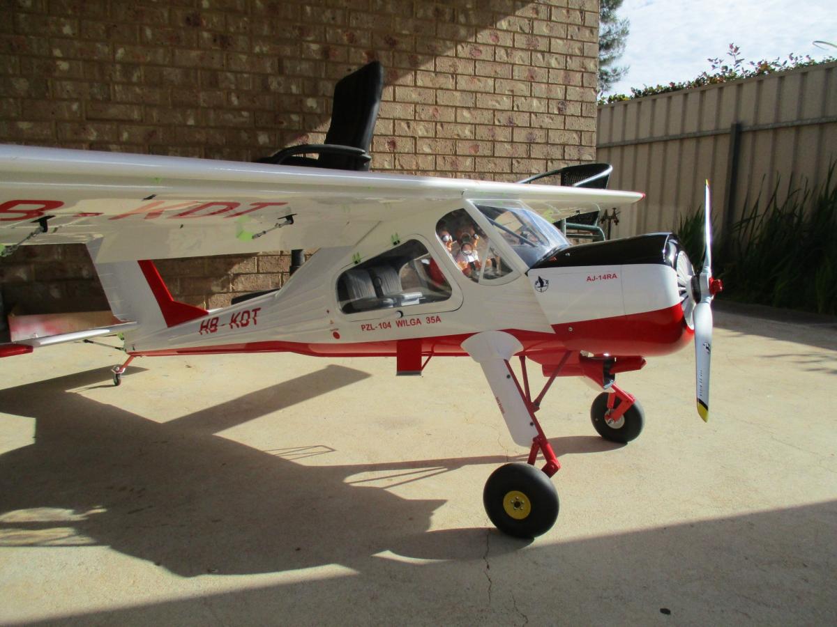

                Click image for larger version  Name:	 Views:	0 Size:	127.0 KB ID:	195225
                This is my one , powered by a Eflite power 160 on 10s 5000mah and with a Biela Scale Wilga Prop
                Has flaperons setup so will take off in about 10 feet :)
                Added the ribbing on the upper control surfaces and Dubro inflatable wheels and also the Steps to get into the plane (maybe a bit small)
                changed the Decals as well , used printable waterslide on the fuselage side rego and self adhesive ones for the wings
                was thinking of putting aerotow on it , but its a bit of a tight fit :)
                I do have telemetry on it and and top speed so far is 125 kmh flat out and slowest level flight was at 21 kmh

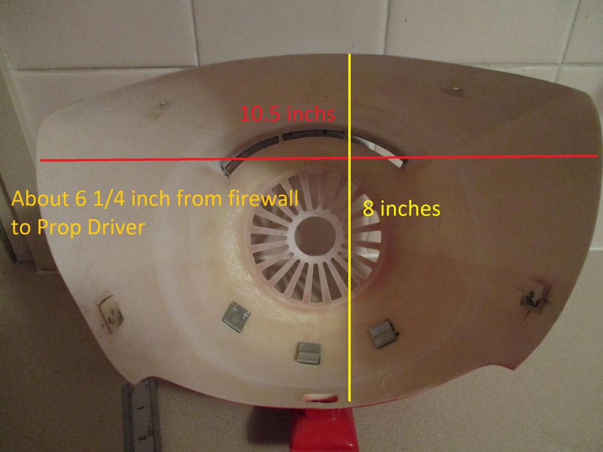

                              One question, can someone tell me the inside diameter of the cowl? I have an Evolution 7 - 35 radial that would be a proper engine for a Wilga if it fits inside the fiberglass cowl without having to cut it up.

                                Click image for larger version  Name:	 Views:	0 Size:	92.4 KB ID:	195877
                                Took some measurements for u its bout 7 1/2 inch right at the front of the cowl
                                also I added a Half former to help support the Cowl..

                                  #17
                                  Thanks for providing the measurements, looks like the Evo 7-35 will fit with enough clearance to not have to do any cutting.
