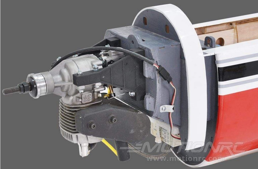

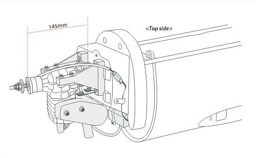

Just unboxed my Black Horse 92.5" Ryan STA and started checking length dimensions to select a Gas Engine that will fit between the firewall and the front of the cowl.
The dimension roughly seems to be about 142mm or a bit more depending on where you place the cowl.
Owners manual has directions for a 120 2 stroke OS Glow engine and DLE 20cc gas engine.
Not interested in a glow engine and I feel a DLE 20 may fly the plane but with not much authority for simple aerobatics.
A DLE 35RA would be a better choice but the engine length is 160mm so it is too long.
Motion also suggests the 4 stroke NGK 30 engines they are selling but they are too long also.
One option would be modify the firewall and let part of the CARB protrude through it but then you get into problems accessing the mixture screws. Plus a rear mounted muffler will interfere with the firewall.
If anyone knows of other solutions or perhaps some engines with a reasonable price point (under$500) I would really appreciate some help.
