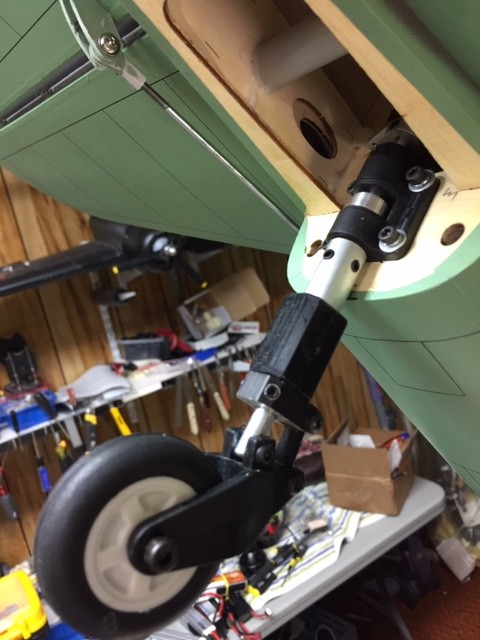

      Just opened mine. Pretty impressive, but I'm wondering if anyone has tried something other than those hard wheels.
              Welcome home to Hobby Squawk, Jukeman! Black Horse makes their own wheels but they do generally conform to what I'd consider "industry standard" sizes in terms of axle diameter and wheel width/height. I didn't try it myself on this Lysander but I'd imagine that a suitably sized Dubro would fit just fine. One thing I would be hesitant about is the load carrying capabilities and whether the wheels would deform over time if the model is stored on its feet. The advantage of the harder stock wheel is it's less prone to such deformation, yet they're soft enough where during actual landings I didn't detect a tendency to over-rebound or to bottom out.
              As I often do, I'd recommend flying the stock equipment first, then adjusting to aftermarket parts if/when your conditions/preferences deem necessary.

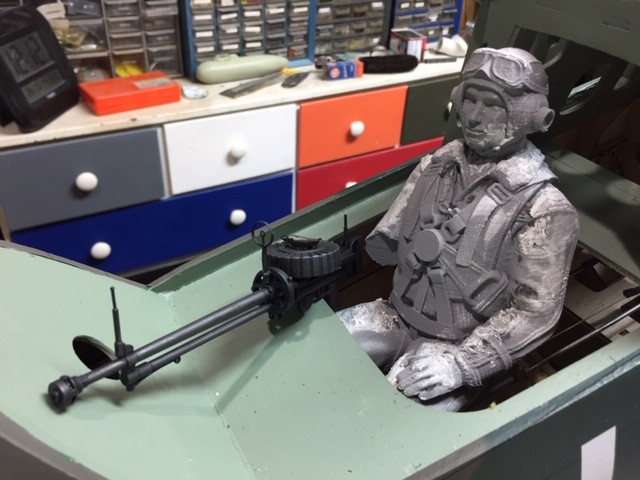

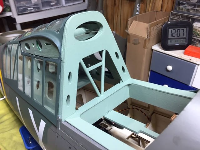

                  Dad has been busy and the assembly is coming along very nicely. The kit was missing the motor plate that goes between the heavy aluminum standoffs and the smaller plastic standoffs that go to the motor X-mount, shown on page 30 of the manual. I assume that was ply -- can anybody confirm this, and also the thickness? I made a replacement from 3/16" birch aircraft ply, and that's all assembled.

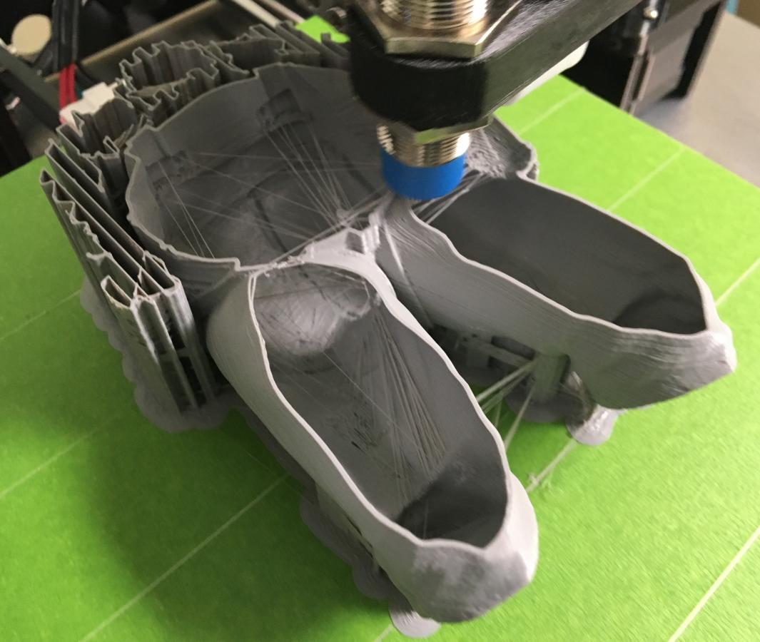

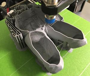

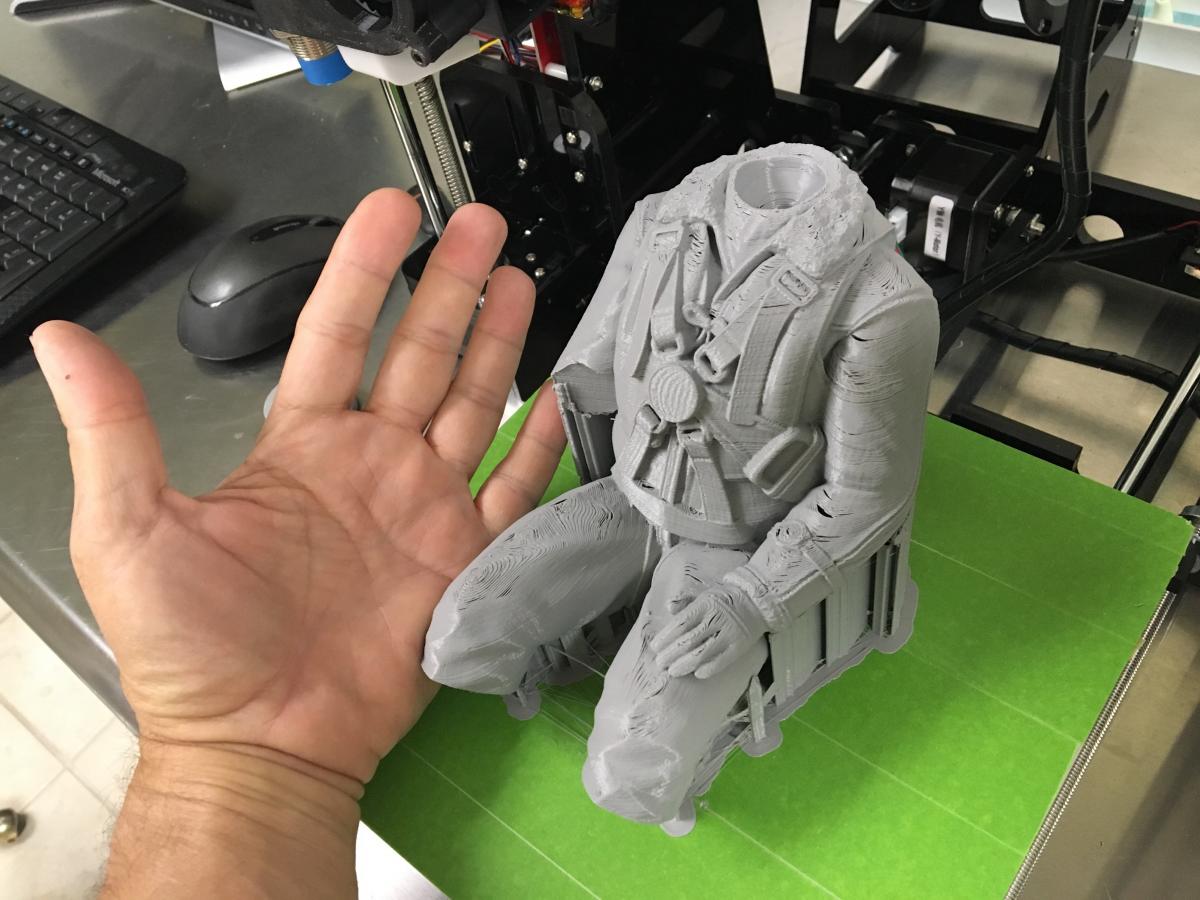

                  I've also started 3D printing the pilot and gunner using Max Grueter's great "Spitfire Pilot" file (cgtrader.com). I recently used his "Me-109 Pilot" file to 3D print the full pilot for my 1600mm FW-190. Max does great work. The provided pilot figure is, I'm afraid, truly awful! I doubt I'll get any argument there.
                    That's a solid plan ;)
                      I got some Du-Bro air filled tires for mine! I agree the stock tires are crap. Still building mine but they fit into the fairings just fine. Not sure how they will react under load, might balloon out and contact the fairings. Hopefully not with a proper inflation pressure. But i’m really impressed with Du-Bro’s tires!! I also replaced the tail wheel with a Du-Bro treaded tire that is much softer. Should provide better traction.

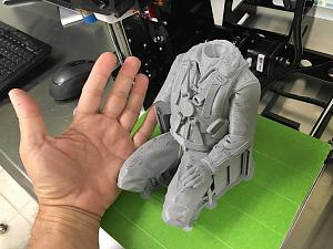

                                  As my son, Mr. Smoothie said, we're in the middle of this project. It's an impressive looking plane and lends itself to the feeling of doing some modeling, as opposed to throwing together a foamie in an hour or two. Two things I notice are different than previous photos showing tailwheel and linkage for ailerons (see attachments). The tailwheel is pretty impressive. As my son said, the pilot had to go, but so did the very glossy, gray cockpit and glassy looking instrument panel. With that out, made some changes to back of removable cockpit and repainted all of the green interior with the Fed Standard 34226 (pea green) available at Home Depot. Pilot, gunner and instrument panel are a work in progress. Gunner will have his very own Lewis machine gun. Only a piece of plywood and a couple of crimp tubes missing. When passing the rudder thru the tube it exited better than an inch below the horn. Had to do some surgery and make a patch. I know this to have happened to someone from Motion who is also building one. Wings and tail came with control surfaces attached by two hinges in each part. When separating them, the hinges fell out easily. Don't know why those holes were drilled so large. Kit is extraordinarily well packaged.

                                    • #38

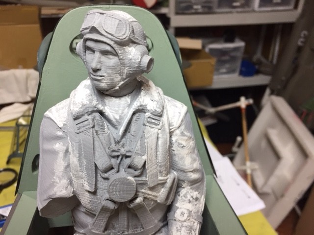

                                      Jukeman, thanks for your report of the highlight and hurdles so far on your build. Your pilot looks amazing for a "work in progress". Where did you buy it, or are you developing it yourself? :Cool:
                                      • #39
                                        thx alpha.
                                        • #40

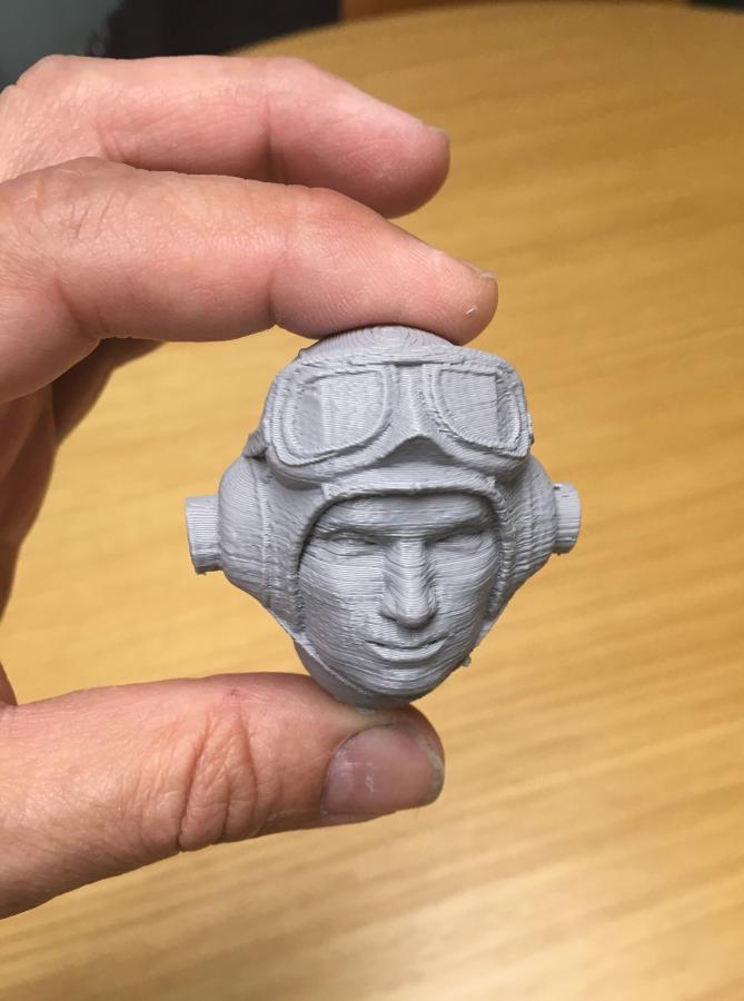

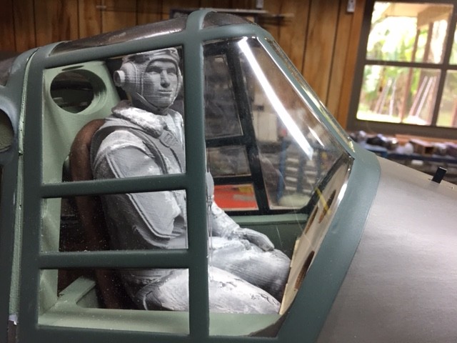

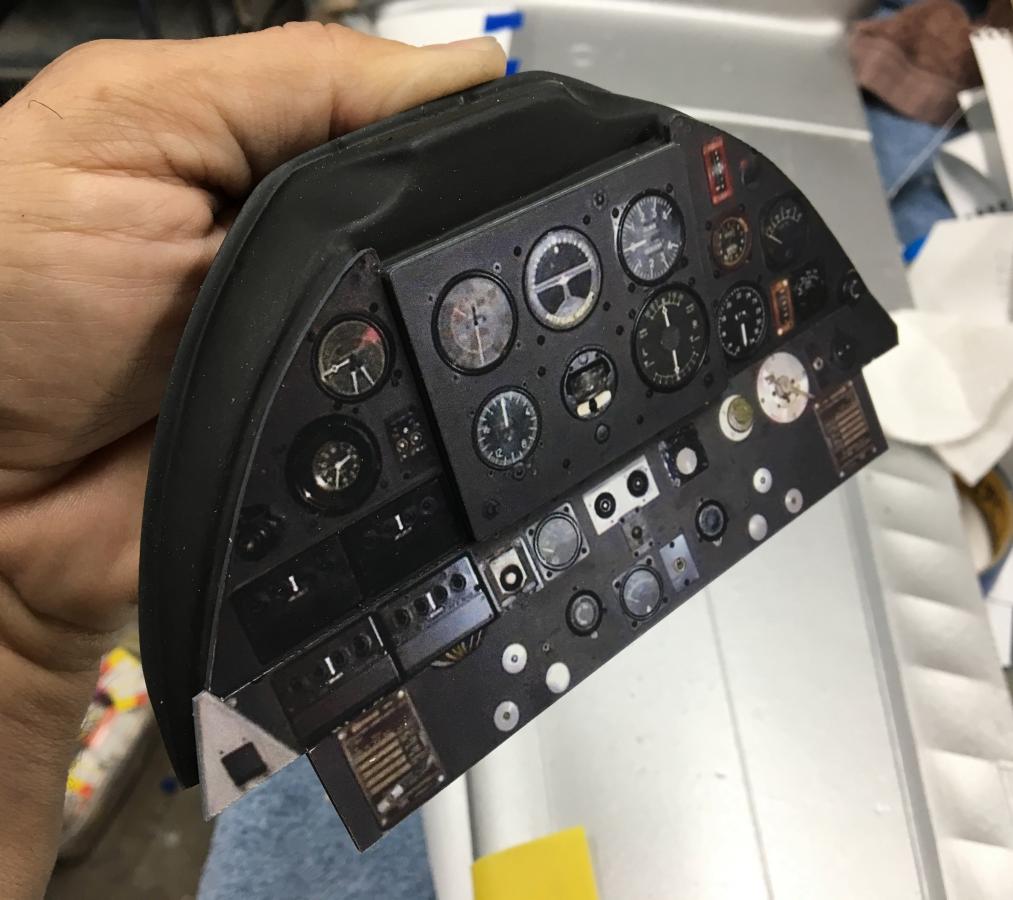

                                          It's been fun helping Dad with his big project, no doubt the most complicated plane he's done since getting back into the hobby. I started with Max Gruder's excellent "Spitfire Pilot" file from cgtrader.com which was $39 -- a real bargain, as I can rescale and use over and over. This is mostly 1/6 scale, although I printed the body at about 90% of the 1/6 scale settings -- fits better and looks fine. After all, humans come in all sizes. I printed them completely hollow (no in-fill at all) and plan to try injecting them with polyurethane expanding foam to give them some resistance to deformation in the heat (not that our planes our out in the sun for a minute when they're not being flown).

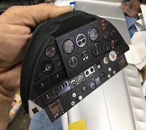

                                          Also working on an instrument panel for Dad based on a decent photo of a Lysander panel undergoing restoration. I did some photoshop work on it and then corrected for distortion and scaling before printing out and laminating to styrene sheet. The bottom is angled slightly and the the center portion is raised. Turned out pretty well I thought.
                                          Last, redid his radial engine with an older Top Flight vacuformed styrene radial -- not incredible, but certainly better than what comes with the Lysander. I did some research and the real engine was rather boring -- originally overall semigloss black. Only one pushrod per cylinder unlike most US radials. Click image for larger version
