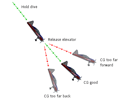

                        Have you guys tried the CG dive test to check your CG's? It's worth the while. It's not an exact process but I've done it a few times with big planes and small planes that I was struggling with a little and it helps tremendously. Here is a diagram I just swiped from doing a search. It's not the best example but you get the idea. There are plenty of descriptions of the process if you search RC planes CG dive test. And probably plenty of youtube videos as well. Click image for larger version

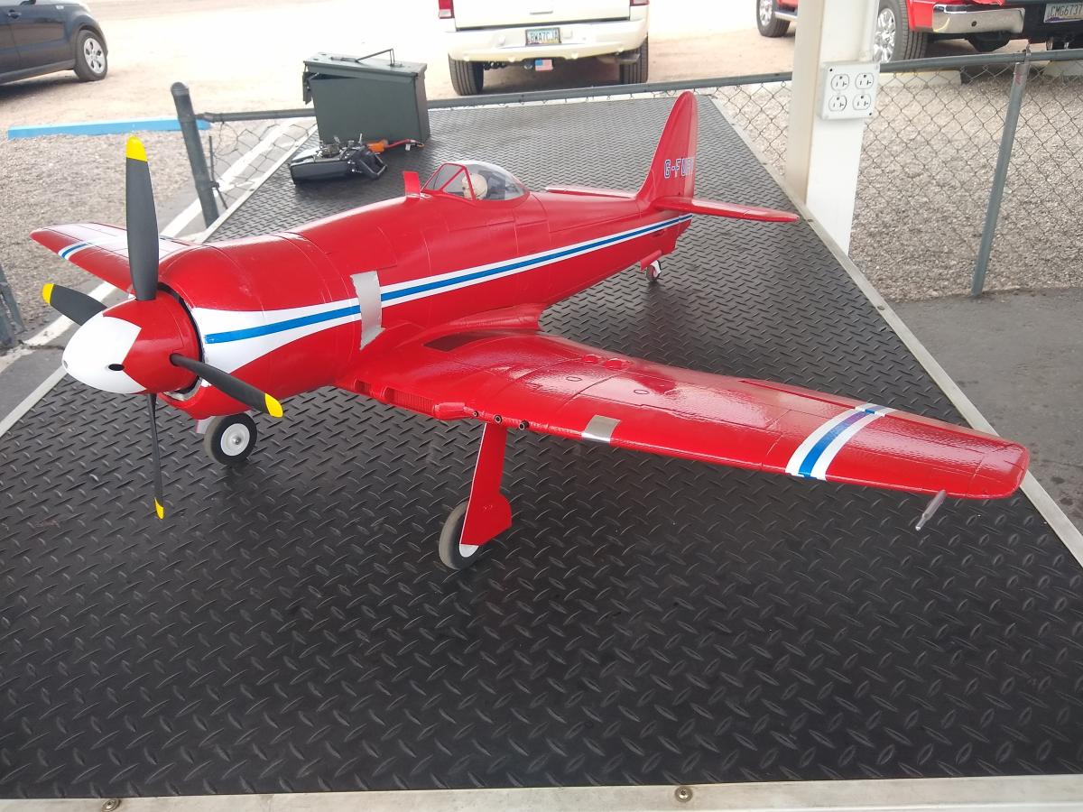

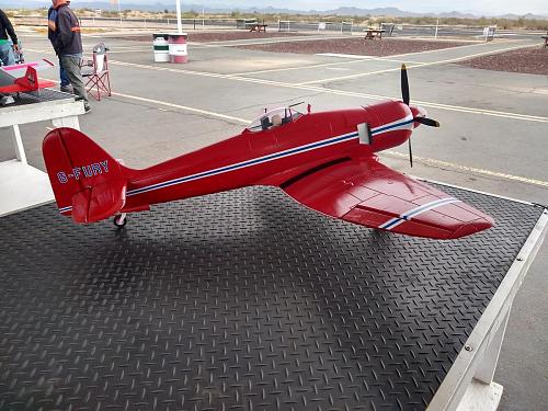

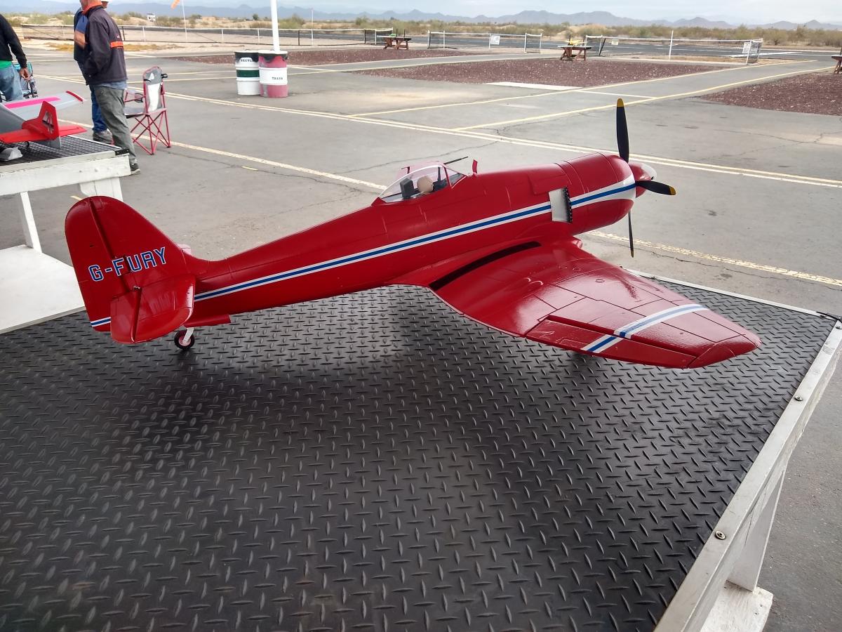

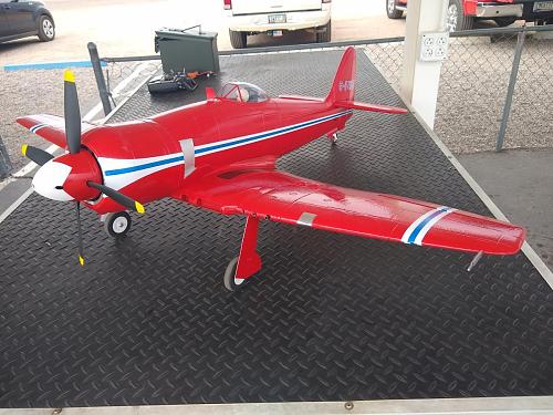

                              #114
ID:	331890Click image for larger version
                              Brought my sea fire to the club field for the maiden today here in Wittman AZ. Flew great with just two clicks of up trim to the elevator and I got four good flights. I get this color scheme off the internet and like it because it was different. Callie did the graphics.
