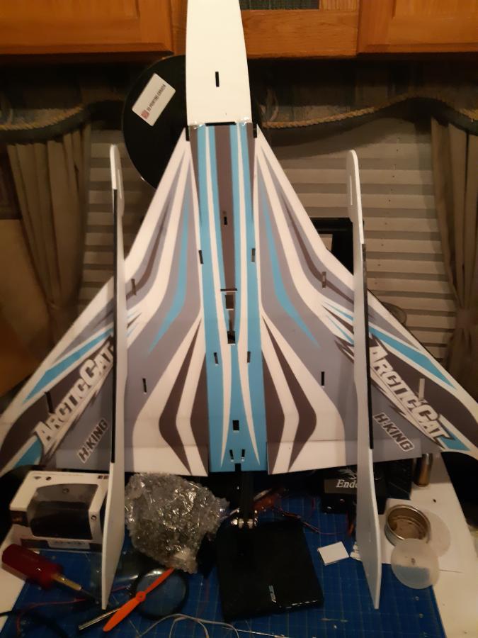

    Going to add lots of polycyclic to this seaplane. It's all foam board and cookie cut.

          Sorry for typo. It's for water proofing the joints. But what a struggle getting things lined up and glued together. Try again another day. The B24 bomber came in the mail today. Should keep me busy for awhile.

            7 of us had this plane at our old field. We never flew them off water. Those of us who built it according to the instructions, used a single servo for the ailerons and the hole in the fuse where the wire came out will be difficult to seal thoroughly. Aside from that, the exposed servos will have to be sprayed with that waterproofing product. As for the rest of the plane, it's an odd kind of "foamboard", which doesn't really have a paper backing that peels. We flew ours in winter and sometimes, the plane came back very wet from all the slush it skidded through. The foam didn't suffer in any way.

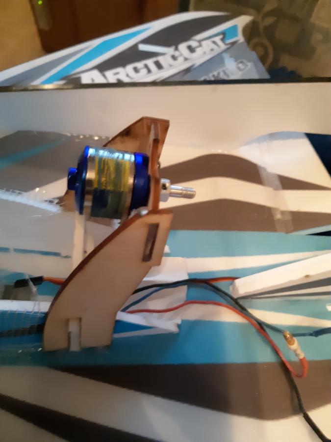

                  Switching the motor out to an inrunner. Eflight 3500. Should have lots of power.
                    Are you going to run it on 4s? I don’t understand the Eflite designation. Does 3500 refer to “KV”? Of all the Cats at our old field, mine was the only one running on 4S. All the others were running on 3s with the HobbyKing 2200kv motor (we called it the “copper top” motor because it looked a bit like the battery). My 4s was quite a bit faster but we all had fun in the “group flies”.

                      Yes running Turniigy 4s 3200 pack. I smoked a 2700 KV motor out twice with a 2200 pack on a 30 amp esc. . The 2200 pack is my favourite batttery And it still works lol. Wondering why it's smoking? I Just keep it around. I have to upgrade the esc next. The 30 amp won't cut this motor. Wish I had some 60 ,70 amp esc around.Something with a battery elimination circuit.

                                    Yes. Drop and full throttle. Usually it takes 20 feet and it's in the air. I have a 9 gram servo on each aileron. One on the elevator. I have it programmed in my Tx to %100 rates and no expo. I find I needed to add fiberglass tape and brushed on polycrylic to the ailerons. That prevents the foam board from flattening out on hard banking. Funny thing is it flys better without a nose cone on, Just a big blunt front end. lol. P.S. I saw the highway sign for Point Roberts on my back from the US. I believe it was the Piece Arch crossing. The boarder security officer seemed envy of me flying my planes their. They never gave me a hard time.
