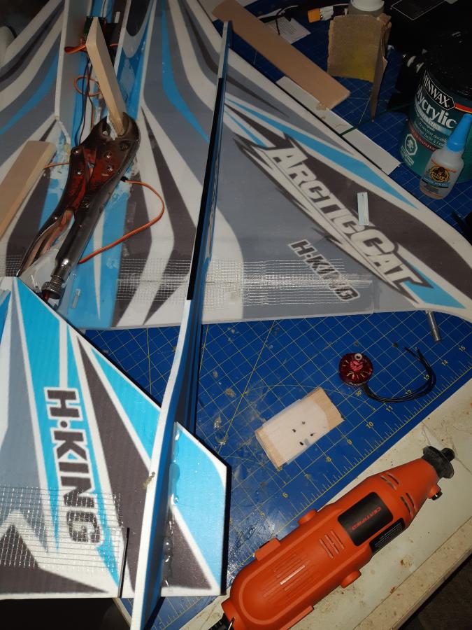

These kits come with rudder. Like the ailerons and elevator, you just have to add a servo. All of our Cats had working rudders even though most of us flew them by "bank and yank". However, as a skidder, a rudder is essential for ground turning. Most of us had the rudder on high rates, no expo so we could crank it around on the ground to drive them back to the pits. In the air, the rudder is very effective, so much so, that it would wag the Cat's tail like a skier going through a slalom course. A couple guys would use it to do "hammer head" turns in the air.
Hobbyking Artic Cat.
Oh cool. I think the rudder got tossed out in the garbage by accident. I can make one simple enough. I'm working on the Vampire tonight. Strengthening the tailbooms and giving it a good once over. Thanks for your input sir, very much obliged.Comment
Interesting that you mentioned this about the rudder. Mine came with 1/2 of the vertical tail missing. It's a double thickness piece and only 1/2 of it was there. I didn't throw it out by mistake since it's supposed to be printed on the outside surface. It was simply missing. I had to make the other 1/2 of the sandwich out of some spare foamboard I had laying around. That's the part that had the cut out for the rudder servo. The actual rudder is also a double thickness piece that you glue together and then cut a bevel on the end that mates up with the vertical fin so that it can move side to side.
