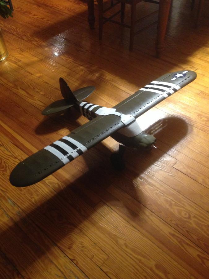

                  One thing to tell you to do if important. I found out the hard way. Remember that battery door underneath the plane? I was flying in front of my brothers and stunting the plane. I was going into a right turn when I noticed something fell out of the plane that was blue. The battery dropped out of the plane and she flew in a circle into the ground. I took the "walk of shame" to see what happened. When I turned over the plane the battery door was open, battery was gone and the strap had broken. Partly, because I pull the strap tight when I put the battery in so it doesn't slip around. The fix, repair damages, find wire bundle strap (exact fit) with velcro from Lowes in a roll, put velcro on batteries and matching in plane. Now the strap is the safety to the velcro. Accident one now; I left the plane in the sun one day before flying (maybe a problem or not), took it up and was flying the cub upside down and looping it. Suddenly, it went out of control. Took the "walk of shame" to find out the tape for the hinges on the ailerons pulled the paint off the plane and was dangling from the control rods. I replaced the hinges with those at the hobby shop. While I as at it, fixed the fuselage and painted it.Click image for larger version
ID:	232659 When the ailerons came off, the fuselage was broken in two places. I flew it again two weeks ago and it still flies great.
