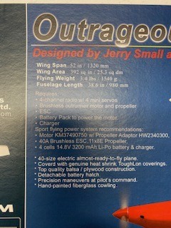

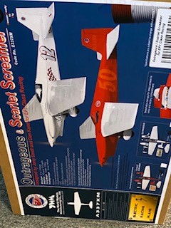

    Hey all, I was hoping to get some advise on a good motor for a plane I just purchased. The plane is a World Models Outragous EF1 Racer . the recommended power is a KM37490750 - 37-49 750kv out runner ( specs- operating power 900W, operating voltage 3s-5s , operating current 30-45 amp,Peak current 65 Amp (Max 15 seconds)internal resistance 24 m ohms, diameter 37.2 Length 48.5 ,weight 190 grams, shaft diameter 5mm. ) with 40 Amp brushless esc and 11x8 E prop. the problem is this motor is out of stock and no telling if it will be back, so that being said what motor recommendations do you guys have for me as I want the plane to preform well and be FAST :) there just docent seem to be other 37-49 750 kv options out there. I really appreciate any help.. Happy flying !

      This is from the World Models webpage: https://www.theworldmodels.com/store...1-Class-Racing
      Recommended Motors for NMPRA EF1 Racing
      Arrowind Electric Motor EF-1 Racing, 1300Kv (NMPRA EF1 Legal)
      E-flite Power 25 BL Outrunner Motor, 1250Kv (NMPRA EF1 Legal)
      O.S. .25 Brushless Motor 3820-1200W (NMPRA EF1 Legal) - Tech Specs - Dimensions
      Recommended Motors for everyday flying
      Arrowind Electric Motor 2820/07, 920Kv
      E-flite Power 25 BL Outrunner Motor, 870Kv
      O.S. .25 Brushless Motor 3820-960 - Tech Specs - Dimensions
      • #4
        I appreciate the help guys, I was considering the E flight power 25 seeing how they put it in the shoestring which is essentially the same thing. I was worried if it would fit..
