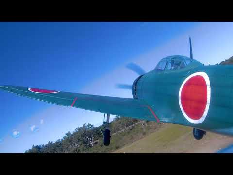

                    We had a Warbirds fly-in. Took the Zero along, it was well received. I'm really liking it, have done a lot more "playing" with its flight envelope and it hasn't bitten.
                    Another video.
                      #110
                      Enjoyed the video. Especially like the view from the tail.
