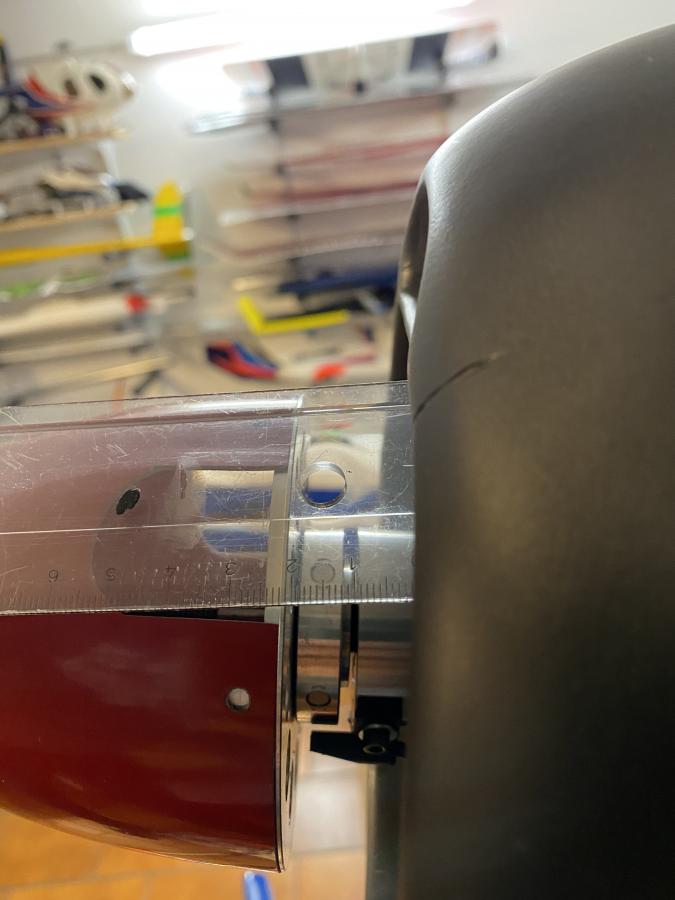

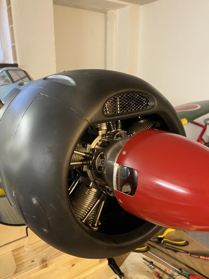

                        Just bought the BH Zero ... first huge and first gas project. I’m looking to put in the Saito 5 cyl/75 .. reason I bought the plane. I have heard that this set up has been done, but that the prop/spindle stick pretty far out. Does anyone know of this has been overcome? Can it be? .. otherwise, I’m looking at the Saito 90.
                        Any help greatly appreciated))

                            The Saito FG73 R5 fits great with a ring-muffer and has enough power for the Zero.
                            Spinner an prob are a minimum to long but you can use this part to mount the Saito:
                            Viele Grüße
                            Dennis

                                  Sorry i don‘t know. The Saito FG 73R5 fits in strong but there is 1cm free space around.
                                  Perhaps you must make litte adjustments to the firewall.

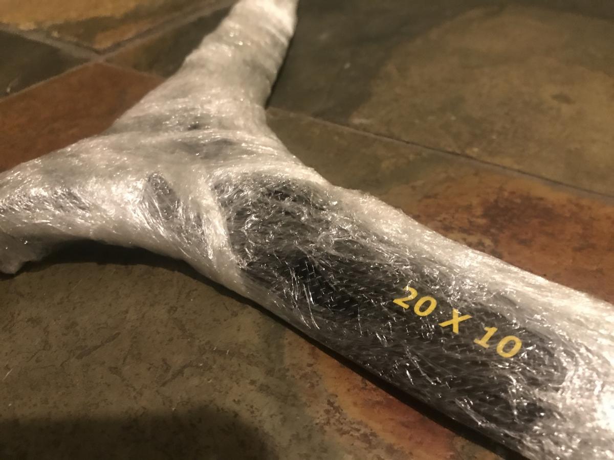

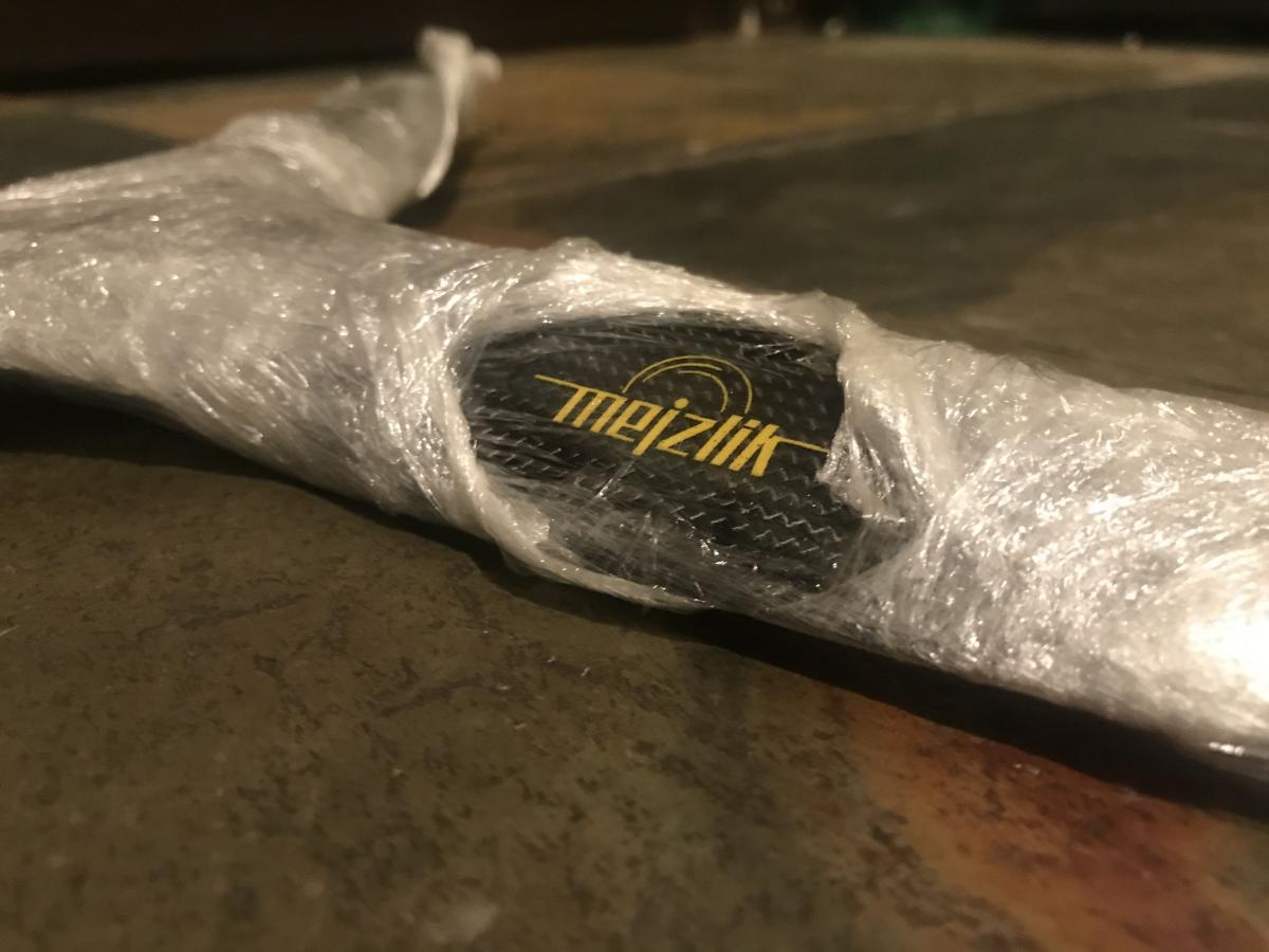

                                        On mine , top flight , which i belive to be 2” short on gas engine i got this ...
                                        i’m new on balsa so please double ceck with a season balsa pilot for confermation.
                                        here the size and brand .
                                        hope to be helpful.
