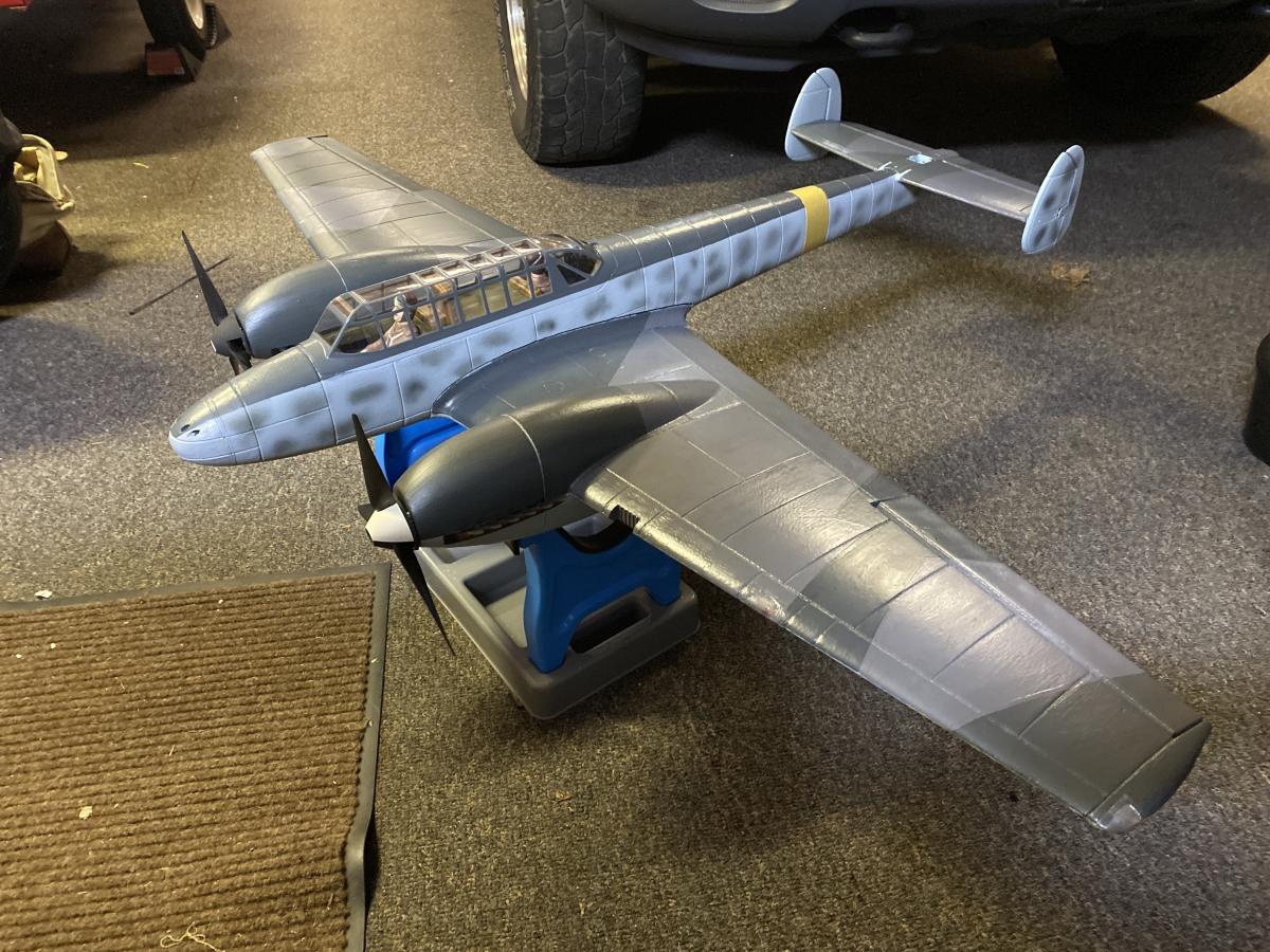

I did a retract replacement on my old Dynam Grand Cruiser some years ago. I believe the retracts on these twin engine planes (and even their single engine ones) are all the same retract base. Nevertheless, I had some retracts from a dead HobbyKing plane laying around. I can't remember exactly which plane it was, but they fit perfectly into the GC. If you look at the HobbyKing site under retracts, you may find a set that will work for you. Dynam and this particular HobbyKing retract had the mounting plate that was a separate piece, held on with 4 tiny screws. Look at the pictures carefully and measure the distance for the main mounting holes so you can do a proper assessment. These are some of the smallest and cheapest retracts in the business. -
Try motion rc I bet those struts will fit in the yak units or you can modify a little I’d change out the esc if I were you as well dynamos pretty badComment
