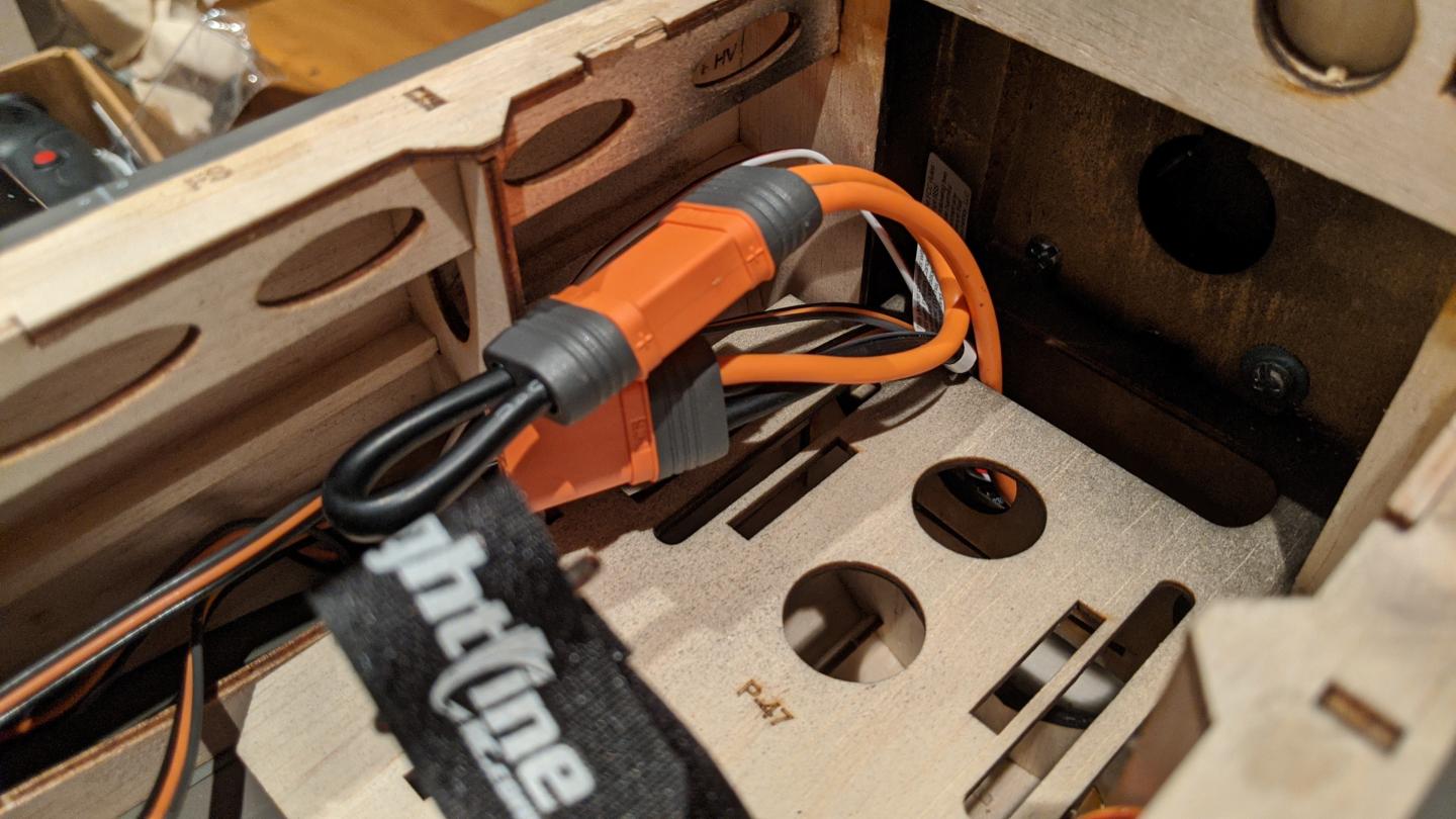

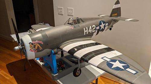

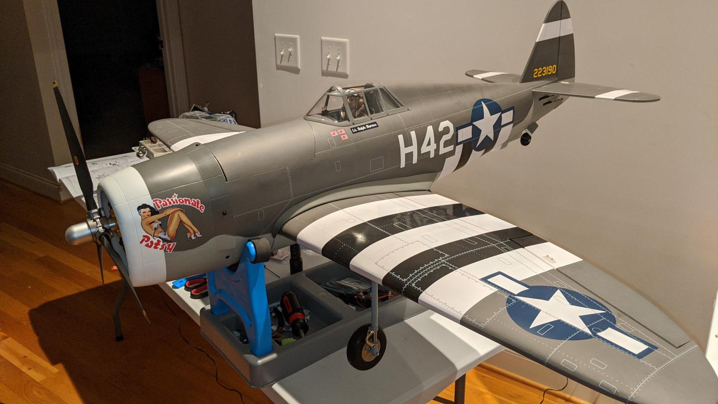

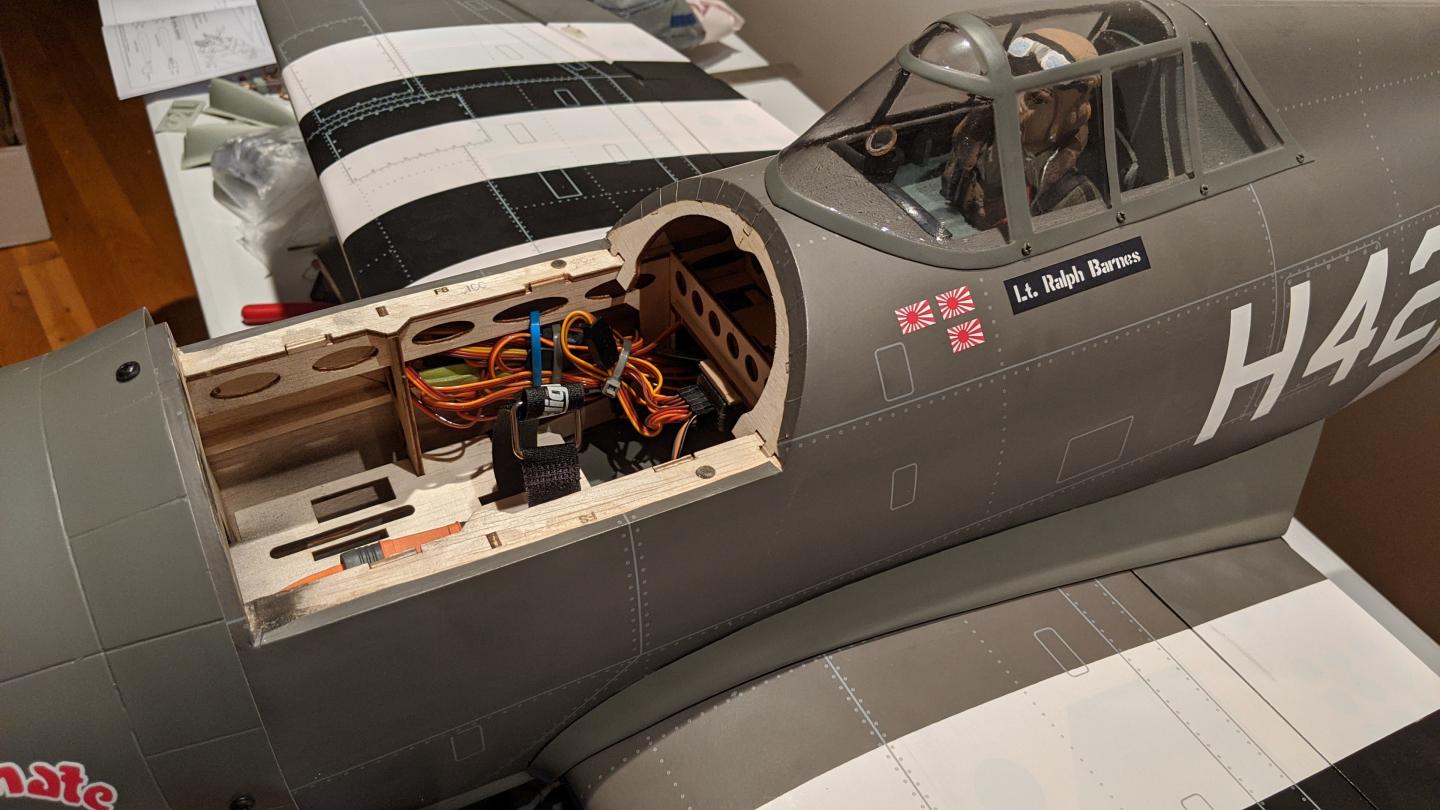

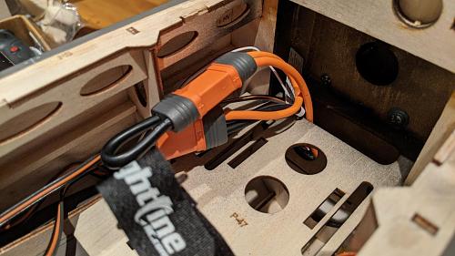

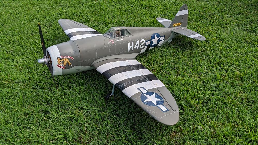

                    Finished my assembly of Nexa P-47. Overall it was easy assembly with just one hiccup. The wing attach nylon bolts are not long enough. Went down to the local hardware and got a couple so no big deal but Motion might want to look in to this. I went with the Flightline 1600mm Corsair motor and 18" three blade prop combo. Running an Avian 80 amp ESC and Spektrum AR637T so I can get SMART telemetry during flight.
                    Will report back with flight impressions after the maiden....

                    • Merry Boozer RC
                      Wesley
                      • Jul 2019
                      • 178
                      • Webster FL
                      #30
ID:	263959Click image for larger version
ID:	263960Click image for larger version
ID:	263961Click image for larger version
ID:	263962Click image for larger version
                      Great job on the assembly I was going to use that same power system at first until I lucked out and was able to get the other I’m using now. Definitely going to order extra props if and when they come back in stock. You are going to love the way this one flys she is a beast

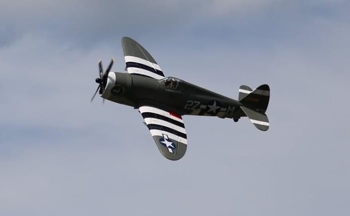

                        #31

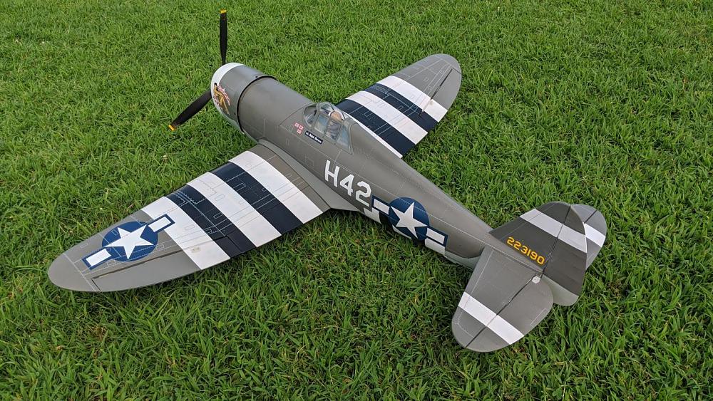

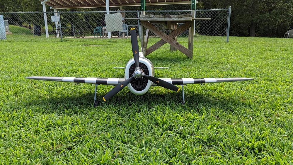

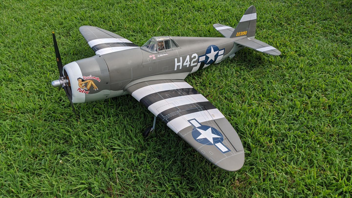

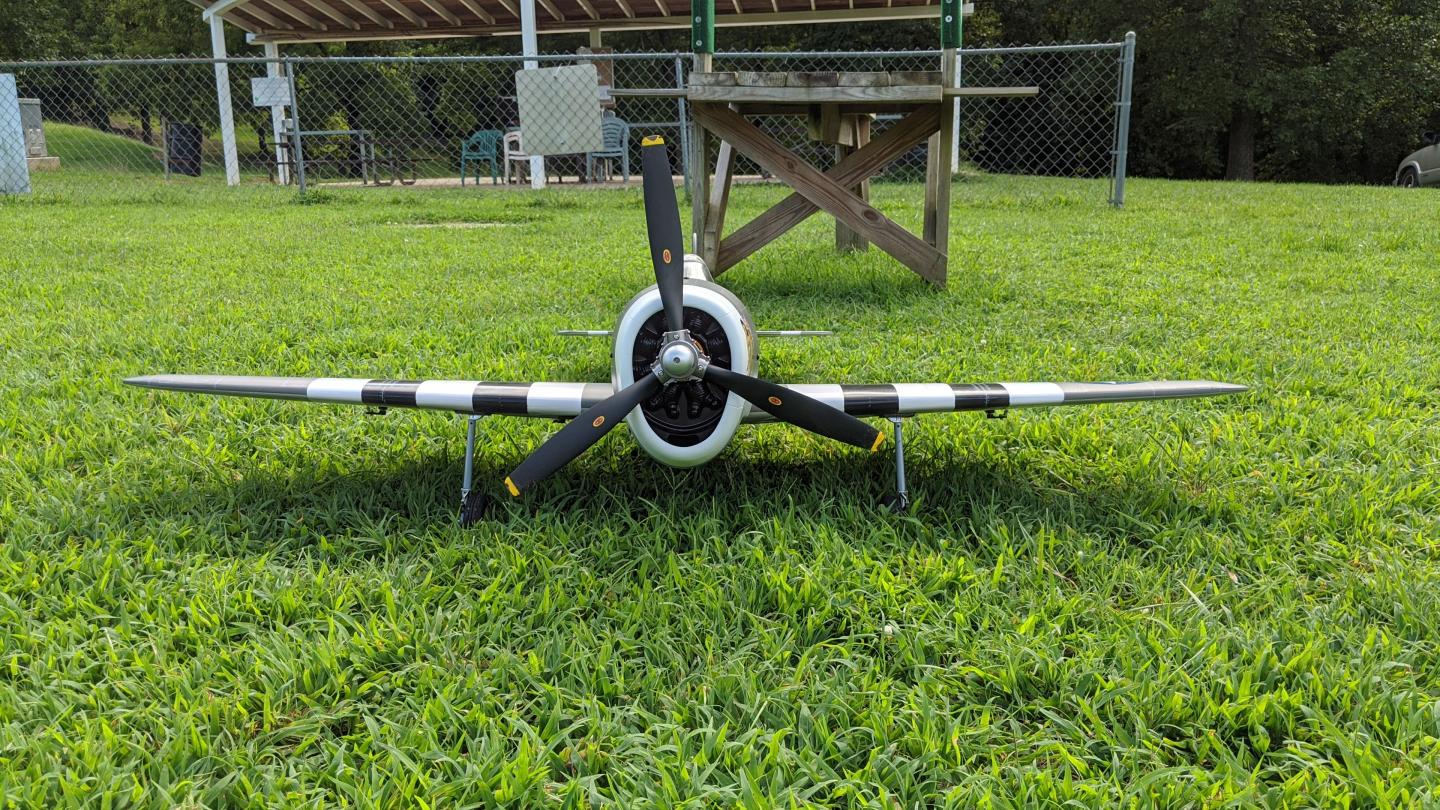

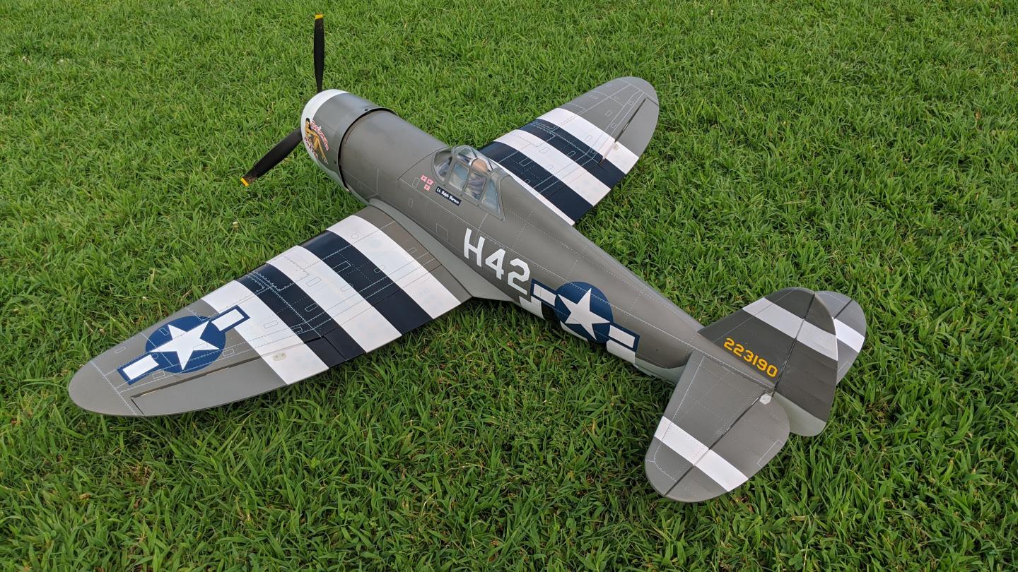

                        Maiden plus five flights today on the Nexa P-47. After a scare on maiden takeoff due to not mechanically trimmed very well on my part, I found this model to be a great flyer and got some attention at the field today. She is rock solid and tracks through the sky like a scale aircraft. Running an AR673T receiver with gyro settings low and its awesome. Slows down nice on approach and is predictable. Once got through maiden jitters, was very enjoyable to fly. Have the FMS Corsair 4 blade 17 inch prop on order as the 18 inch three blade prop chews through the grass when taxiing so in my opinion its too big of diameter for this airframe. Luckily my field has an asphalt runway so no issues with prop clearance there. But I will say this power system is killer on the P-47......
                        Click image for larger version  Name:	IMG_20200816_165407.jpg Views:	0 Size:	317.3 KB ID:	269078Click image for larger version  Name:	IMG_20200816_165330.jpg Views:	0 Size:	325.9 KB ID:	269079Click image for larger version  Name:	IMG_20200816_165350.jpg Views:	0 Size:	341.6 KB ID:	269080
                        • Merry Boozer RC
                          Wesley
                          • Jul 2019
                          • 178
                          • Webster FL
                          #32
                          what a great looking build great job on this one its my absolute favored to fly currently.

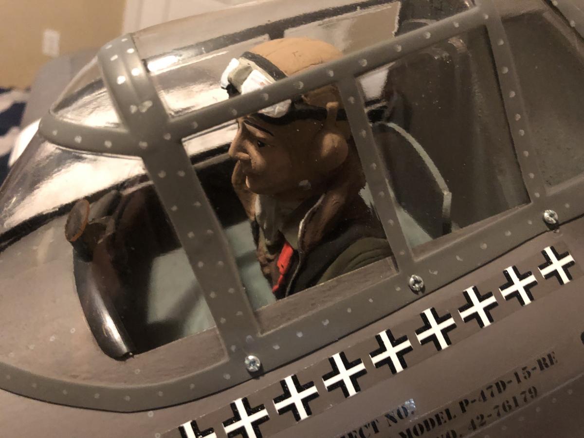

                              Guys, is the pilot figure a full body or partial?
                              I’m thinking about using in one of my warbirds. A picture would be appreciated. Thanks.
                              • Merry Boozer RC
                                Wesley
                                • Jul 2019
                                • 178
                                • Webster FL
                                #35
                                Here you go 😉
