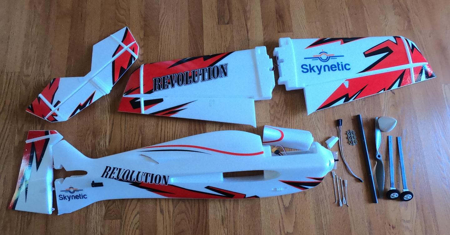

              Just received my skynetics revolution. Well packaged. No instruction manual or pointer to online instructions. Thanks to this forum I did locate online instructions. They weren't very good. Wings not tight to fusalage, lots of wiggle. Very small battery/esc bay had to be enlarged to accomodate receiver. Four ozs of lead needed to achieve recommended cg! Next I'll see how it flies.
              • Kenlin
                • Jul 2020
                • 2
                Maiden flight needed lots of trim. Good landing but left landig gear carbon fiber leg broke. So much for Skynetics. You get what you pay for. Motion RC can do better.
