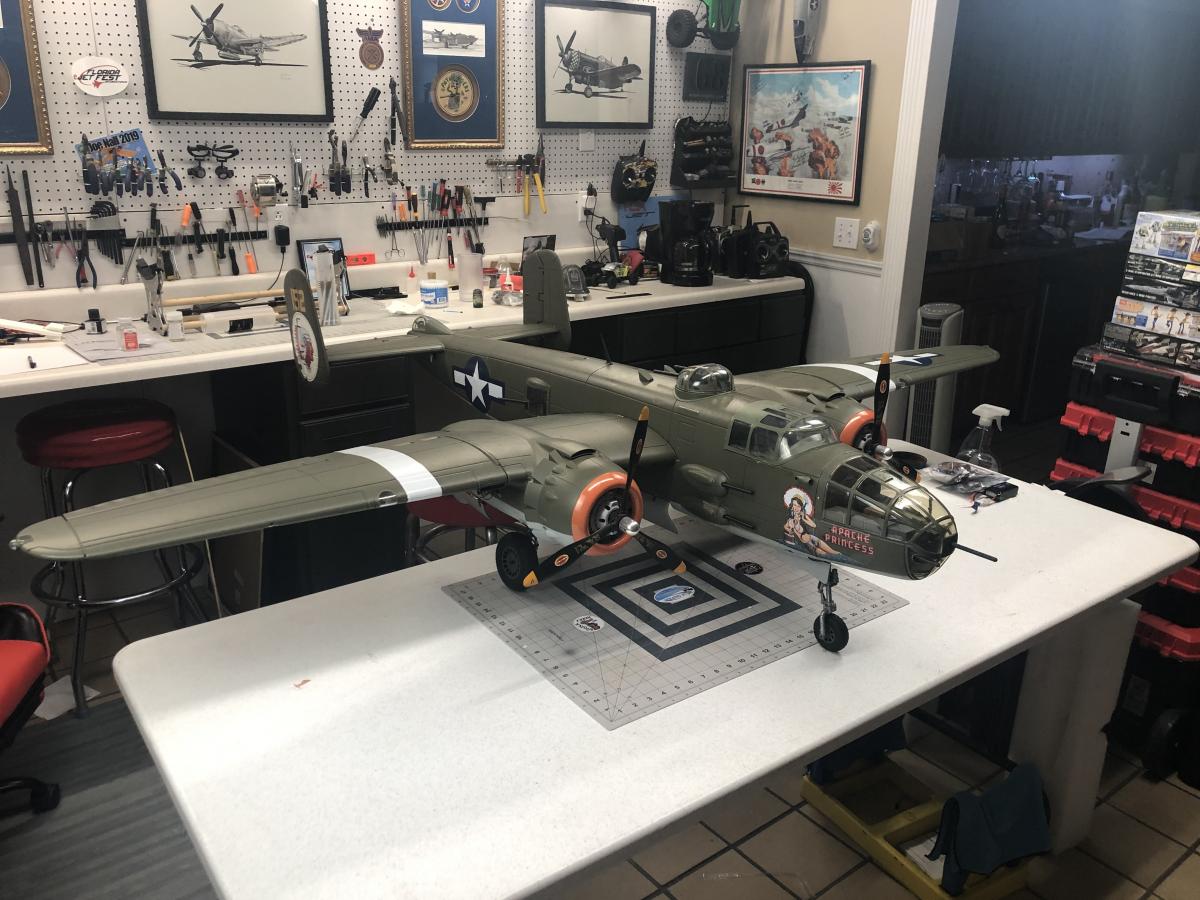

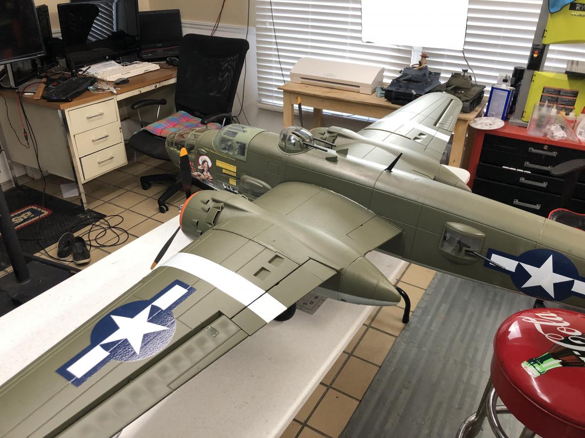

Ok let’s start this off by me saying normal LX models are a no fly zone for the Merry Boozer but papa boozer has wanted a big B-25 for as long as I can remember. I recently was offered this plane basically brand new for half off and I couldn’t resist it. First impressions this thing is dripping in scale details and it’s definitely the best B-25 I’ve ever seen in person. Our friend Rich Baker also has this model and with.... a lot of modifications this is a fantastic model. First thing we will do is go through all the electronics in this bird take the 5 amp BEC and throw it in the trash and add a dedicated on board batterie. Unfortunately the lights weren’t installed by the previous owner I might tackle adding them in. We will also be changing the props to the FMS tigercat props to try and wake it up a bit. If that’s not enough tiger cat power plants on 6s. Anyway wanted to share this is a fantastic start on a great model but it could use a new updated version Ana’s I feel this plane would truly be worth around $700 new if some of the short comings would be fixed

Papa is really looking forward to this challenge. I have wanted and been asking for a big foamy B-25 of this scale. I am sixty seven years old and cannot wait for a manufacturer to build a better model. So, what I am saying is, " use it, before you loose it." I am not disappointed in this purchase, the plane is overall a great design, I think it is lacking in power, landing gear strength, electronics and minor other details. This is really disappointing because this airplane without cutting corner could have been a great one. Sad, so close but so far away. The Boozers have a few projects in front of this one and Papa is going to travel in the summer, so it will be a little slow coming. But, I will get her done. Can't get any better than this. Got my OV-10 from Motion and now my B-25. There is a Santa Clause! Living the good life guys, hope it comes across on the Boozer channel. Papa

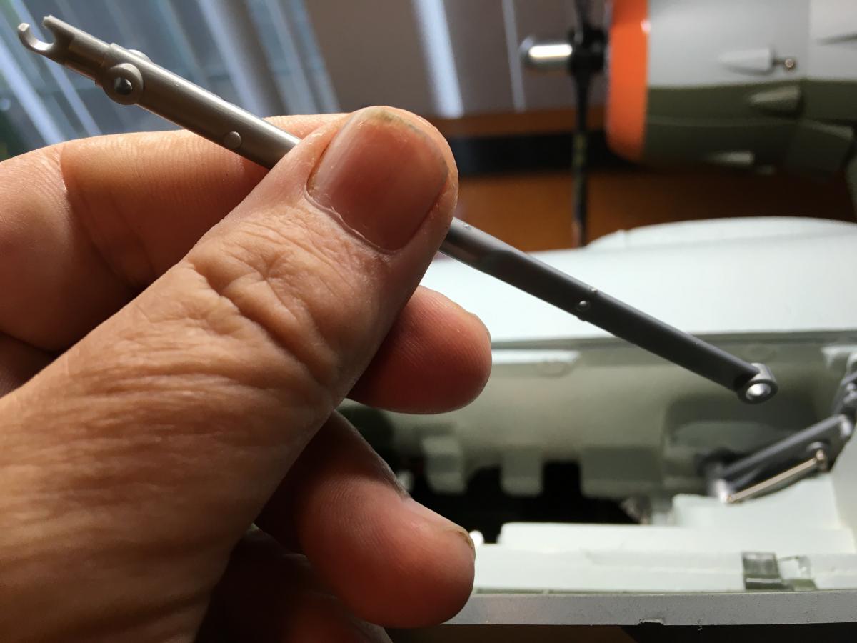

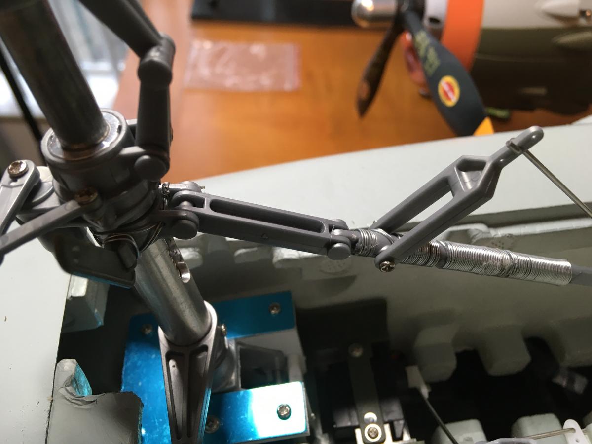

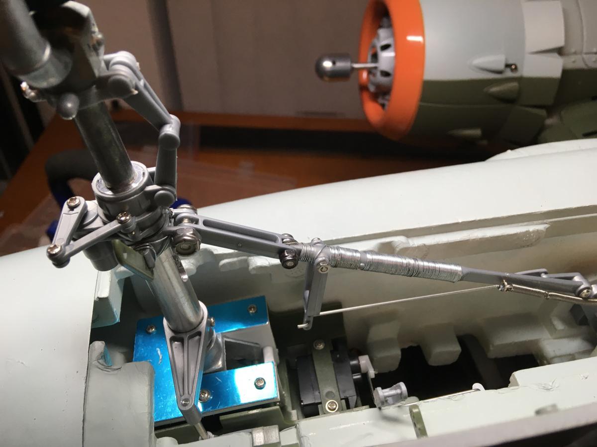

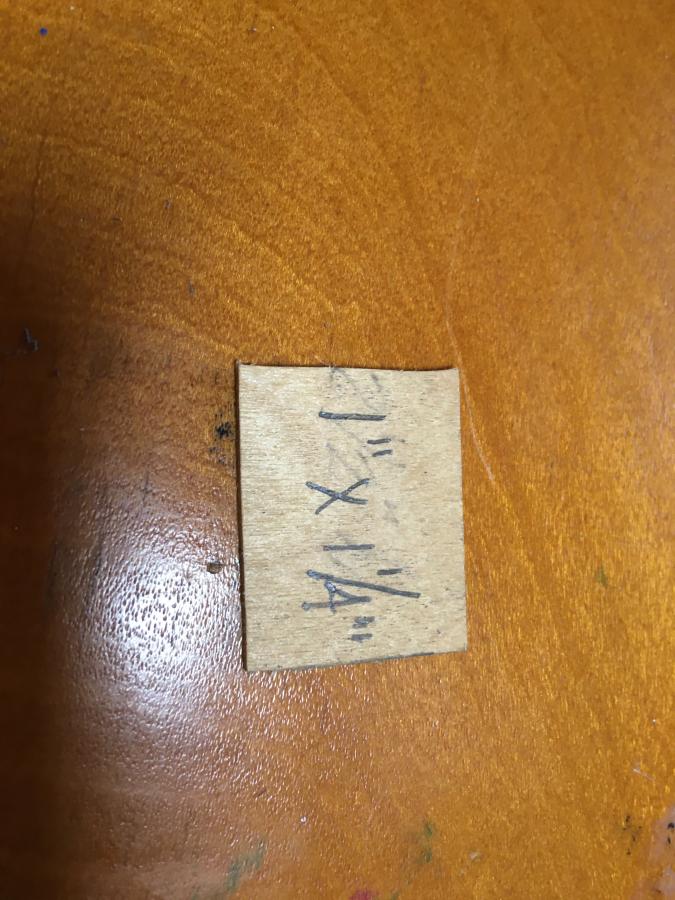

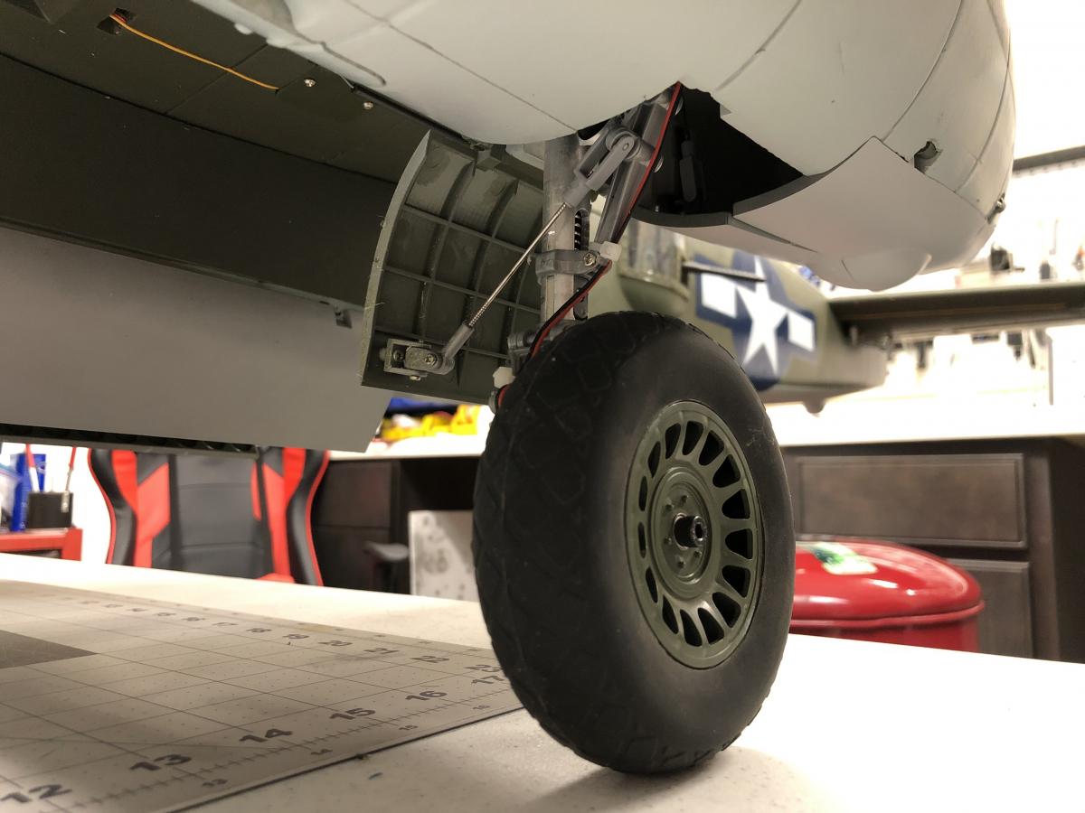

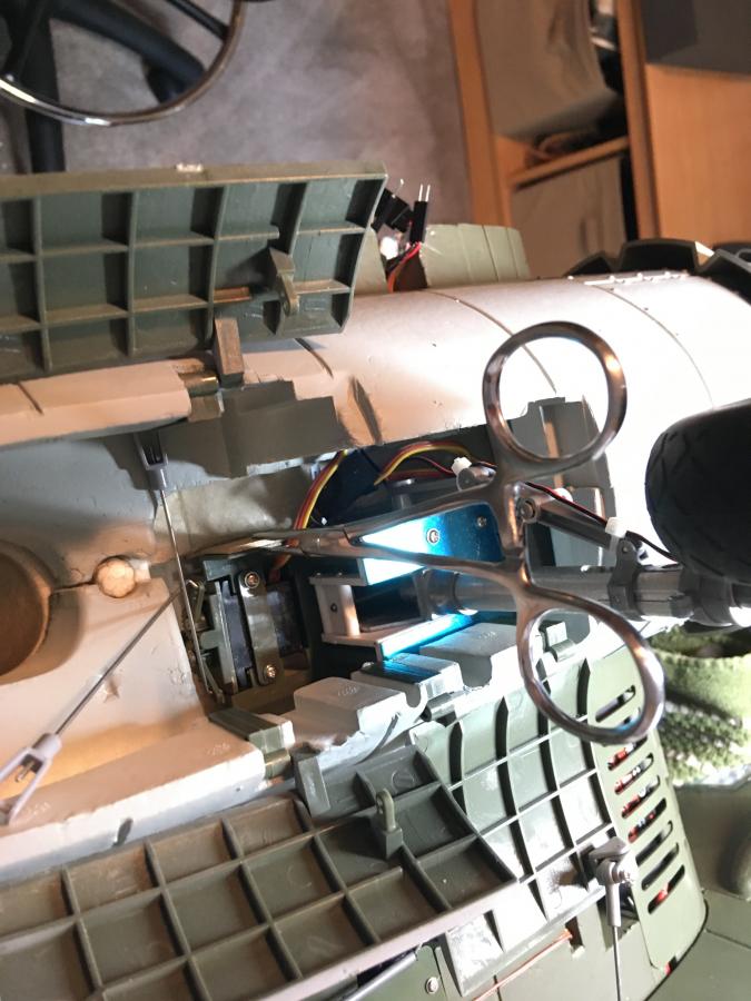

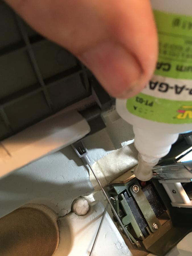

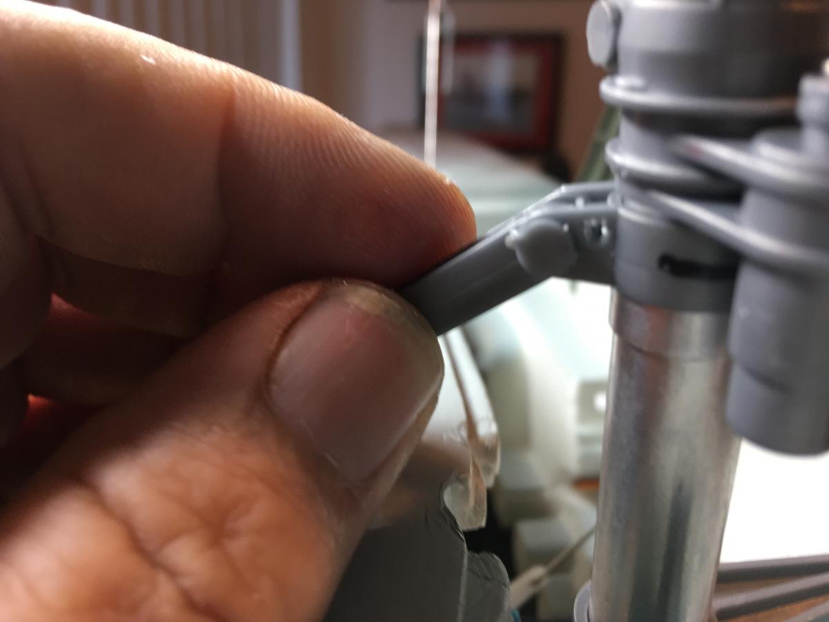

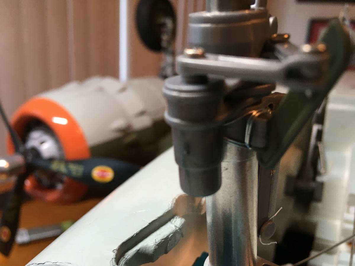

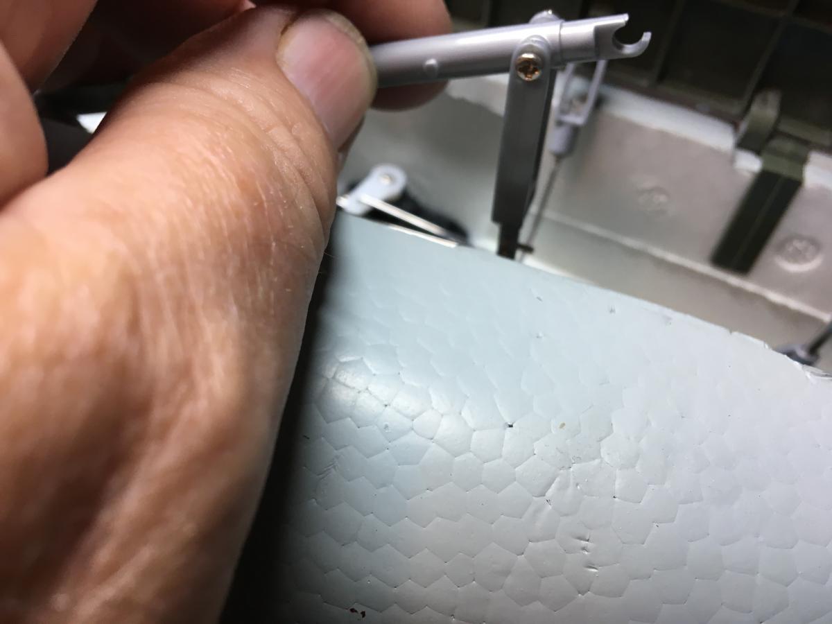

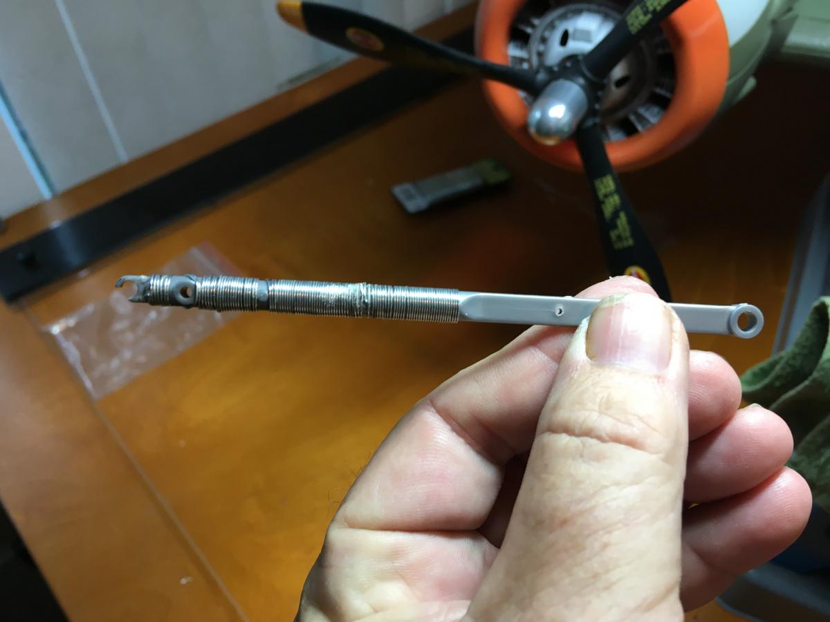

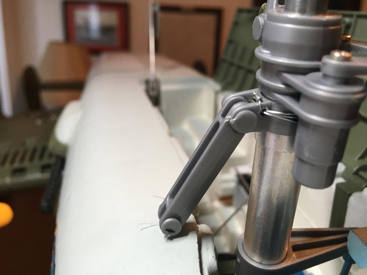

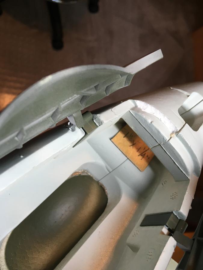

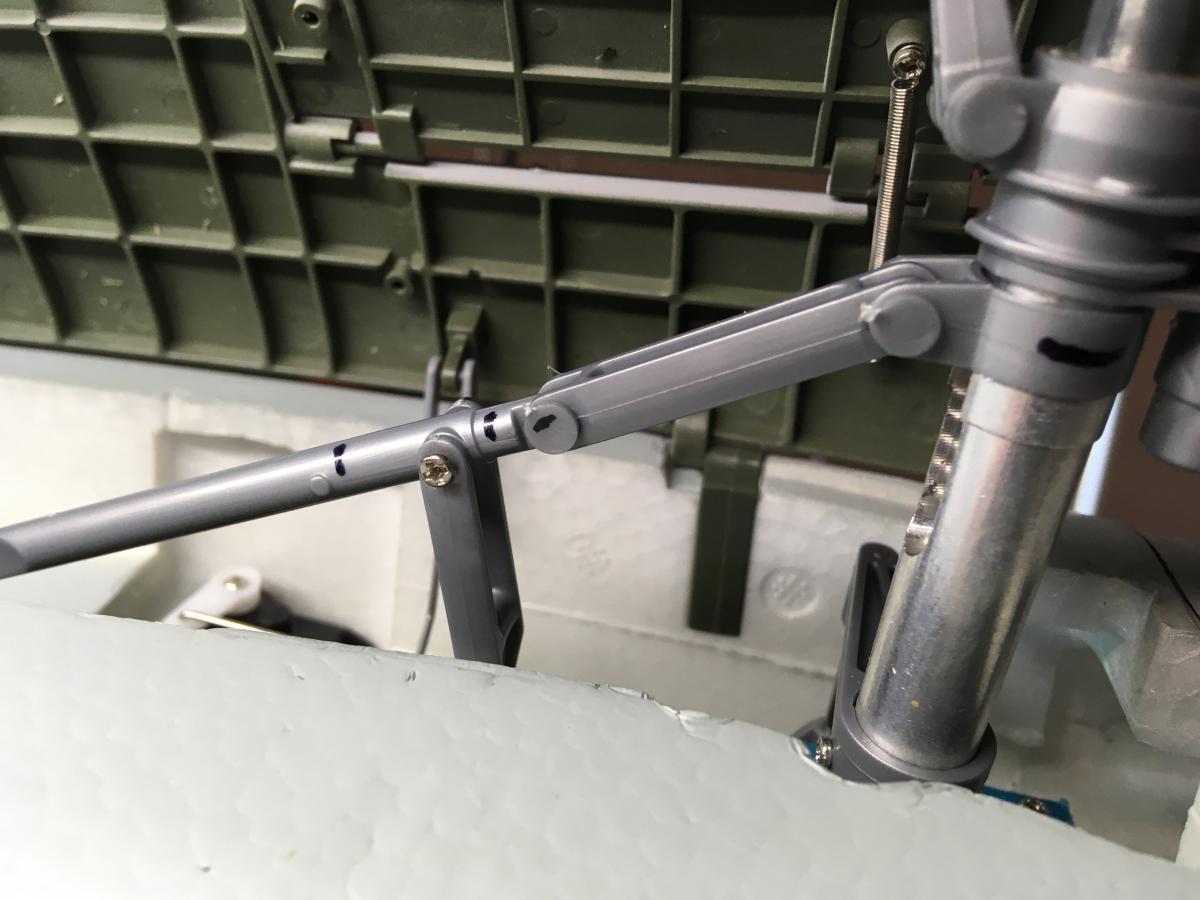

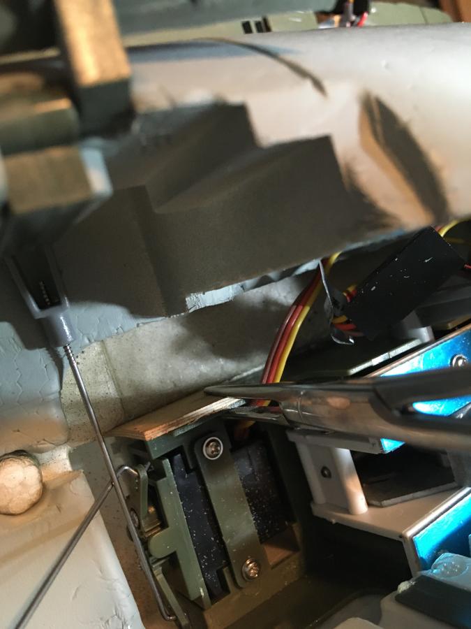

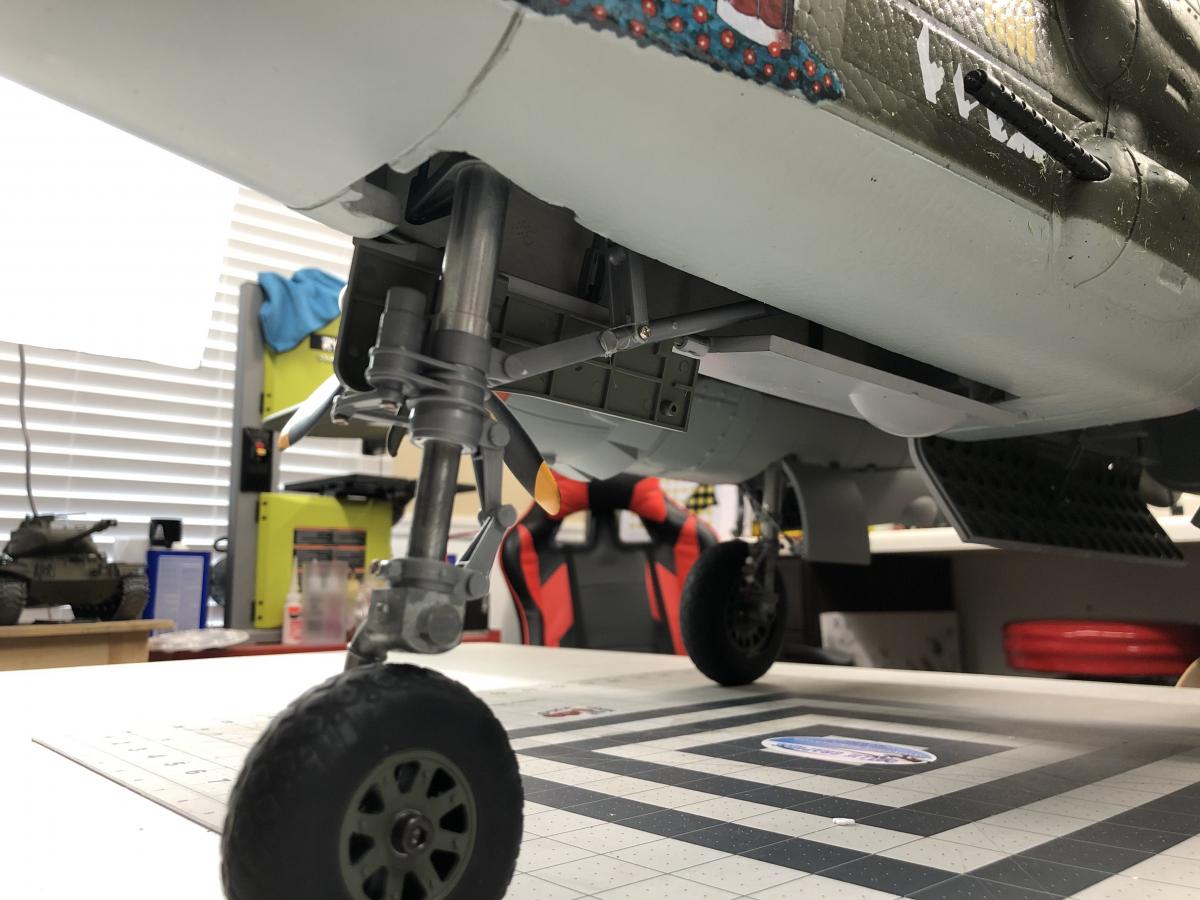

Main and Nose gear repair: This is one of the big problems with this airplane. In looking at my plane, and what I have seen in past experience. Main gear does not like side loading, when this happen, pressure is put between the plastic gear housing and the foam. Foam is forced out and never comes back, leaving a gap and loose gear. Yes, you could dump a lot of glue in gap, but the next repair would be a mess. If the manufacturer would have lined the box with hard ply problem would be solved. I elected to shore up the gap with 1/8" ply and use CA. Nose gear, I disassembled and started on the retract main bar. Did what The RC informer recommended and wrap with wire. moved on to the rotating collar on the shaft. Cut holes and wrap it also with wire. Replaced all plastic pins with bolts. Easier to disassemble if needed. I then placed a spring to asset retraction, as per the RC informer recommendation. Weak points are marked in black for reference. Papa tip: Hit the runway on mains and role strait out. She would have no problem. Good advise, now practice what you preach! Or back to the repair bench.Pictures to follow.
