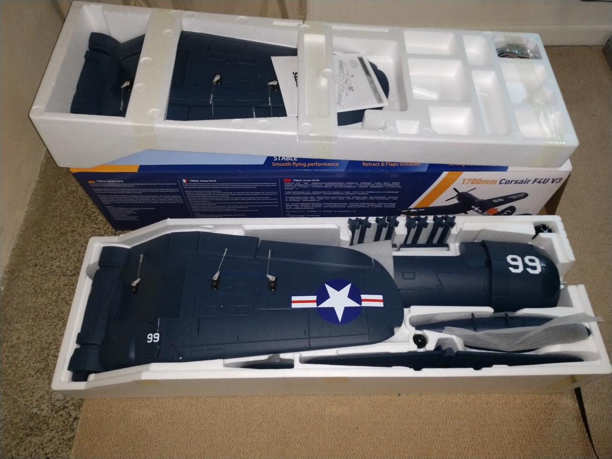

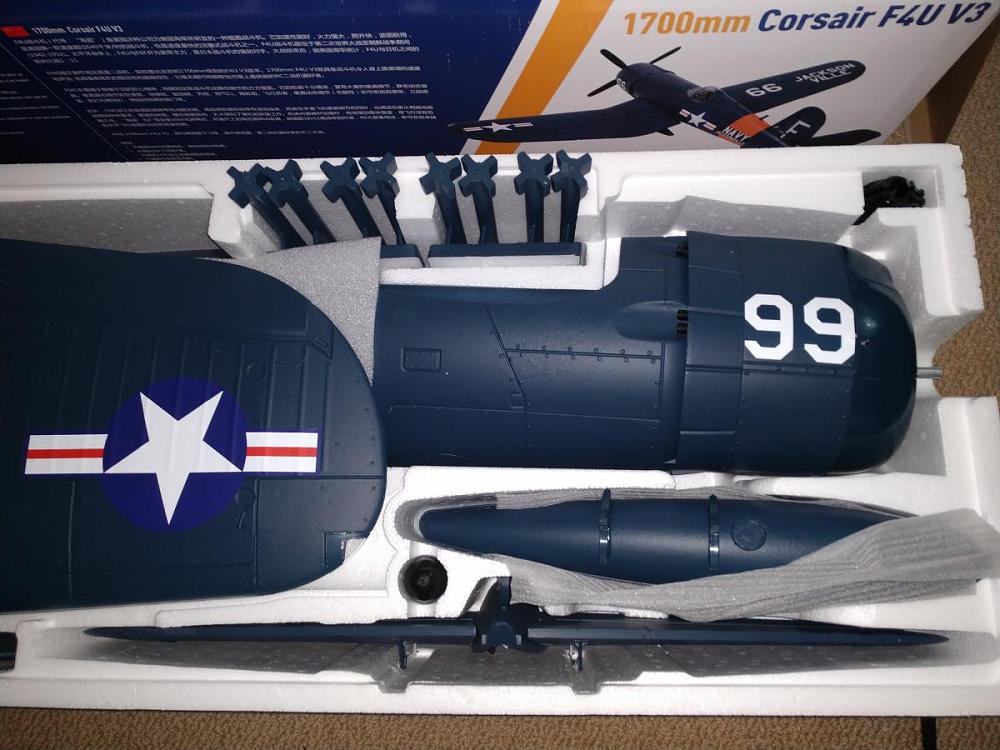

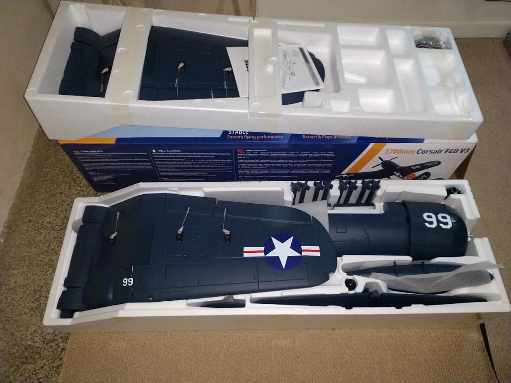

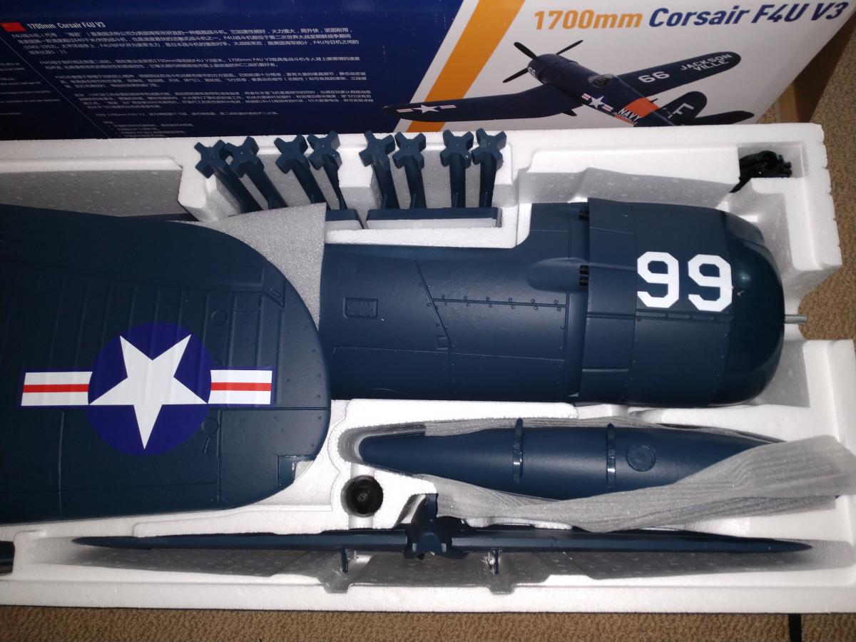

    Starting a new thread for the FMS 1700mm V3 Corsair. I picked mine up today from the local hobby shop. I added about 30 pictures to a new album of the unboxing an individual parts.
ID:	284394Click image for larger version
ID:	284395Click image for larger version
ID:	284396Click image for larger version
    More pictures under my media. I'll continue to update this thread as I start to get things put together.

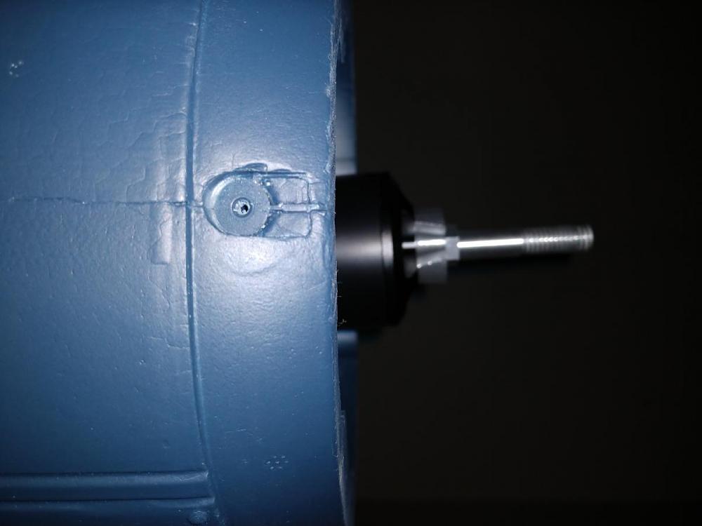

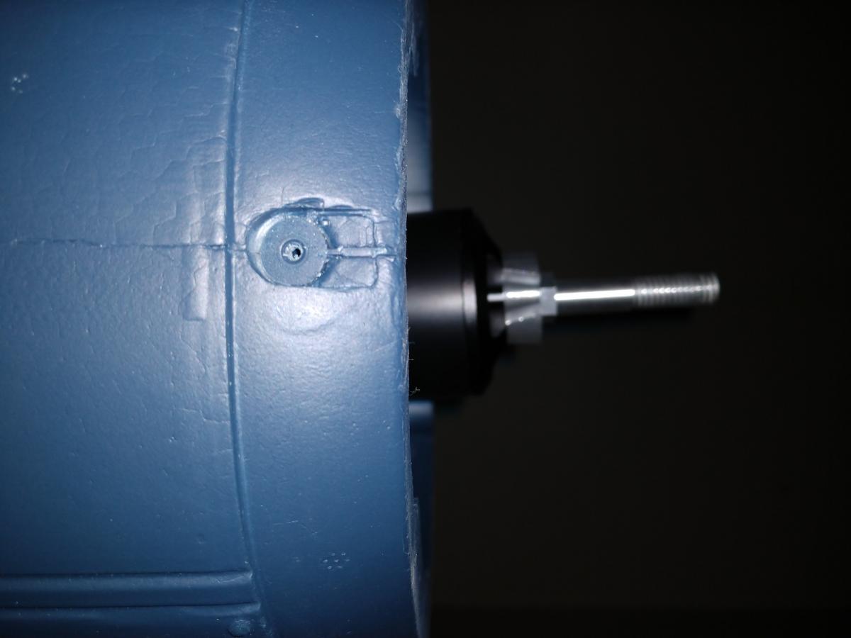

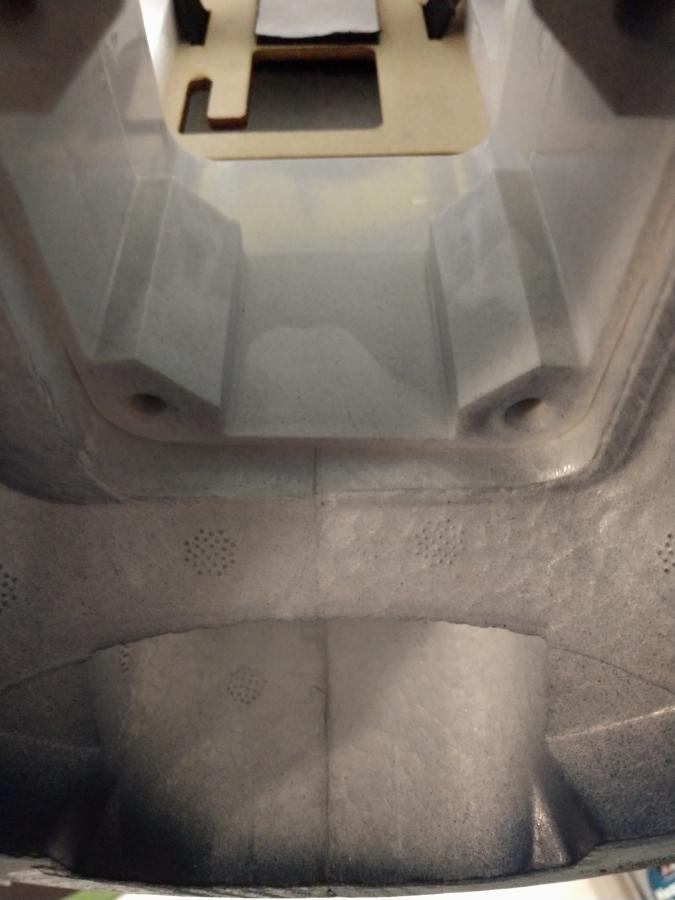

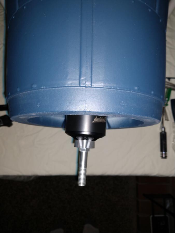

        Ok so ran into my first questionable issue during assembly. While looking at the motor & motor mount I noticed that it seems tilted to one side. I took the cowl off and you can clearly tell the Motor Mount isn't square in the fuselage. Here are a few pictures.

        It's pretty clear there is an offset with how the motor mount is in the fuselage. Is this normal? Does anyone have thoughts on this?

          The motors are aligned with an offset to the right and downward. This is calculated to alleviate the torque factor which wants to make the plane go left due to the forward helix created by the propeller. But as always, one still needs to add right rudder to keep the plane straight down the runway....

            I just got done chatting with Horizon to see what they said. Exact same answer as you AirHead. Appreciate the info. I'll get the ESC & Motor back in it once I put a new connector on the ESC. Baffles me 80amp ESC with a 60amp connector on it. Not that it should be a real issue, but stupid stuff like that drives me crazy! So the XT60 connector is getting swapped out to an EC5.

                      Unlike the full scale plane that you could trim out torque with the rudder and trim tab, the motor is placed that way in leu of it. if you look at the cowling it too has this in it.

                        Normal for planes to have motor offset. It's for torque.
                        A lot of modern planes will actually have the rudder offset very slightly to one side of the fuselage to counter it.

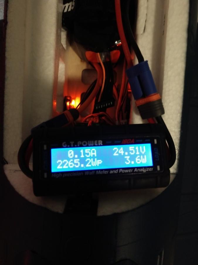

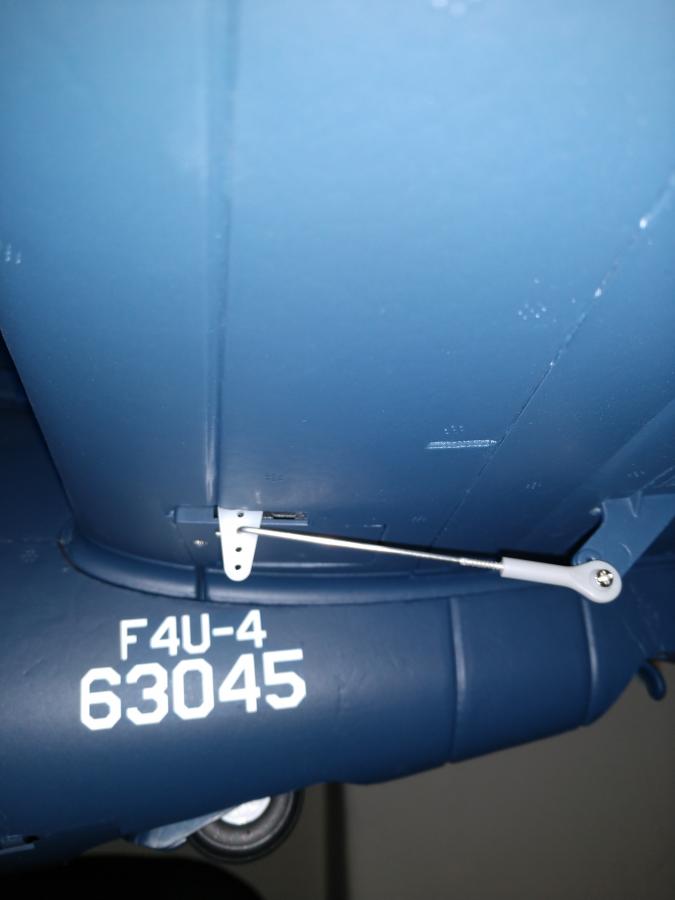

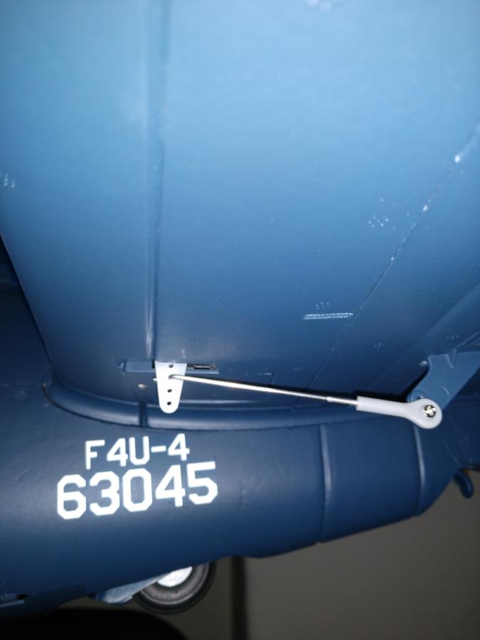

                          Finished the build up early this morning. I had to do a little adjustment for the control rods on the flaps & elevators to get everything at a good neutral position with even throws. So nothing major there. I did move the elevator control rods in on the servo arm same as RCINFORMER had done. This gave just about perfect travel. The rudder is the only thing that seemed to be way out of wack. Stock positioning (how everything was out of the box) gave the Rudder 50mm of travel in both directions. That seems excessive since the manual calls for 24mm "high rates". I setup Mid rates & Low rates that give it closer to what the manual calls for. I left the high rate at the 50mm of travel. We'll see how it does.

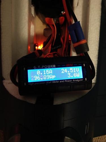

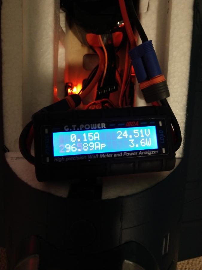

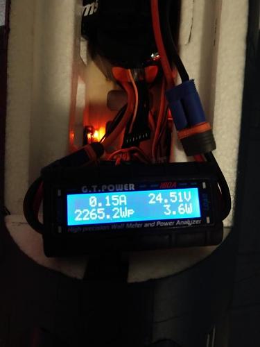

                          I also hooked up the power meter to see what it was doing in 100% stock form. No changes to timing or anything as is out of the box this is what I was seeing.
ID:	284574Click image for larger version
                          96.89Amps & 2265.2 Watts

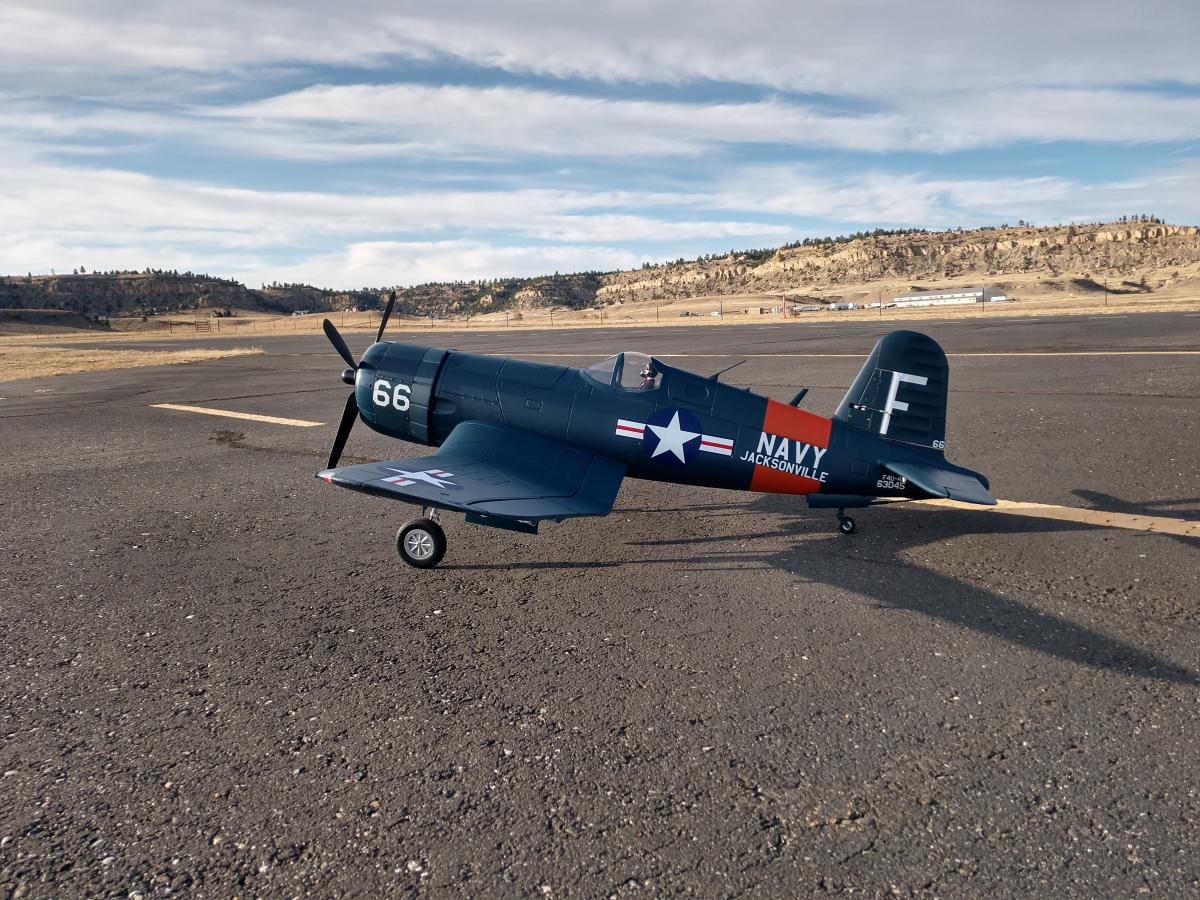

                            Completed the Maiden this afternoon. It went great! I can say that the book low rates are still more throw than needed with the exception of the rudder. You can use all the rudder throw and it feels good. After the maiden i did add 10oz of weight to the cowl just like RCINFORMER. This made it a lot more stable.
                            It does feel extremely scale with the stock setup. I upped the timing to high on the ESC after the maiden flight. That made it a little better, but it lacks power in my opinion (which a lot of people said). It needs a bigger motor or the 8s setup for sure. Here are a few pic's from the runway today.
