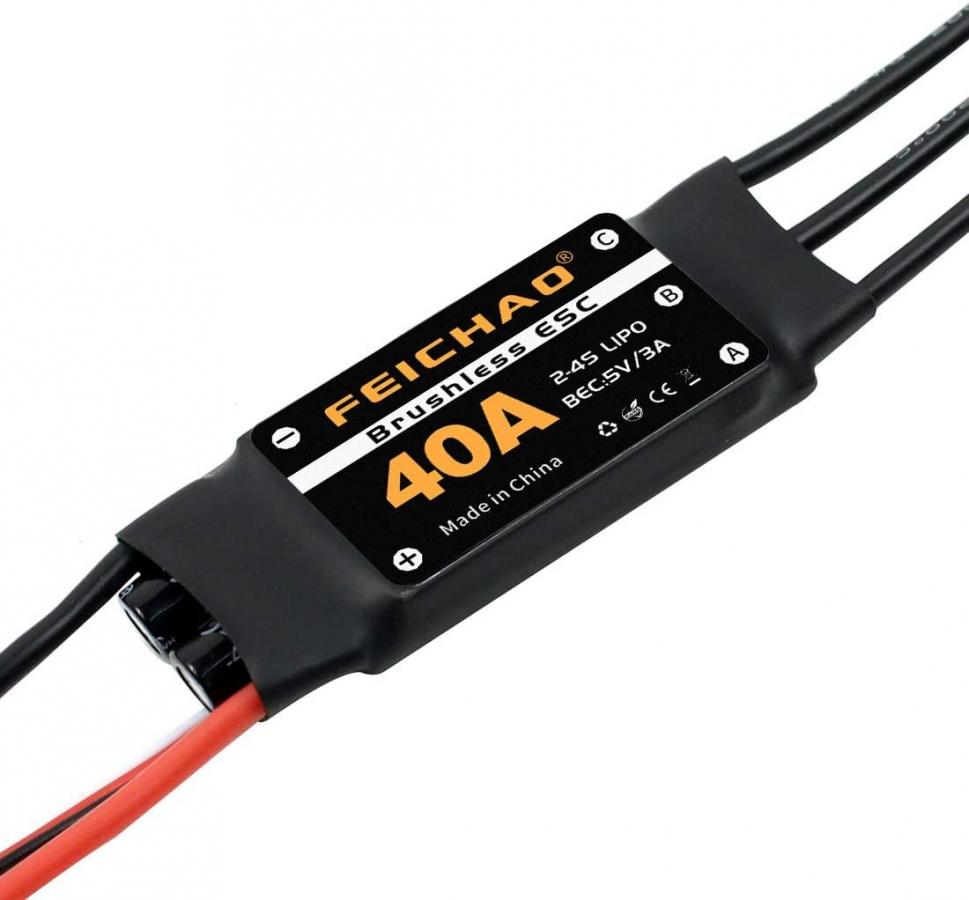

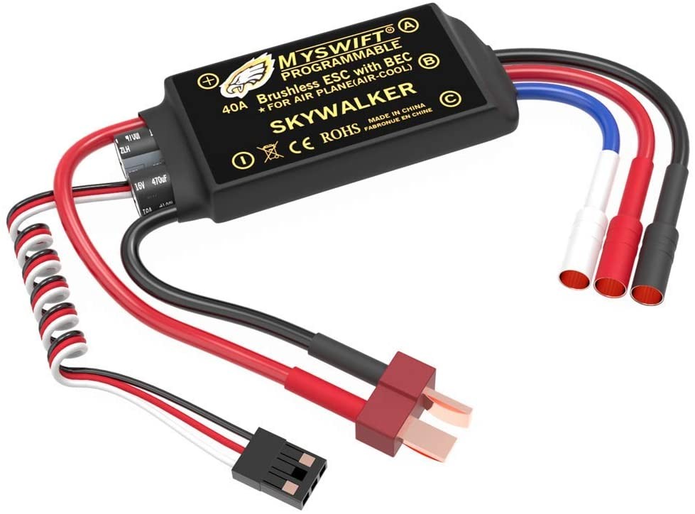

          I went ahead and order 2 ESC with 40 A ratings. Dai
