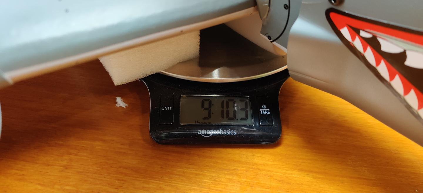

    So with the 6000mAh 6s Admiral Pro 50c LiPo battery, she totals 9lbs 10oz.

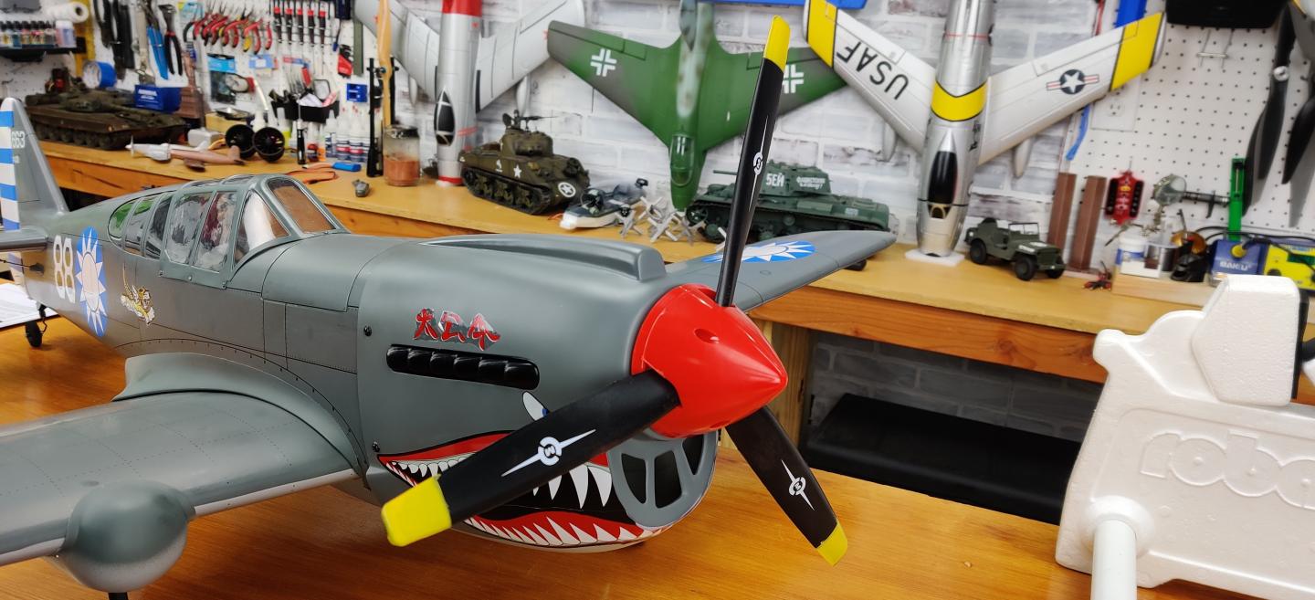

    I didn't realize she came with a 3 blade spinner, so i ended up grabbing a master airscrew 15x7 prop (painted the tips and balanced). Based on the Admiral motor shaft length, with this prop I had to use a spade bit to just take off a bit of the hub width to get the prop nut on with a washer. And the width of each blade was larger than the spinner blade grooves, so had to dremel those open a bit. But all good.

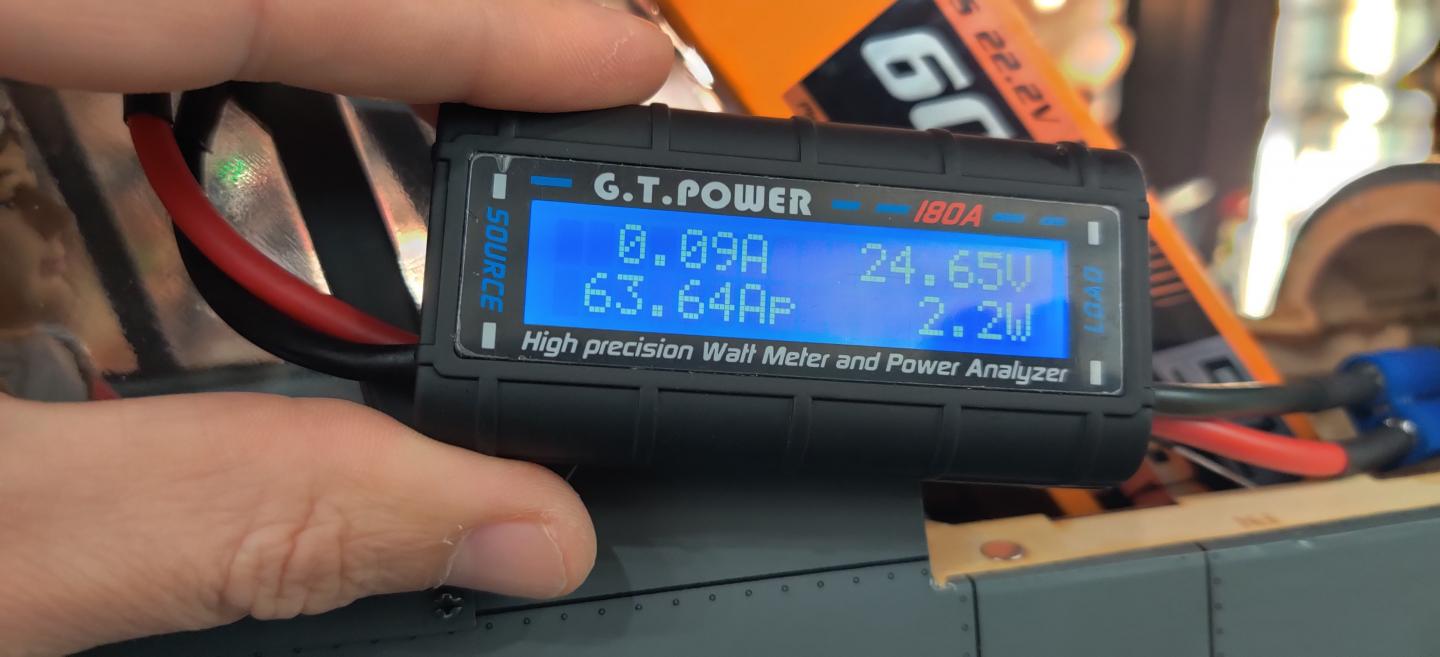

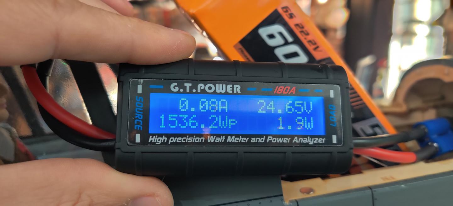

    Putting the Watt meter on it, I am got a max amp draw of 63+ on the table, but it was 55amp steady for 1 minute. So should only decrease in the air. the total watt power was 1536.2

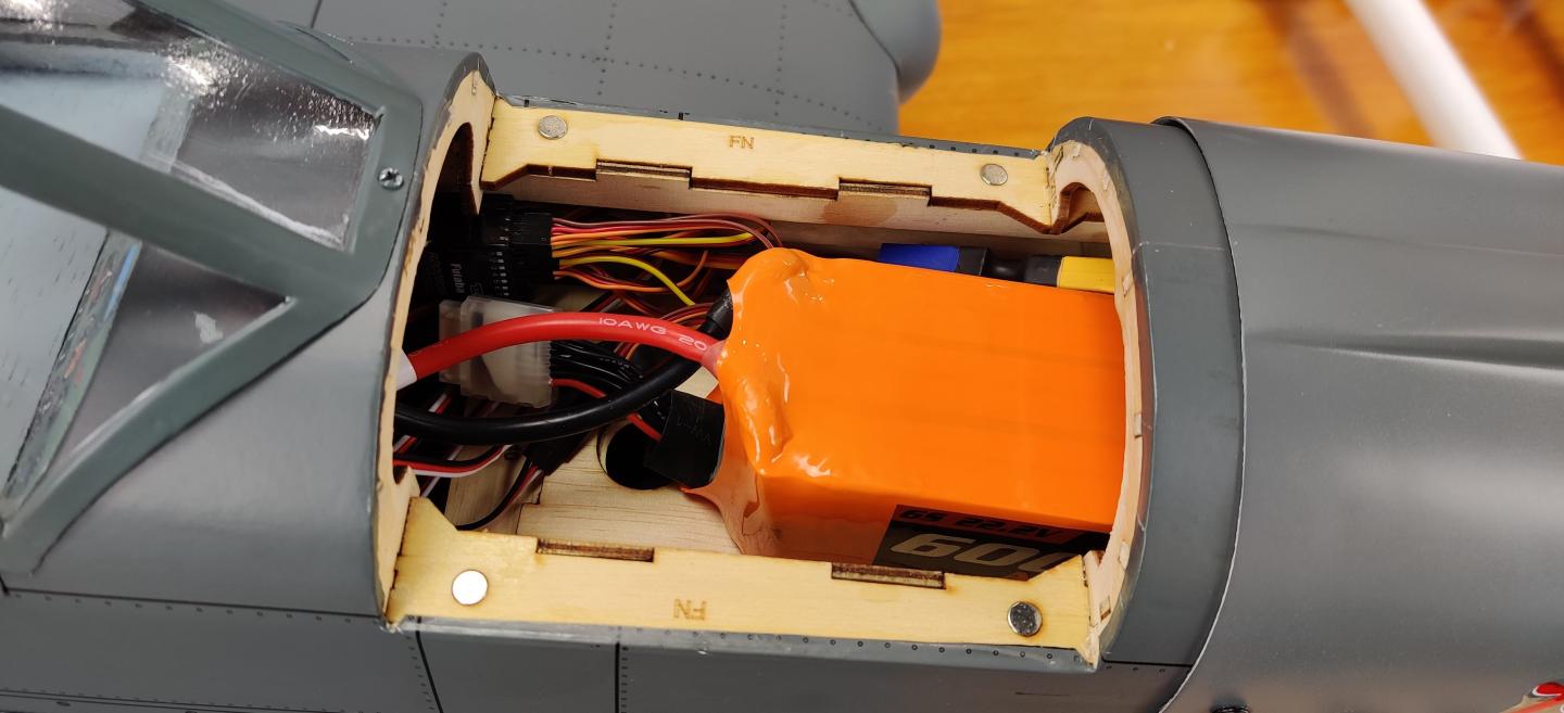

    The battery compartment fit a 6000mAh perfectly, easy in and out and she CG's perfectly at the book 4" - 4 1/8" CG location. No extra weight needed.

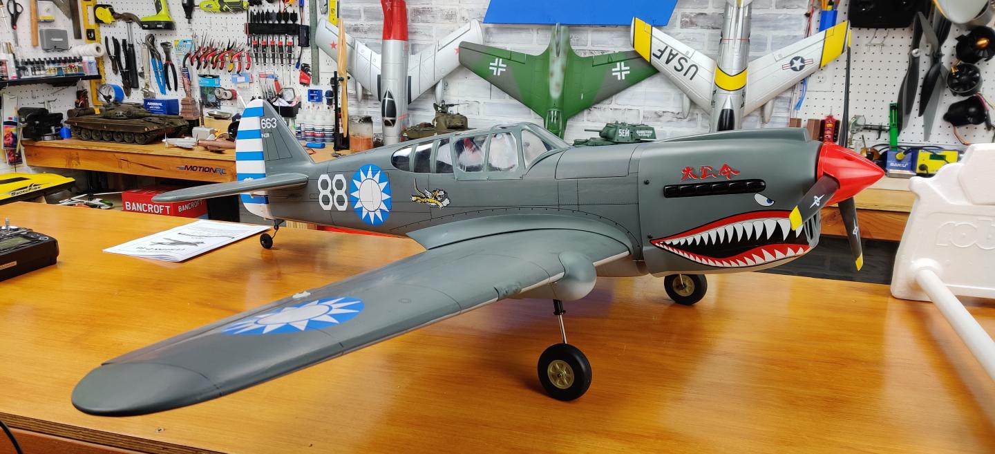

    Hey guys, wanted to get this thread started as I am in the process of assembling this P-40 and so far I really like the ARF Kit.
    This is my first Nexa WW2 Warbird and I am very pleased with the overall fit and finish of the model thus far. I am following the instruction to the T and haven't run into anything yet that I think should be changed.

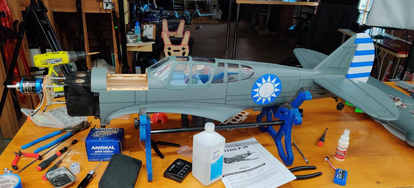

    I unboxed it Monday and got the wings fully completed and the tail assembly together in about 5 hours (with filming pauses), then today I got the elevator and rudder servos installed and the motor mounted to the point where it clears the cowl. Tomorrow, I should be able to finish it all up. Just need to attach the ESC, mount the cowl, install the battery tray and put the decals on. Then set up the RX and I will then start figuring out the CG. I assume I will need nose weight, but we will see how much tomorrow. Then hopefully I can maiden her on Thursday and show a lot of the assembly and flying footage on Friday's youtube live show.
    I am excited. She is just about the size of the FlightLine Spitfire and Corsair and will fit right in. But after I get pictures and video, I think I will be painting this one and calling Callie, but we shall see.
