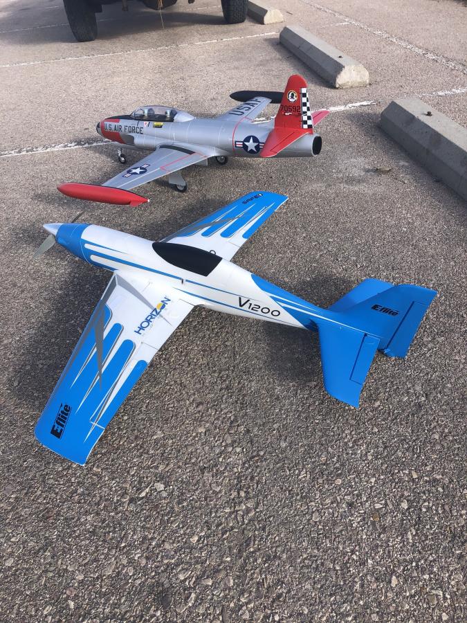

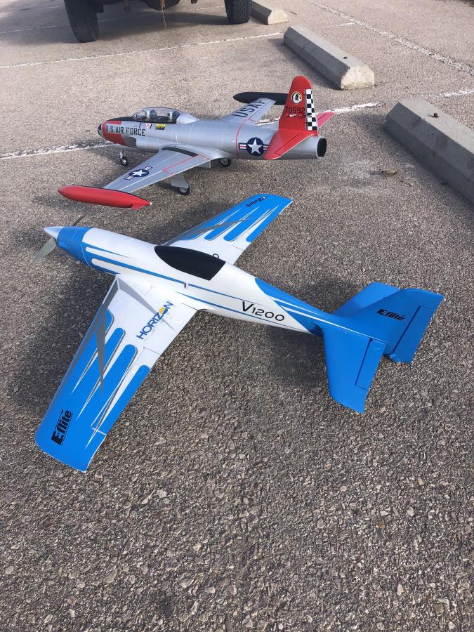

    My wife got me this for Christmas! After watching all the vids and reading the reviews on RCG, I was worried, as our flying field is not very large and is grass.
    my maiden went quite well. I am flying on 4S 3700. CG was quite nose heavy. I added1.5 ounces at the very back of the fuselage and it evened things out.
    Take off on the grass was very strait forward. Ease the throttle in. No need for full throttle on takeoff. Initial flight took a lot of nose up trim. Once dialed in, she flew fine.
    The blue and white colors scheme actually popped quite well. Though, the profile gear up turns it into an arrow! Lift a wing a bit and everything pops back into view though. I may still add some checkerboard trim under the wing.
    I set the described 15% and 25% mix for flaps (half and full respectively). It did not balloon up. Rather it settled nicely into a slight nose up attitude. Touch down was one if the smoothest I’ve managed, if I do say so myself! Roll out was ~60’...stopped pretty much in front of me! Bottom line, no issues on take off nor landing from grass.
    Second flight was almost a redo of the first. Though trimmed better. Takeoff was a nice flat climb out. Second landing encountered a bit of crosswind and lifted the left wing a bit just before touch Don. But, settled right back in.
    key to this airplane, IMHO, is energy and power management. Don’t cob the throttle on takeoff. Ease it in and counter P-Factor accordingly. I don’t like long drawn out approaches. I used a nice continuous turn to a short final and used about 15% throttle (it was a calm day), kept the nose pointed at the aim point. Slight...very slight flare at the end.
