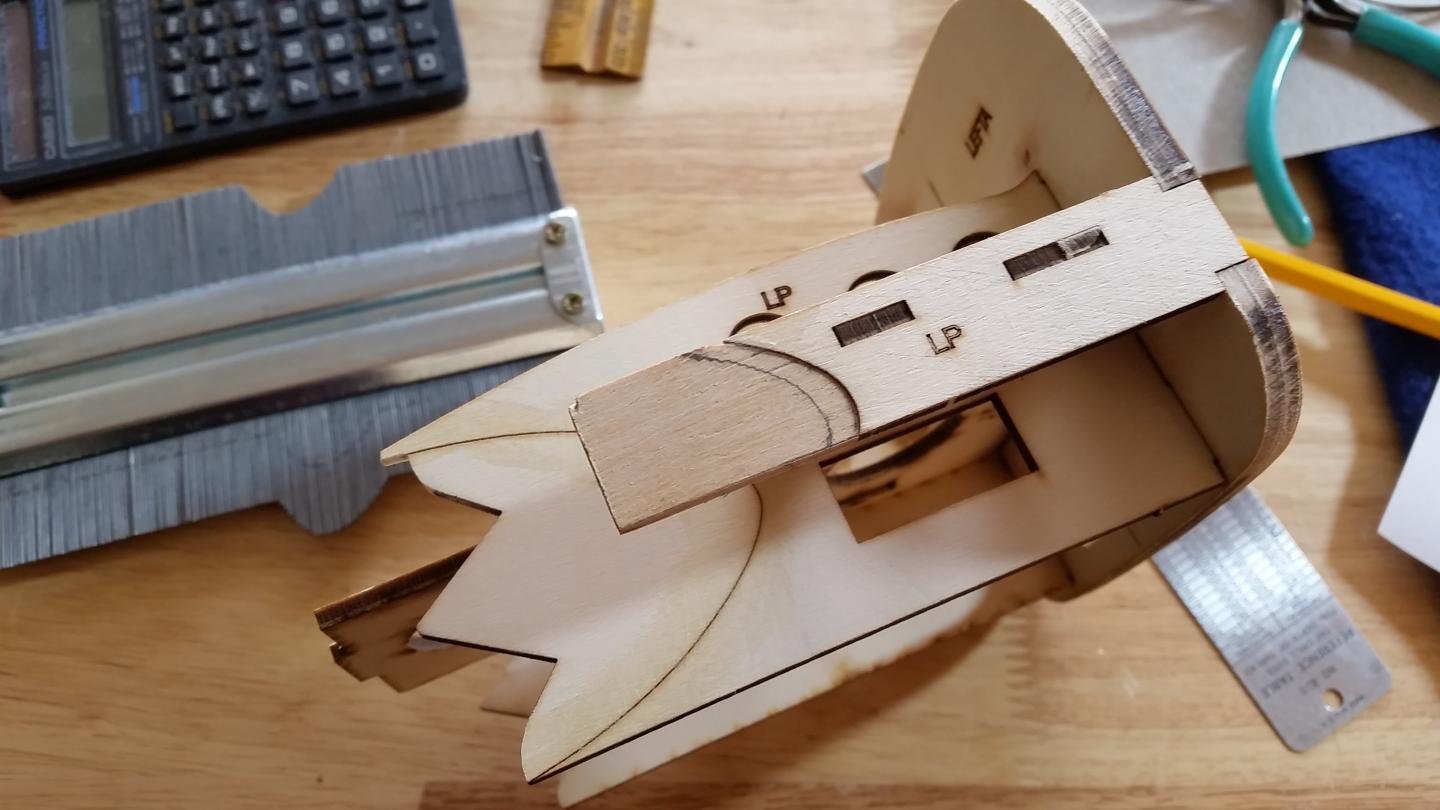

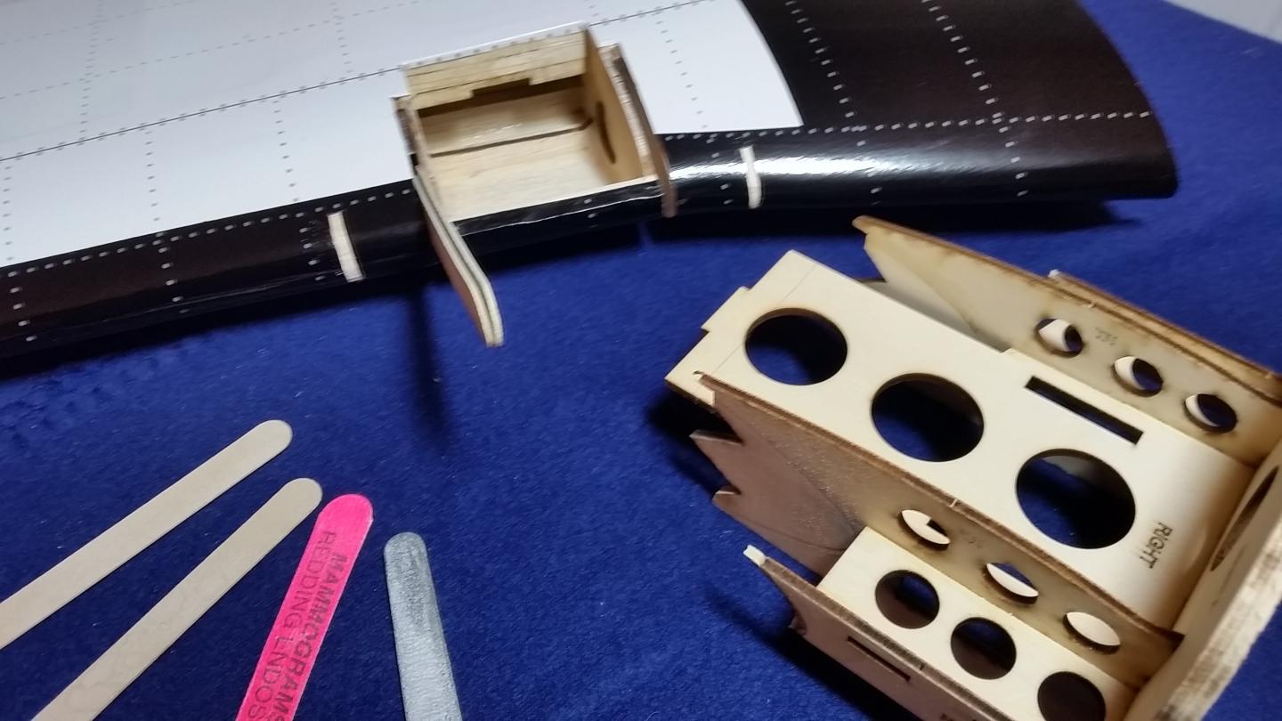

                            So from anybody who has built one of these, could you comment on the nacelle installation? Mine are REALLY tight. I mean, so tight if I could get them into place they wouldn't need glue! I realize what sandpaper is for, but holy cow are these a tight fit. I would love to hear from anyone who has already dealt with this.
                            Talking about the motor/nacelle mount into the wing.
                                      Mine were incredibly tight as well. I used a bunch of my wife's emery boards stacked up to be just the right width to fit into the nacelle mounting grooves. As I sanded, I used different combinations of thicknesses until I got them to fit. Also, I needed to add material to the "outriggers" and then used a contour gauge to mark exactly where I needed to sand back down so that the outriggers came into contact with the leading edge of the wing halves. It was a lot of work, but they appear to be solidly mounted now. I used the thin CA to glue into place. Worked great!
