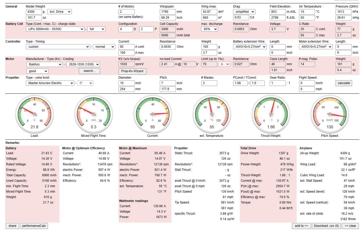

    Here is the e-Calc for the BadAss Motor

      Originally posted by newconvert View Post
      I used two BadAss 2826-1030 motors with 10x7, three-blade propellers. I haven't flown it yet, but according to e-Calc, it looks like a good setup. I'm using two, 3,000mAh, 4s Admiral batteries that I got from Motion RC. Using two 85A Mantis ESCs. I mounted the ESCs in the nacelles and ran the wires into the fuselage. If you're going to lengthen the battery wires (as I did) you'll need to hang some extra capacitors right at the ESC. I used the ones from Castle Creations and also mounted them in the nacelles.
