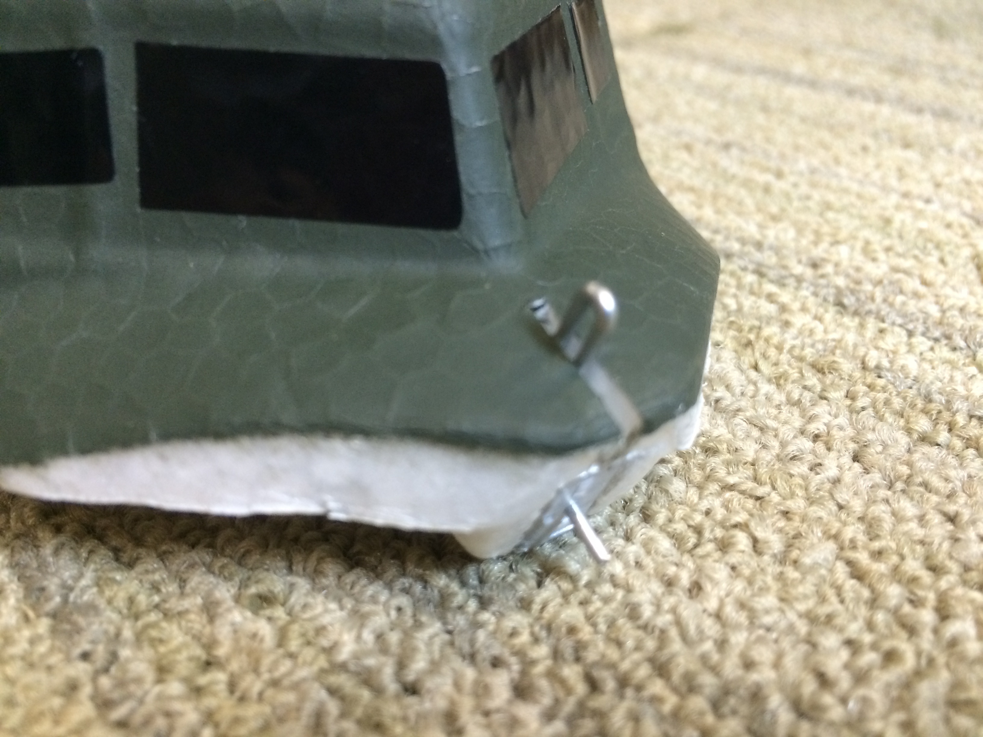

                                          I picked up one of these today, what a great value at $149...of course I had to do a couple mods...

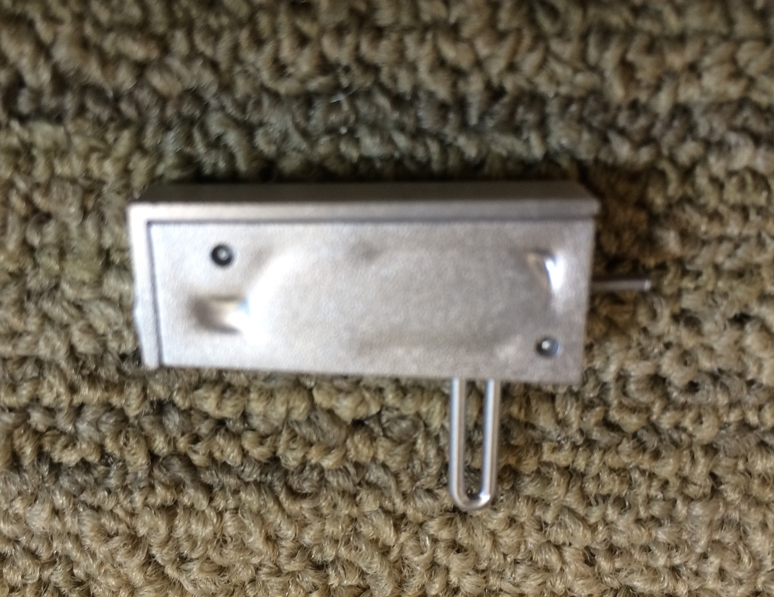

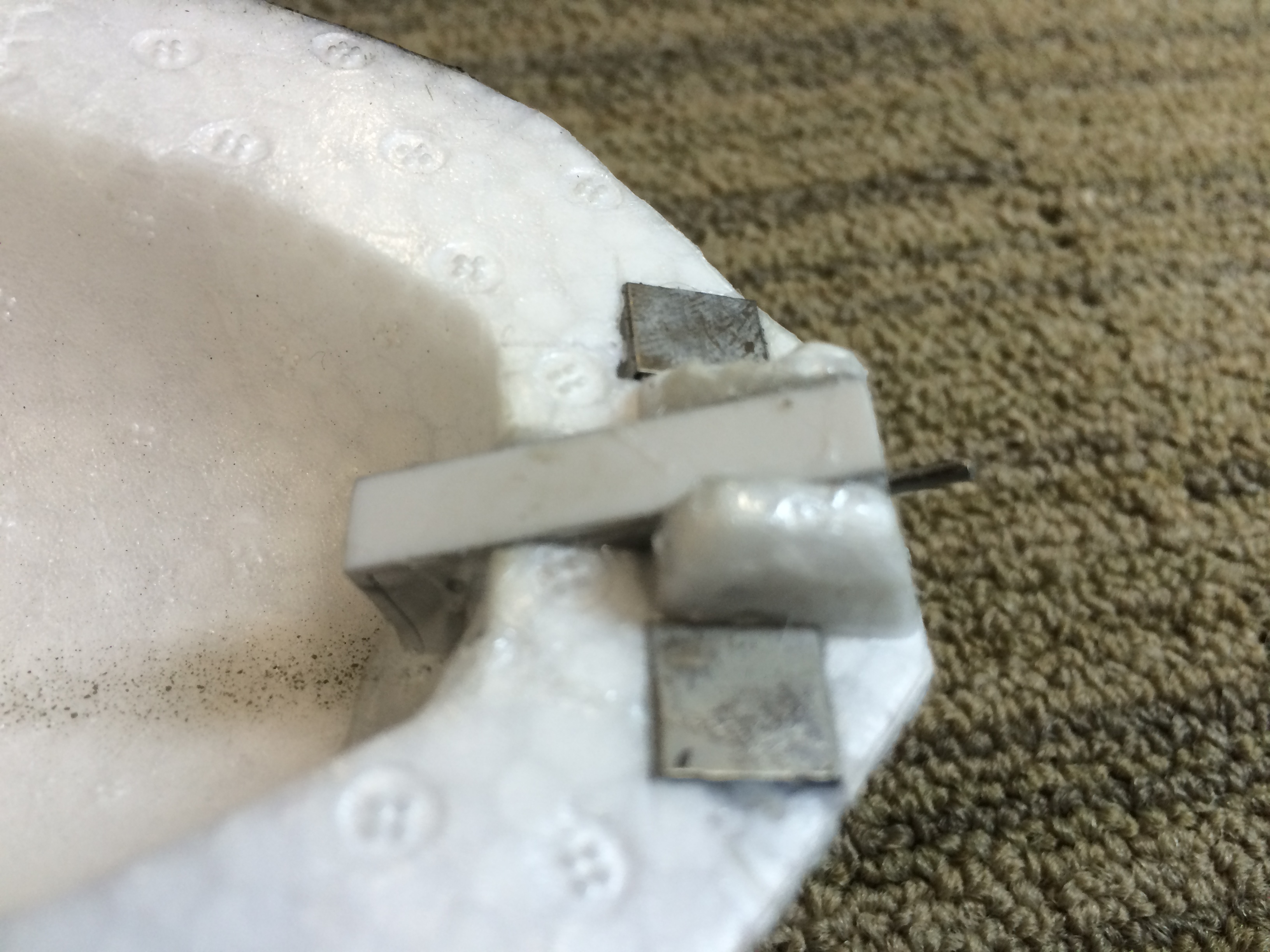

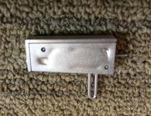

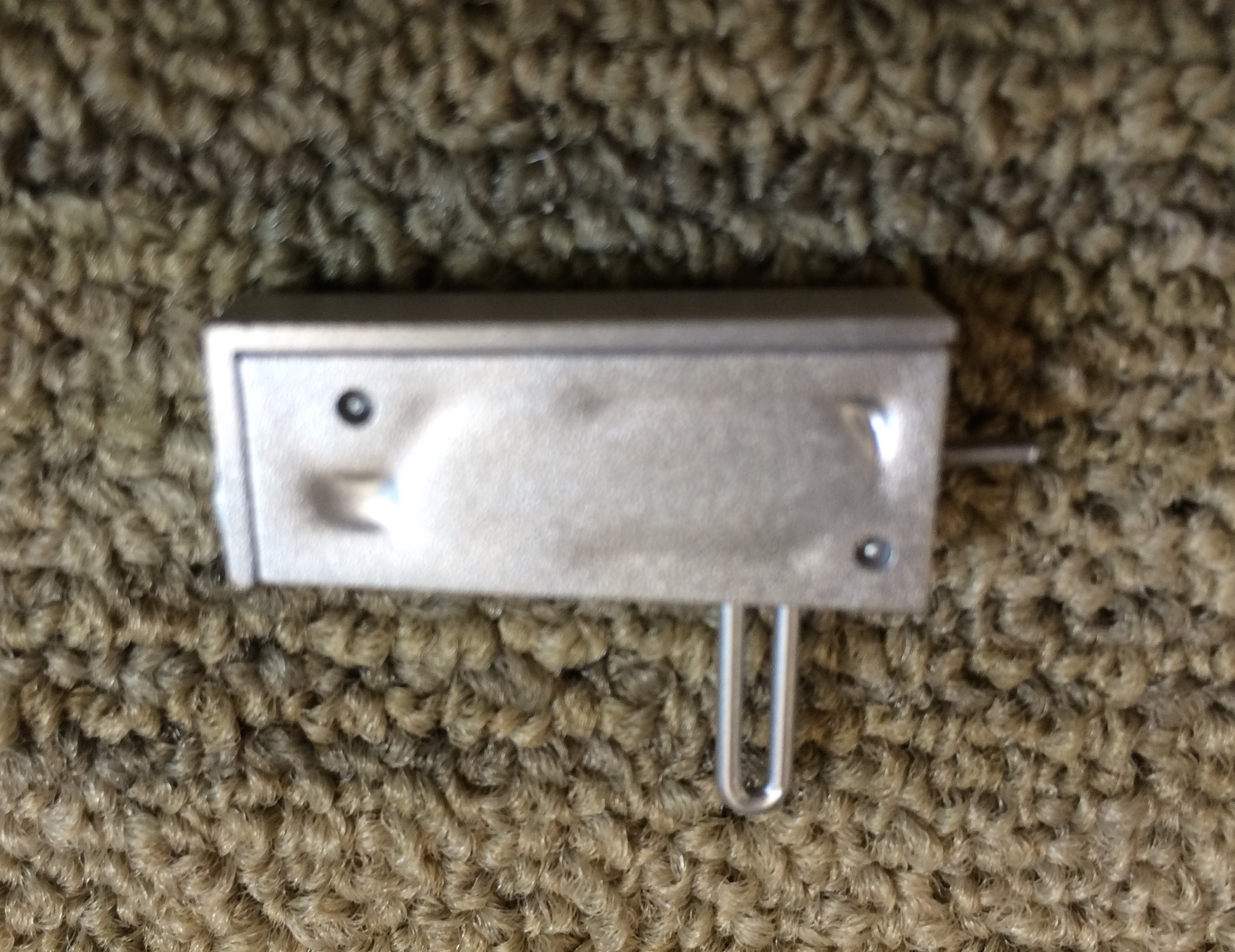

                                          This is a cockpit latch for the new 1600mm P-38

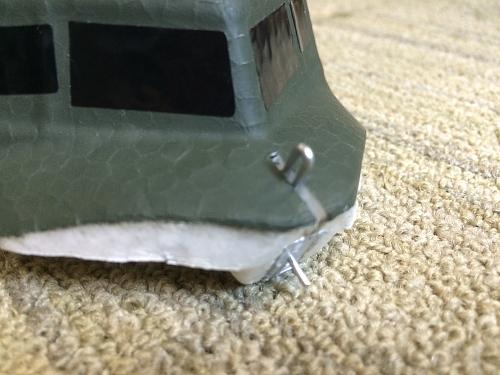

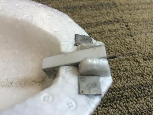

                                          Notched the cockpit nose for the latch

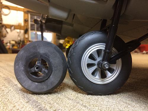

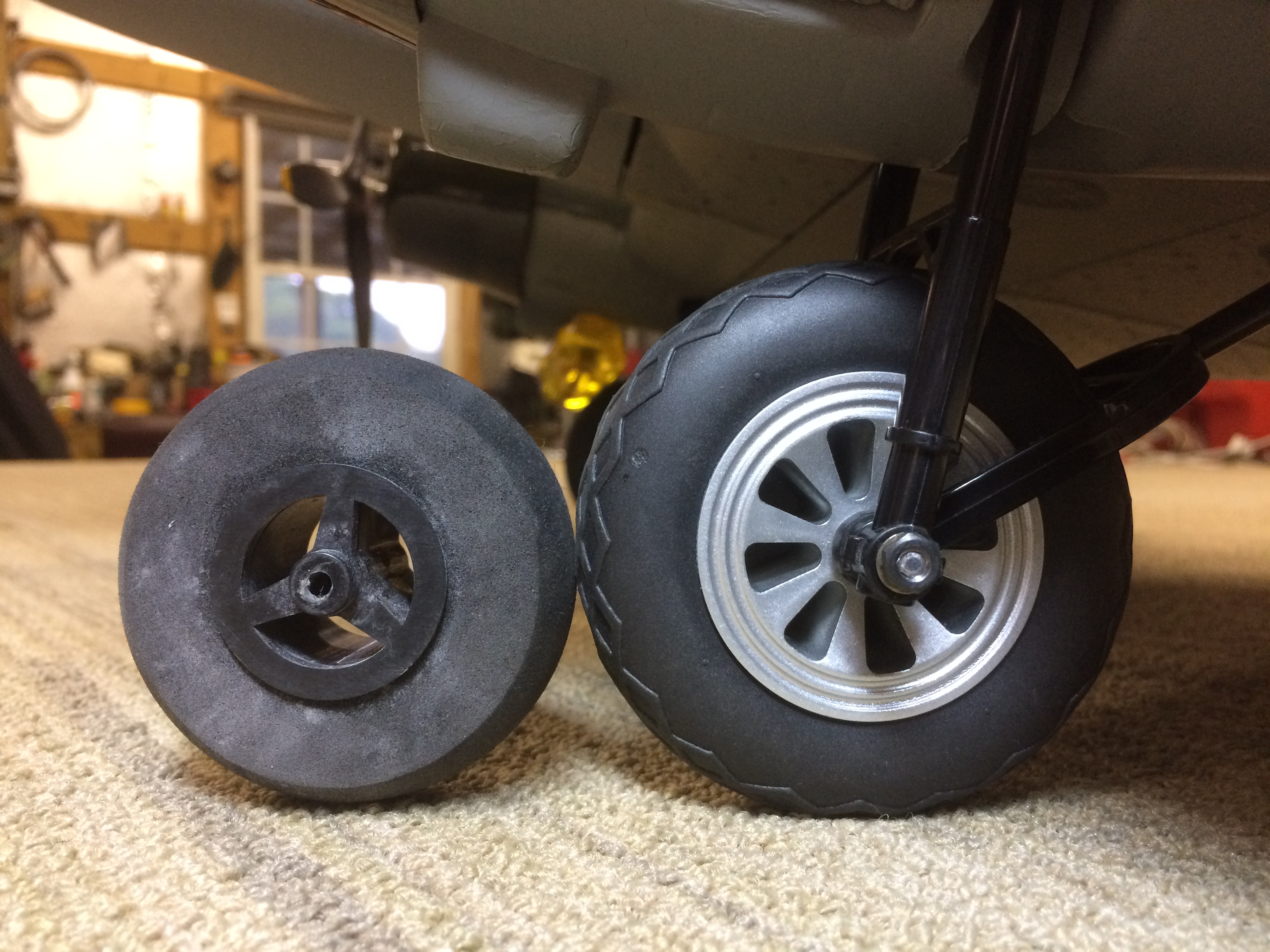

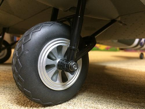

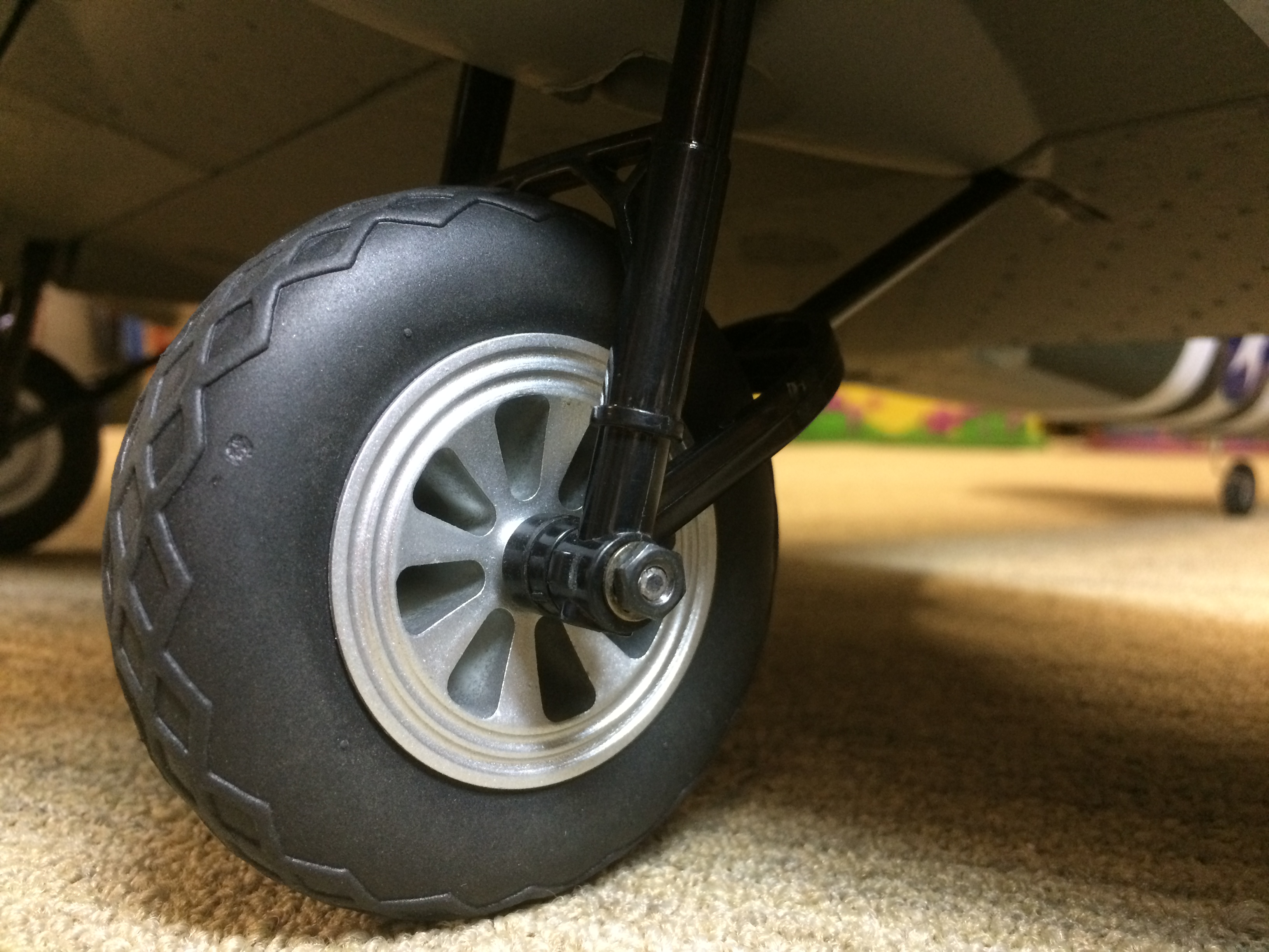

                                          Changed out the stock wheels for the FMS P-51 wheels
