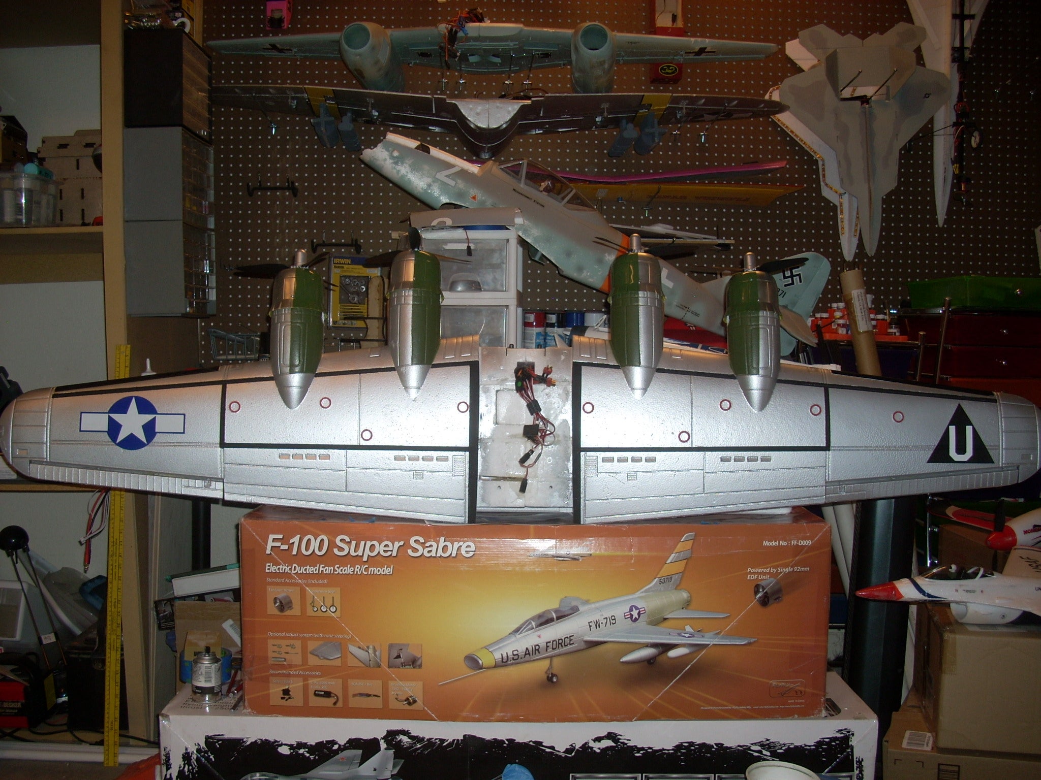

                        Thanks. Did a little detailing to the wing tonight. Added the Tri-U decal, painted the wing walk stripes as per the reference pic, and painted the red gas caps. I still need to do the stripes on the starboard wing.
                        Also, yesterday I embedded some 4mm CF tube into the center wing joint. I was not happy with that just being a glue joint, so I cut 3 channels and epoxied the CF in place. Nice and solid joint now.

                          Looking good!

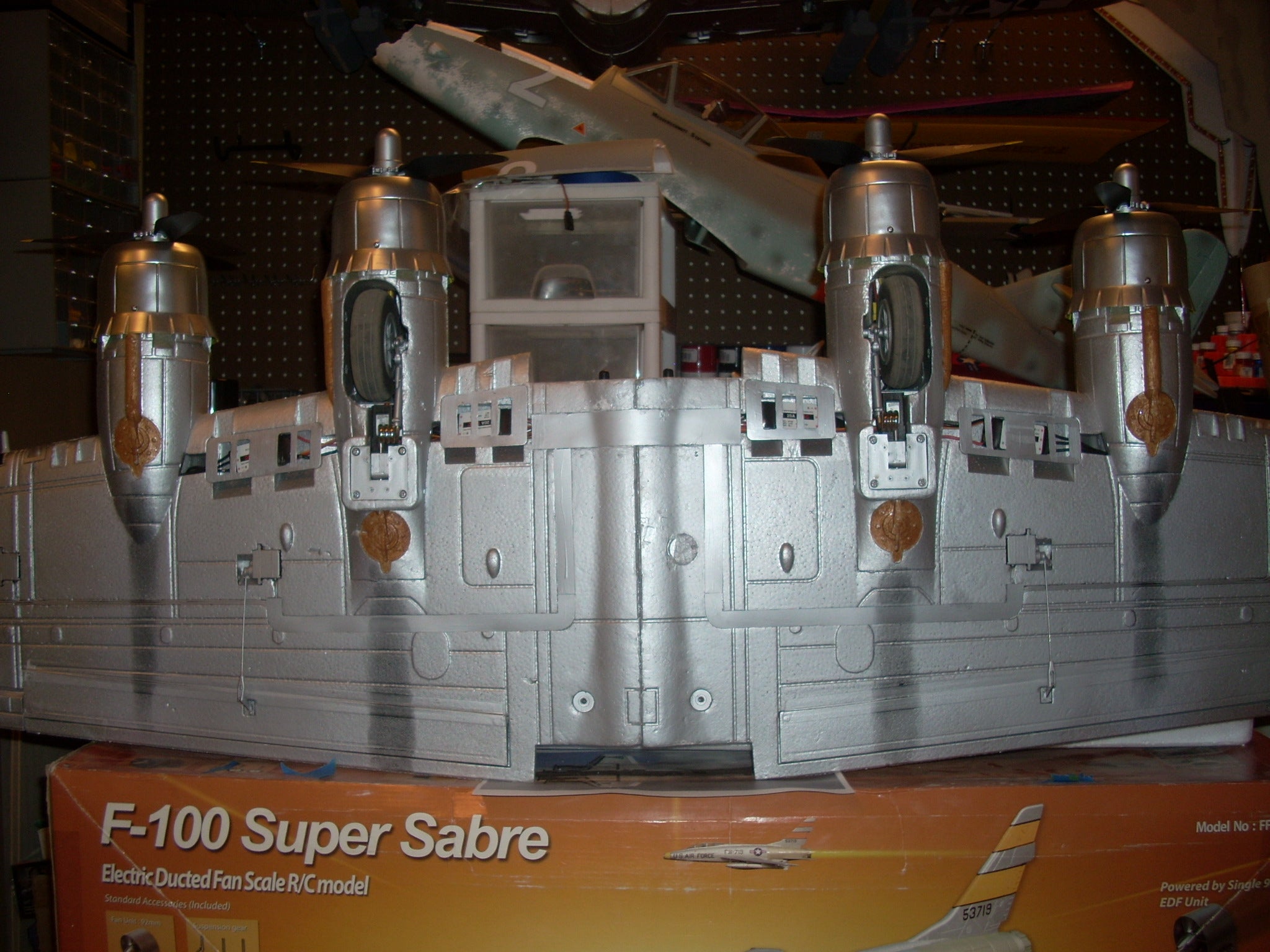

                                  Got a little more detailing done tonight. Finished the wing walk stripes on the starboard wing. Added some "rust" to the superchargers, and some exhaust weathering. Also got one side of the tail painted, and couldn't resist adding the decals.

                                    Looking good!

                                        Really nice workmanship.
