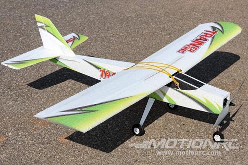

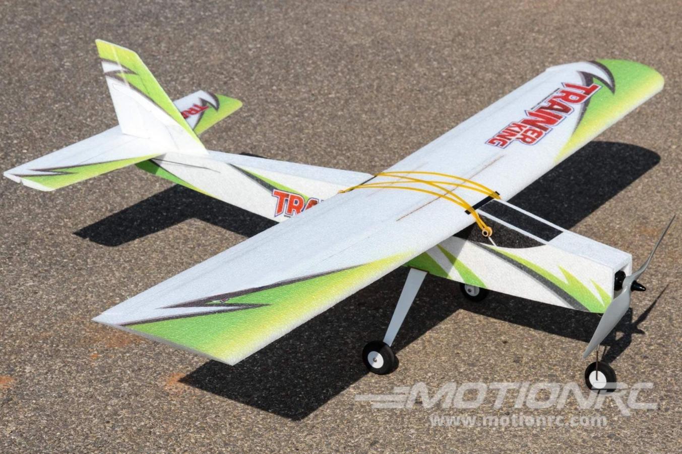

    Trainer King 1118mm (44") Wingspan - ARF BUNDLE from Skynetic - SKY1022-002
    Click here for the official product page
    The Skynetic Trainer King EPP is a high wing trainer that is perfect for learning how to fly. Both wing and gear are easily removable for transport and/or flying preference. Made of light yet durable EPP foam with a high and ample-cambered wing and rugged tri-gear, the Trainer King is tailor-made for anyone wanting a capable trainer for flight training.
