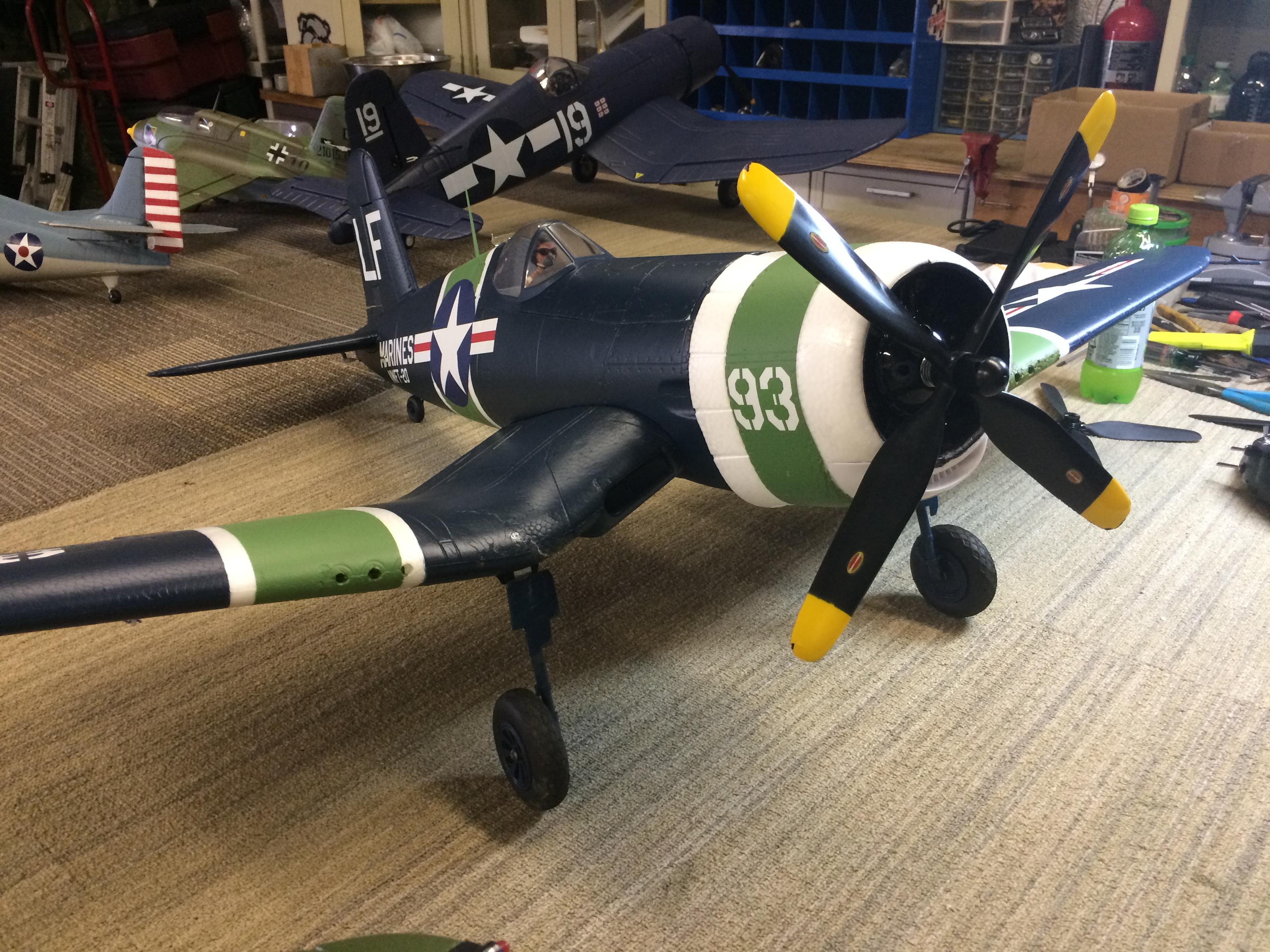

            I recently picked one of these up and really love it, the only thing I didn't like was the miniature prop so I put a 13X6 prop and 65A ESC in it. I tested with a 3s 2700mah battery and it pulls 60A.
            I put three batteries through the Corsair this morning and I can confirm she is much faster with the 13X6 and the 65A ESC. The first flight I took it easy and only did a couple of full throttle passes, the battery and prop hub were barely even warm. The second and third flights I flew mostly full throttle and the batteries and prop hub wasn't any warmer than with the stock setup, I'm very pleased with this setup.

                What were your flight times with the new set up?
                  6 minutes with 3.8 left.

                                I fly mine on a 4S 2200 with the large prop (posted above) and it screams, I fly this plane almost every day.

                                  TI; did you change out the ESC?
                                    #18
                                    Yes, 65A

                                        I wish the nose wasn't white and the green stripes were non on it. I know it's a legitimate scheme but I'm not a fan of green unless it's in paper form. :)
