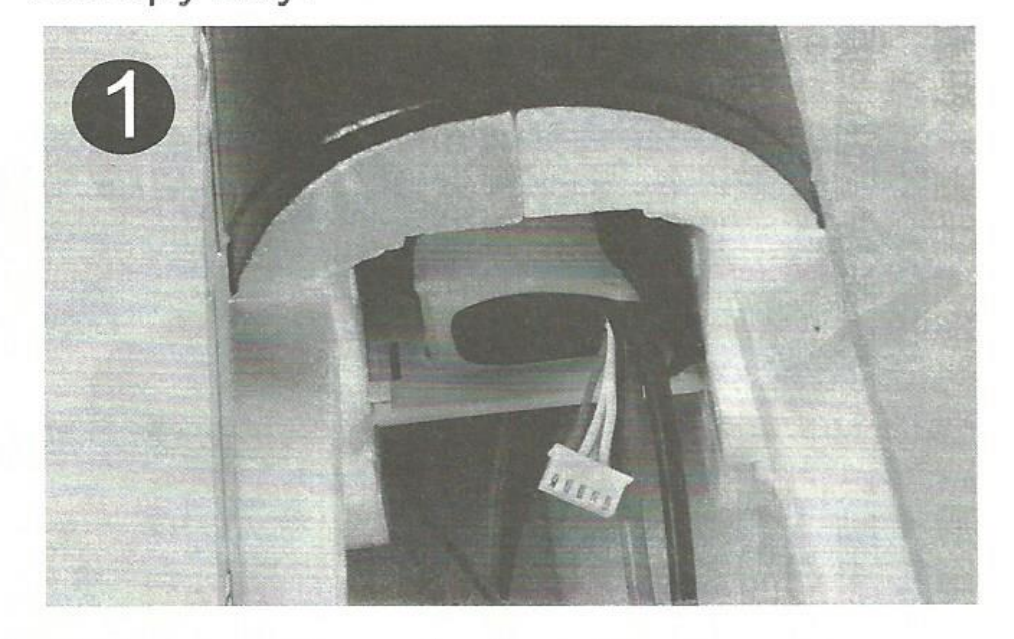

                The problem with planes43's situation is that the battery goes into a sort of tunnel. It is not possible to install a battery strap to hold it down. That's why FMS went to a battery tray that slid in on rails and locked in place. Here is a picture of this tray and the tunnel the battery goes into. Without that tray and rails, it is very difficult to reach in there to install a battery strap, let alone get in there to do the strap up. My 1700mm FMS Corsair is the same way - no tray, no rails, no straps. There are two ways to hold down the battery. One is via velcro and the second is by installing some kind of strap at the rear of the battery tunnel to prevent the battery from falling out. On my Corsair, this is not too bad since the battery goes as far forward up behind the motor firewall as possible to achieve the proper CG. I'm not sure about the old version P-51. A spacer may have to be made out of foam before it can be strapped in from falling out backwards.
Name:	Screenshot 2022-07-27 154938.png
                Imagine there being no tray or guide rails. One would have to do a little inventive modification to hold the battery in place. Of course, you can always buy the newer tray and guide rails and epoxy it all in place.

                  It won't fall out backwards because the front of the canopy is there... Right?

                    That is a conundrum right there, for sure! I must admit to not knowing the inner moldings of the FMS models. Velcro is definitely the best bet in this case.
                      It won't fall out such, but it can slip back up to a couple of inches before hitting the front canopy bump, depending on the size of the battery used and where in the tunnel it needs to be held in place. With my Corsair, even the heaviest 900g, 6s battery needs to be right up against the motor firewall. On this P51, it calls for a 4s and as small as 4000mah, so it may have to be held far forward. It's been a while since I had my V8 version when it was 4s. There's a lot of space up there for movement.
                      Thinking back about it, if it were me, I'd buy the battery tray and side rails and find a way to secure the whole thing in the tunnel. I believe Horizon can still get that piece.
                        • 5401
                        I know it was just about impossible to replace the rails in the V8. Probably a lot easier to add ones in a plane that never had them.
                          • 8814
                          I think you're right.
