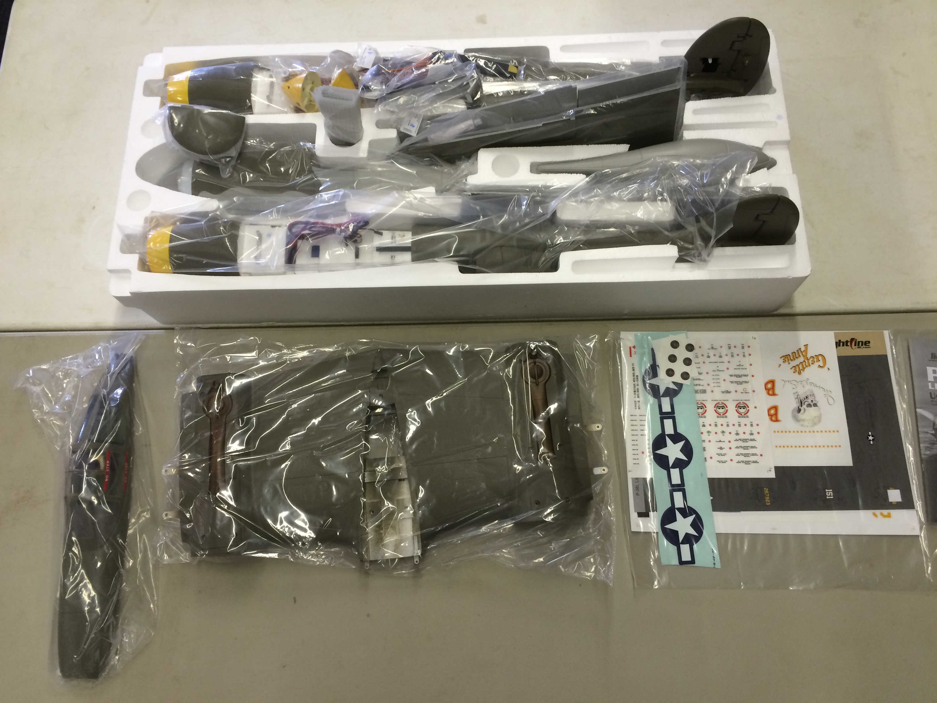

    I thought I would start a thread on my P-38 build, I hope others will as well.
    Out of the box..

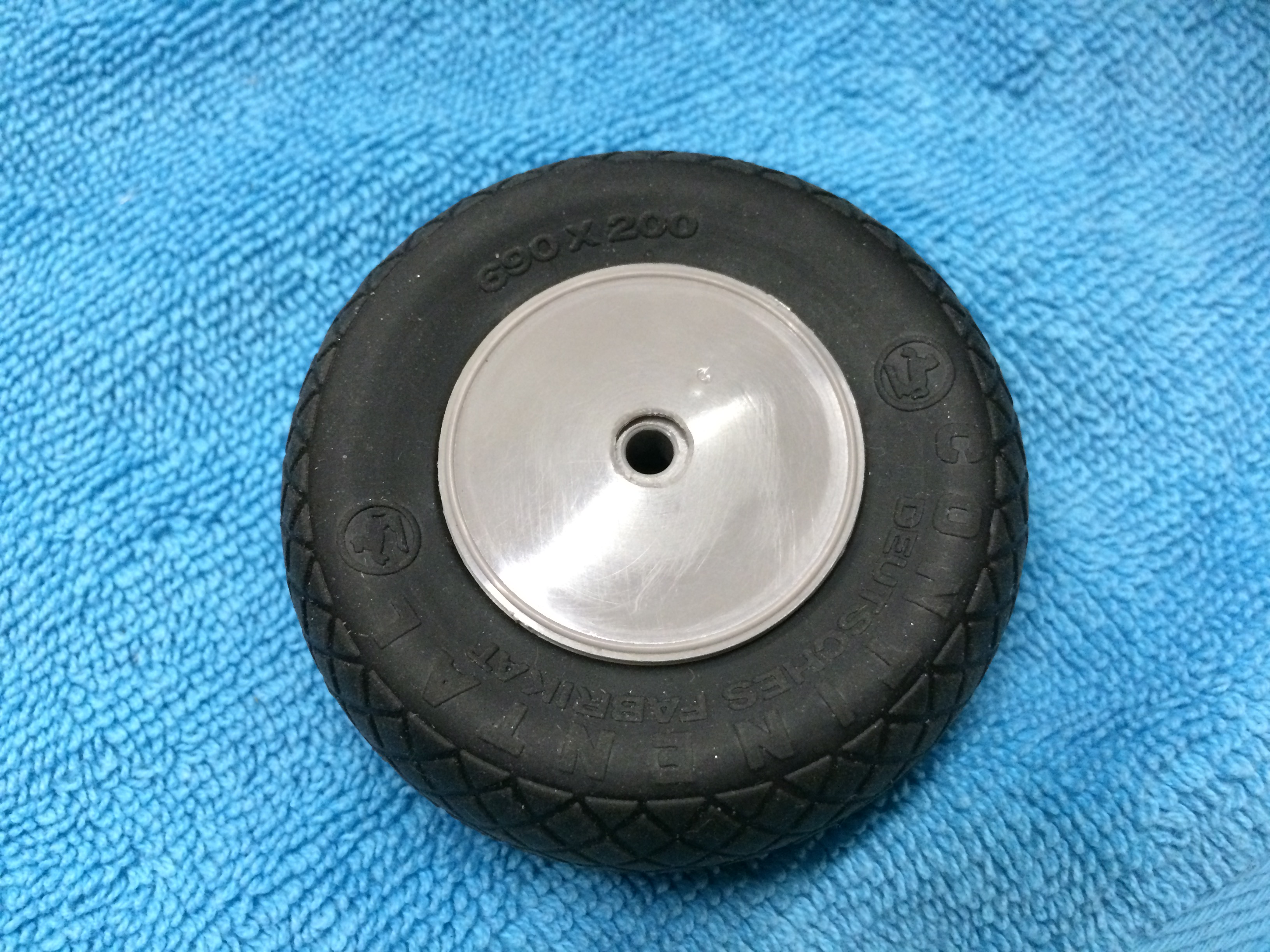

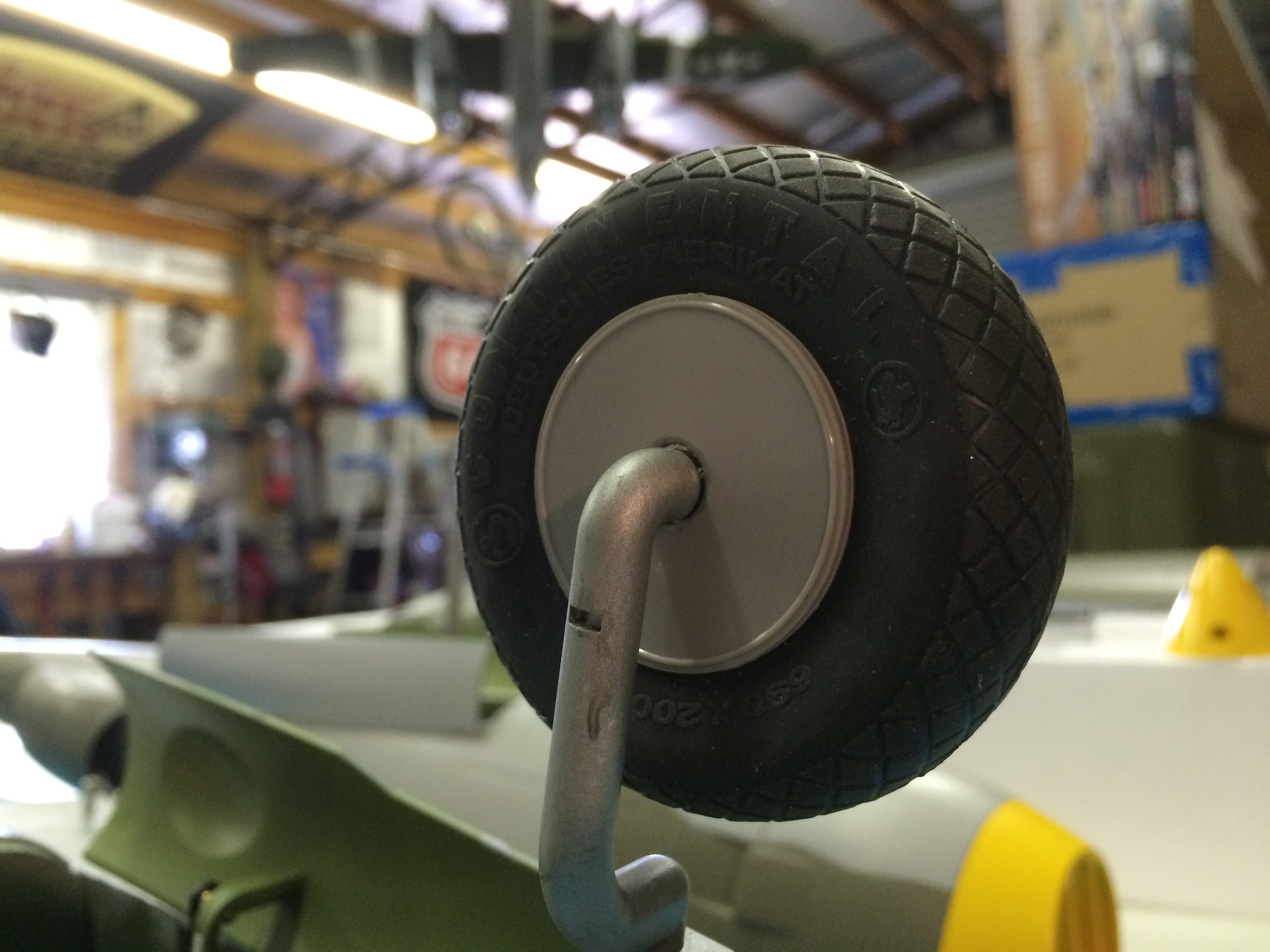

    Installed the Robart wheels, I drilled out the smooth caps to use on the backside to cover the screws.

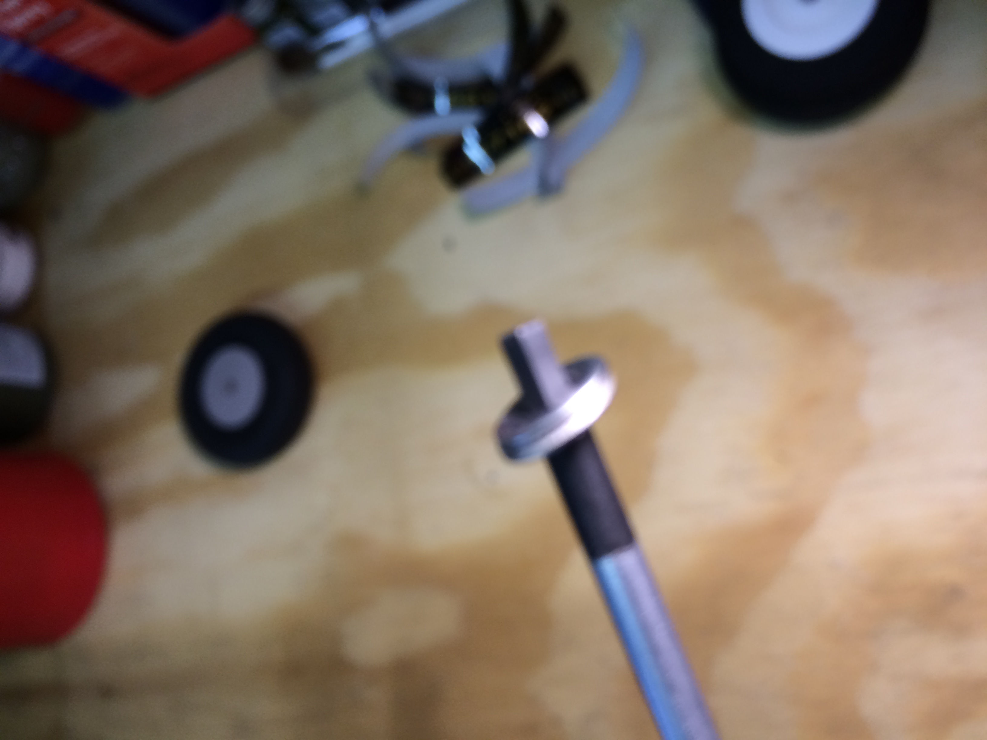

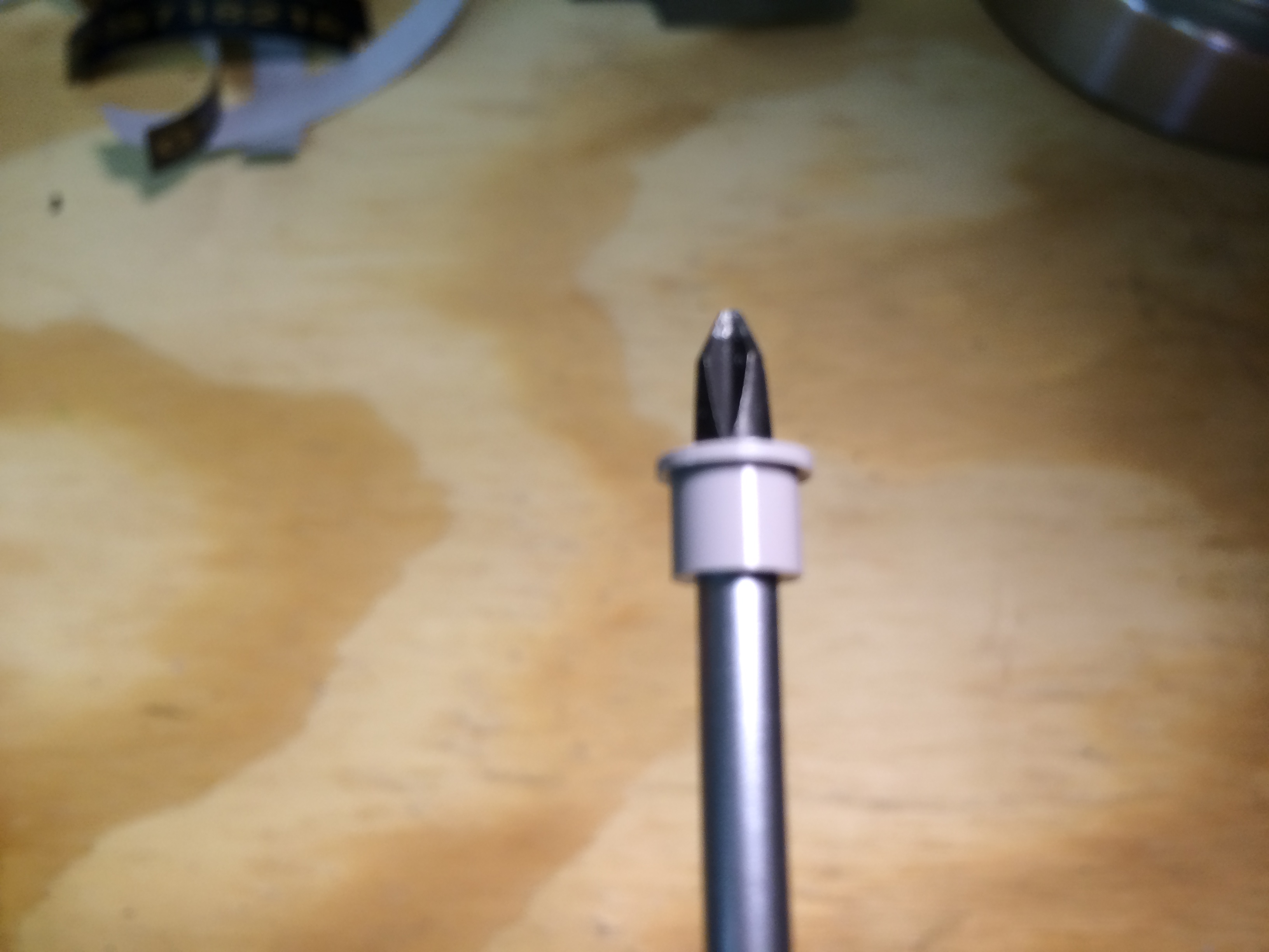

    To get the wheel cover to clear the retainer I had to cut the outer sleeve down past the lip so it would be flush with the wheel center. I then cut the gear shafts at the flat cut. Cutting down an Allen wrench will help in tightening the retainer.
    Using the solid cap on the backside made for a clean look.

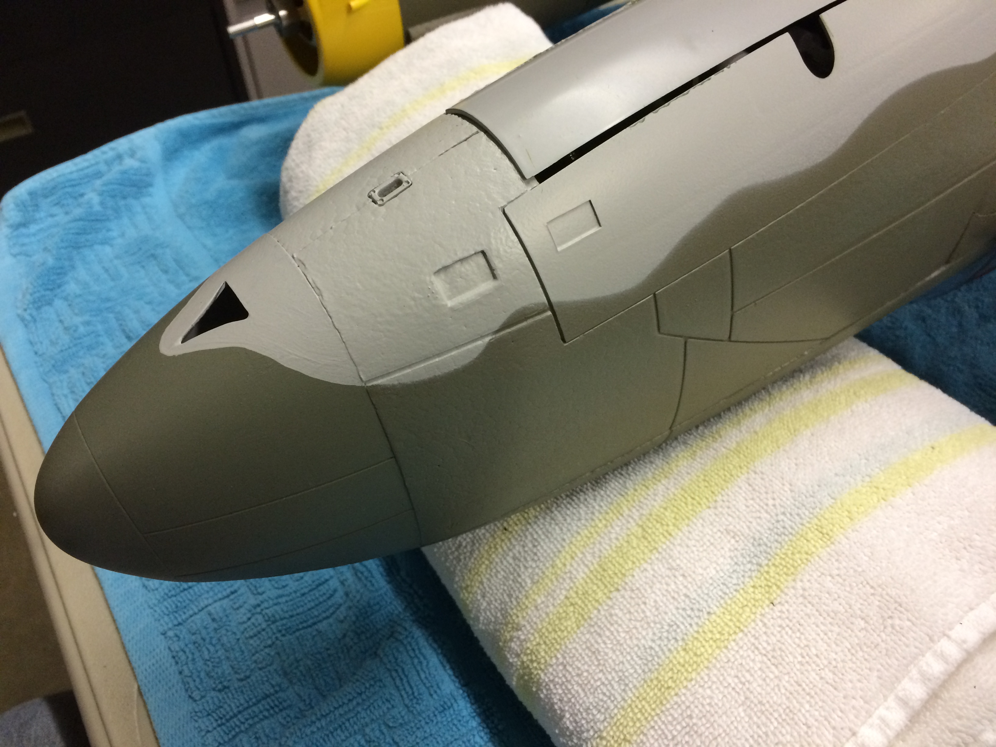

    Painted the nose, haven't decided what to do with the spinners and cowl.

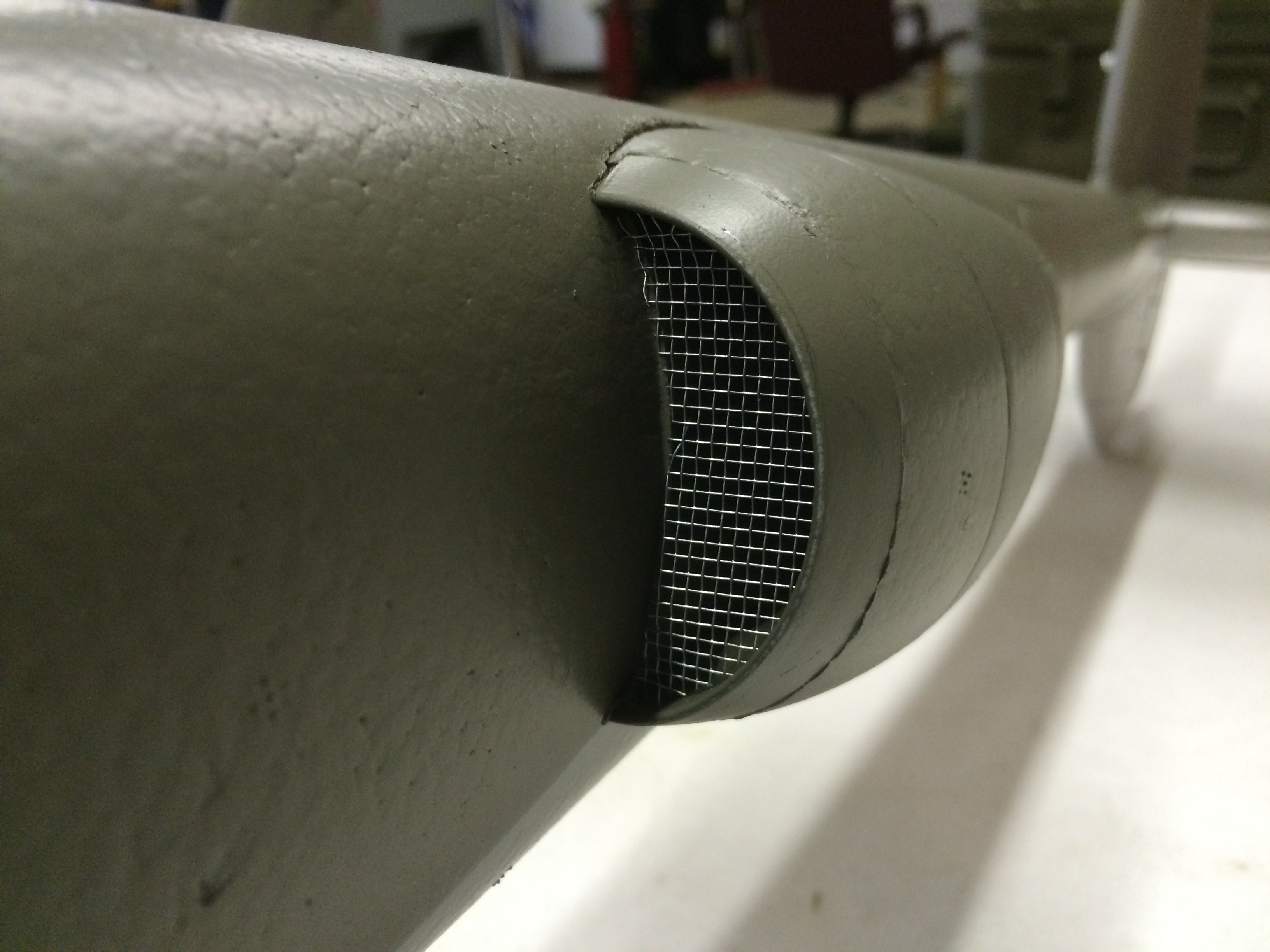

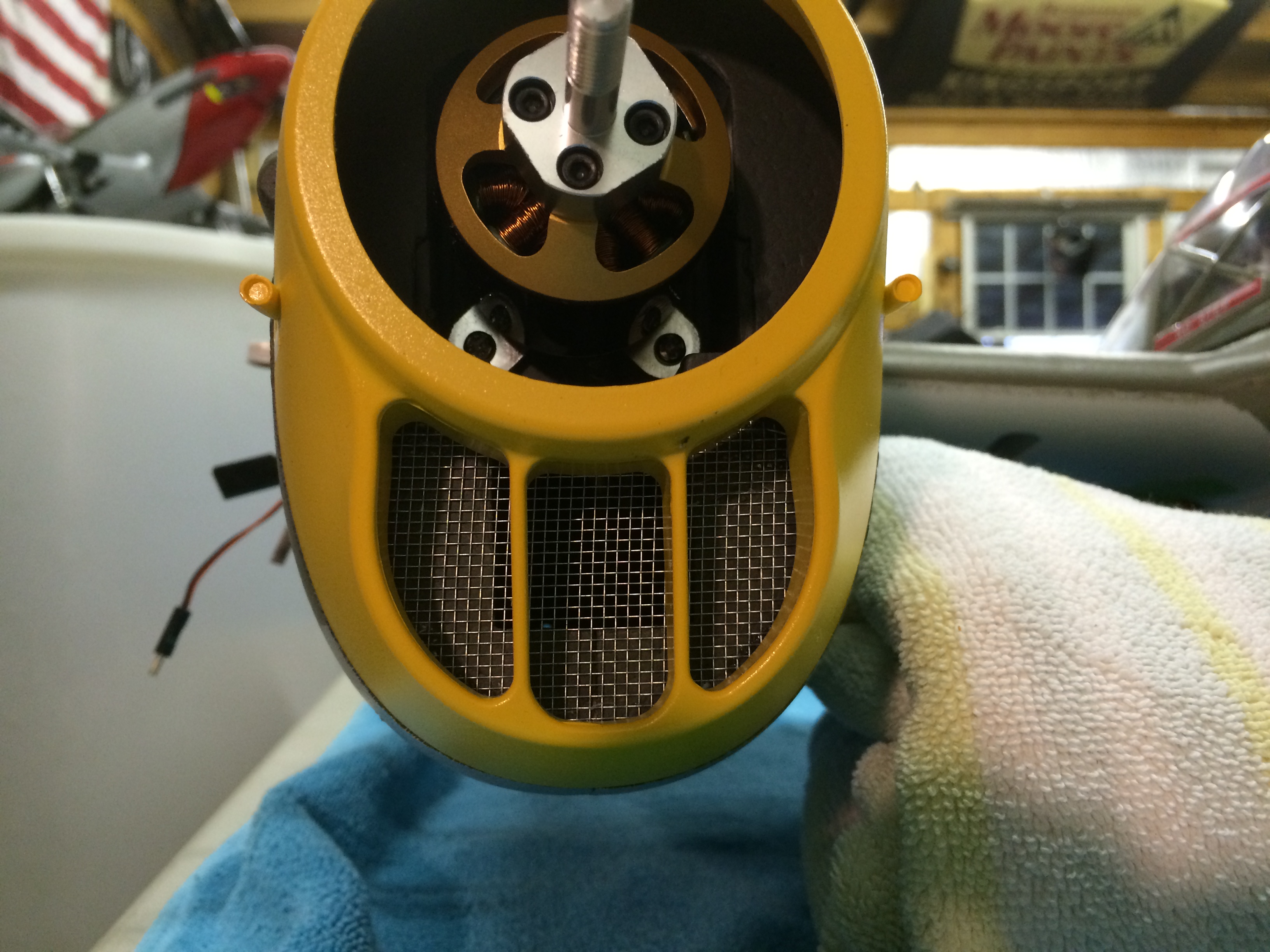

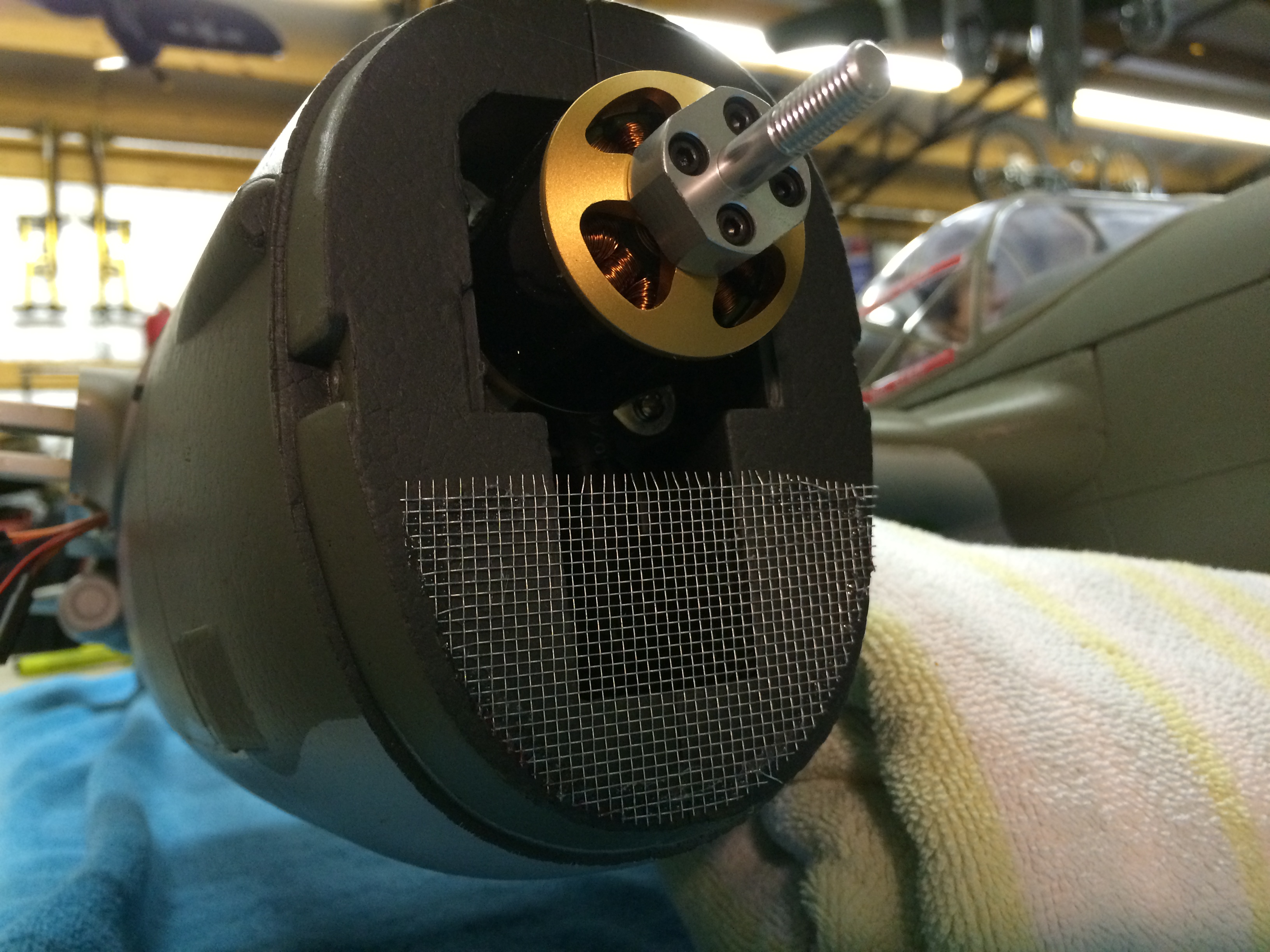

    Cut some aluminum screen for the cowls, will probably do some for the rear air intakes as well.

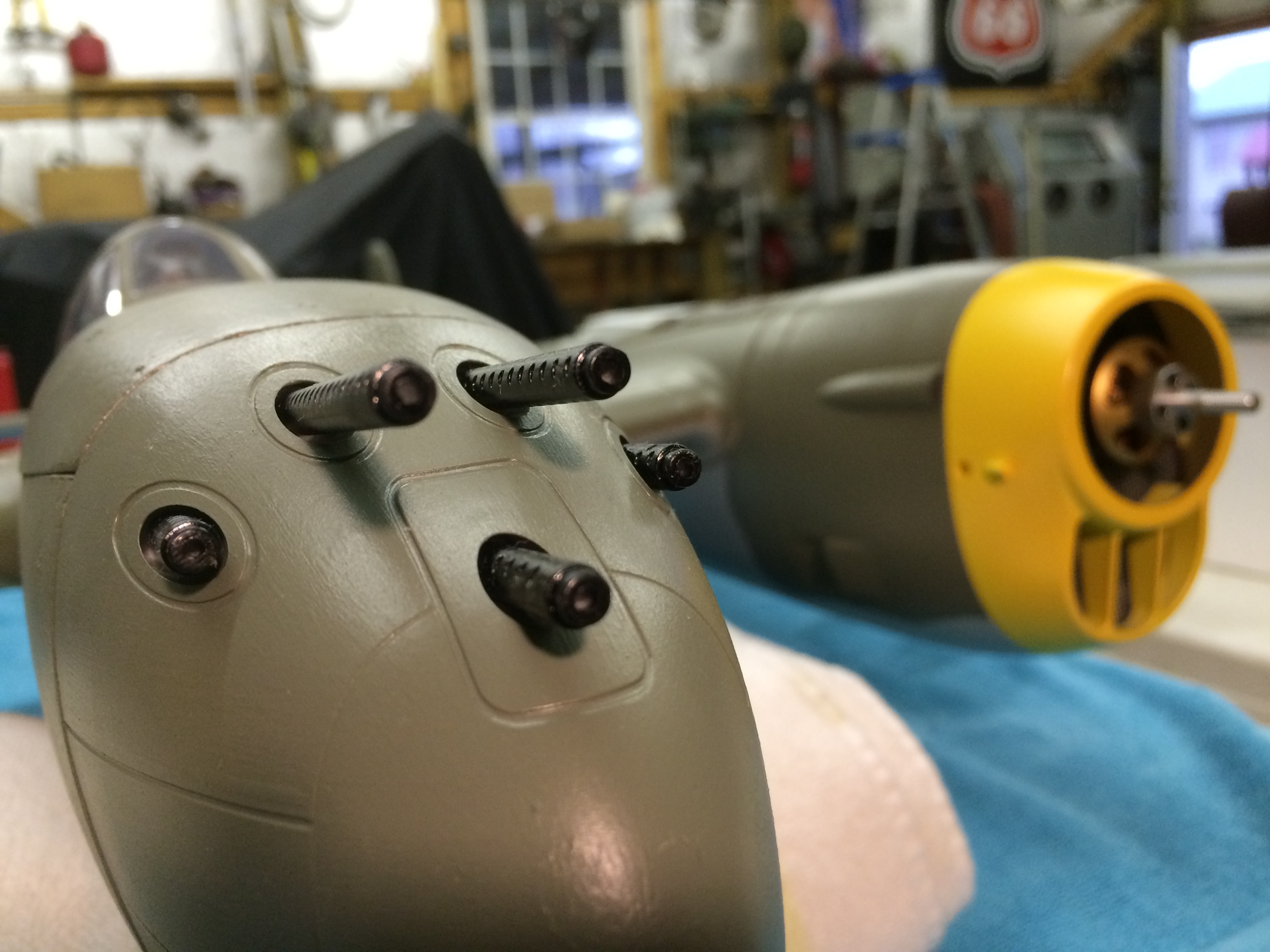

    Like most kits the guns come with solid ends so I drilled them out.

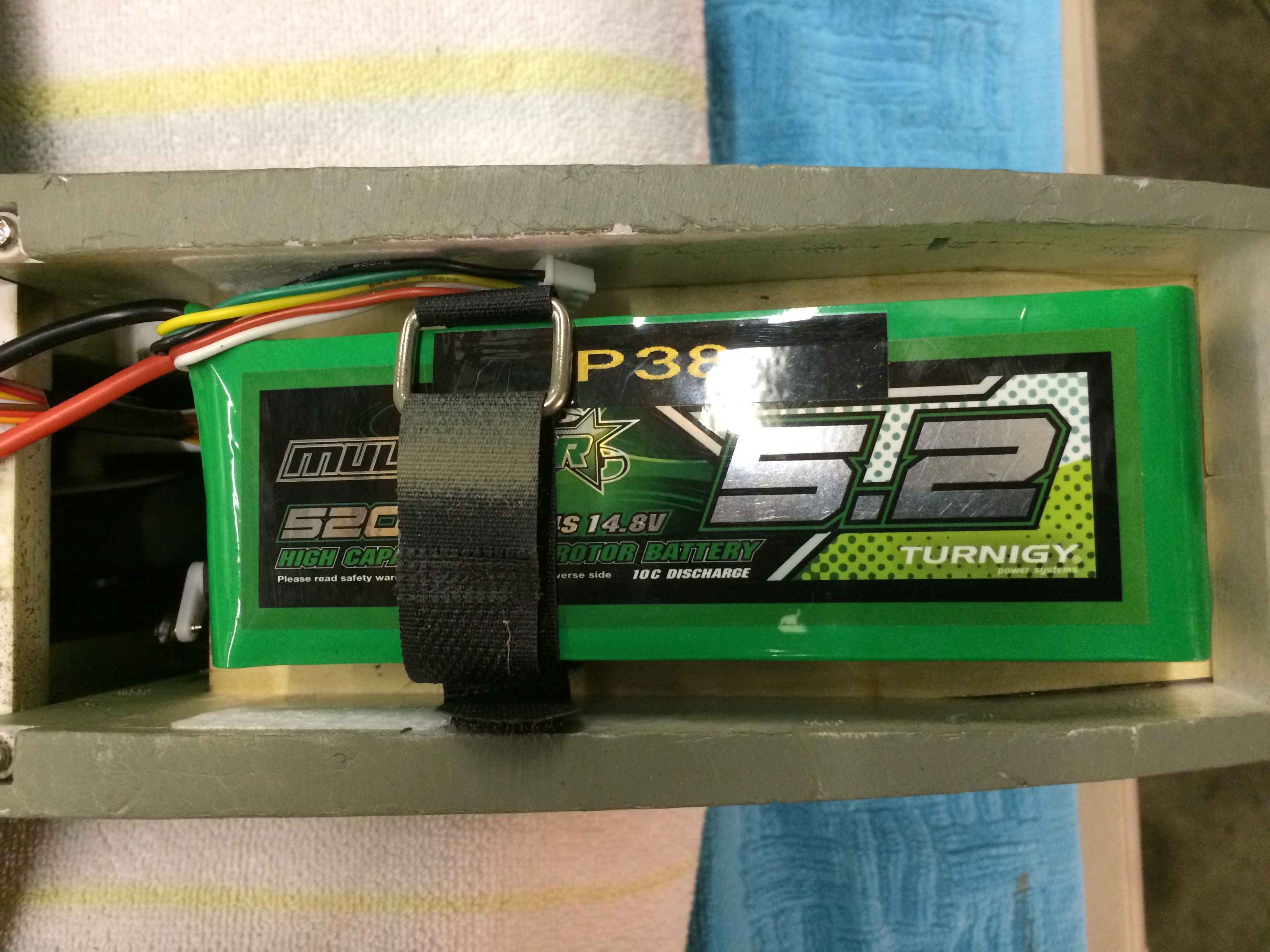

    Nice fit.

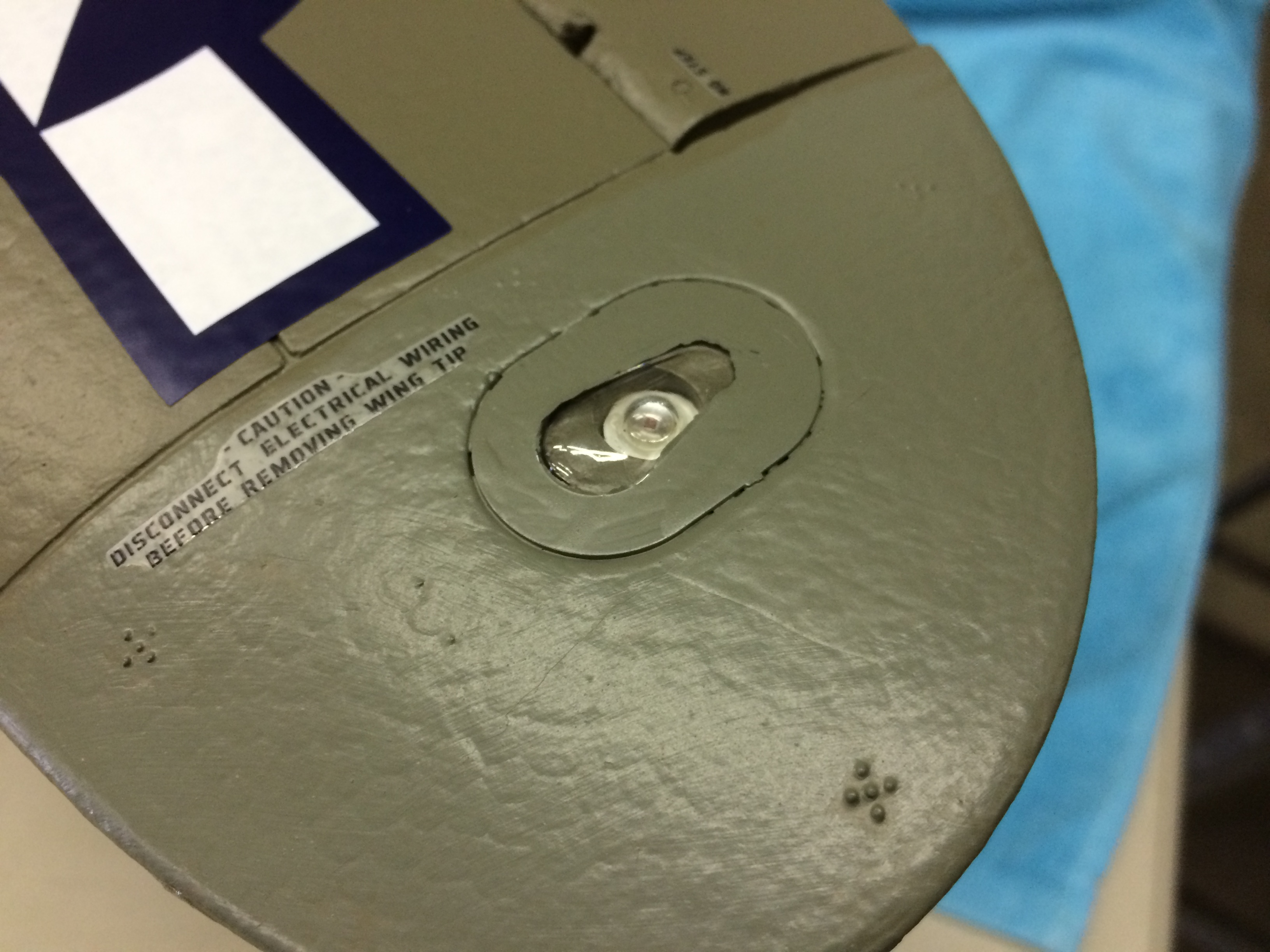

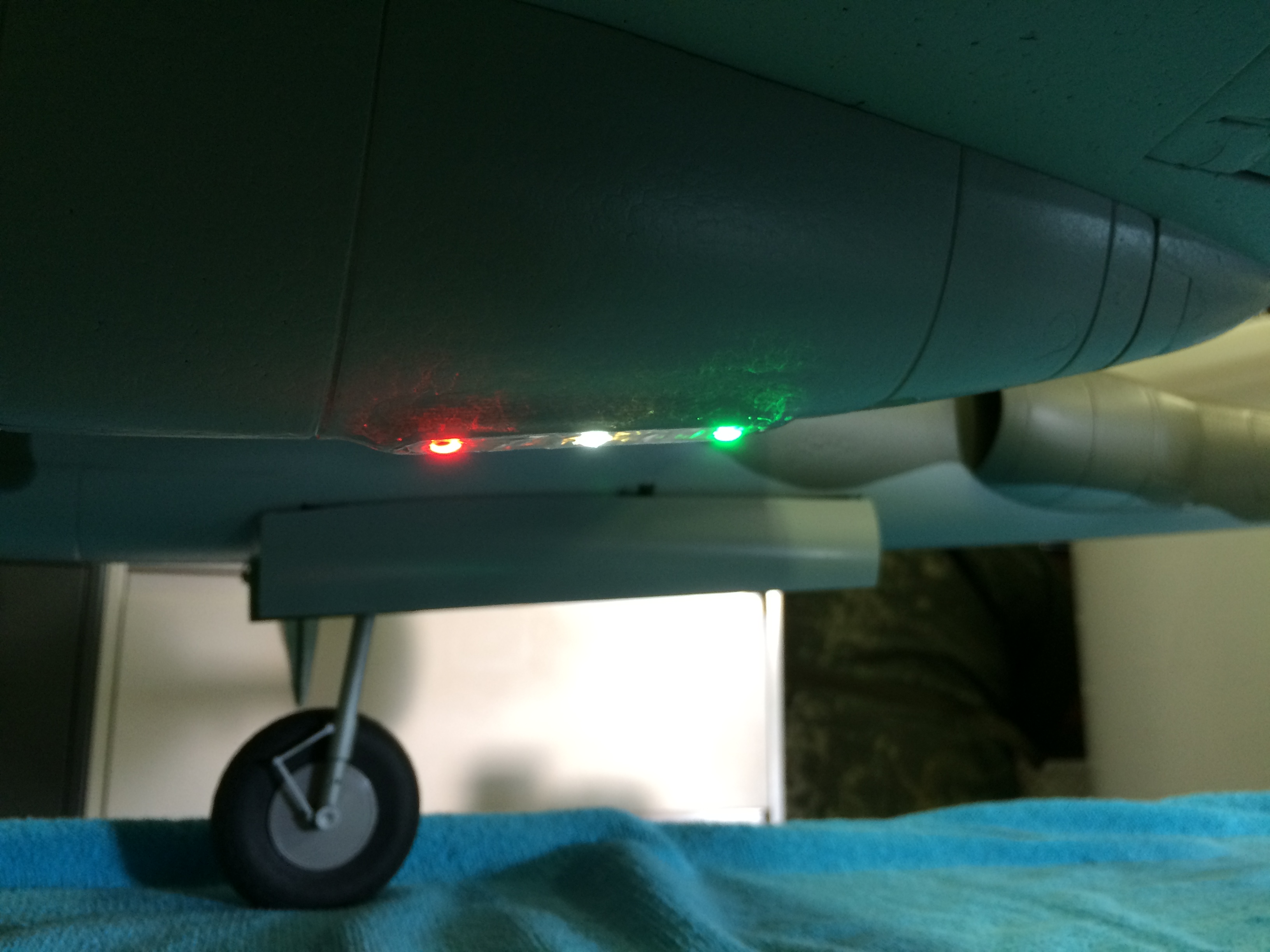

      Painted the clear plastic around the lights.

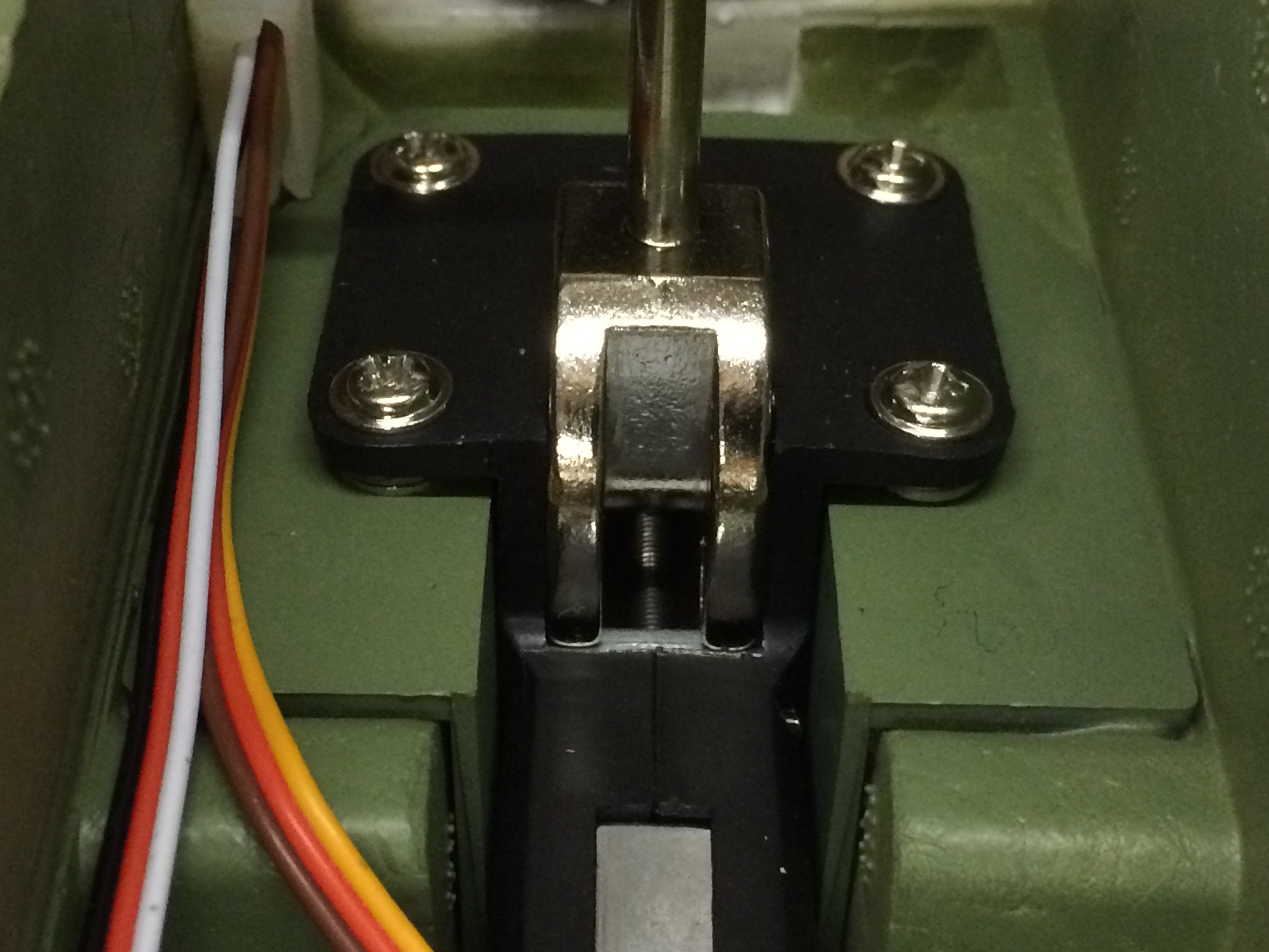

      I did the gear rake mod using two washers under the rear of the mounting flange.
      It's a good idea to glue the washers together to prevent a cussing fit.

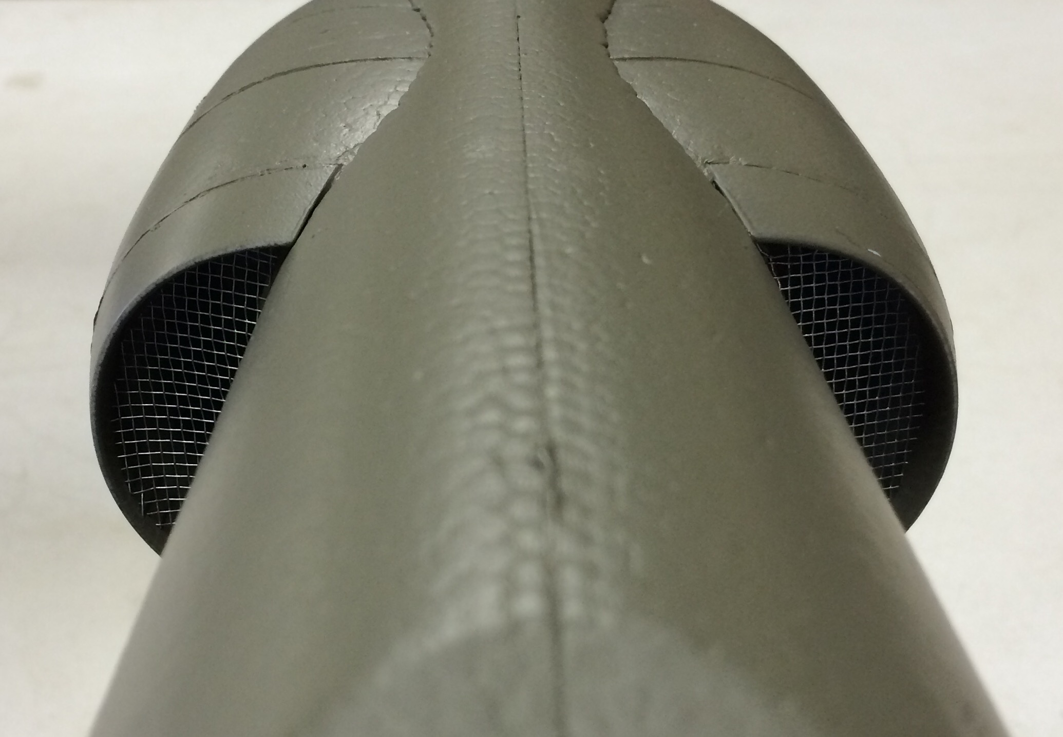

      These were a job to cut out.
      But they turned out nice.

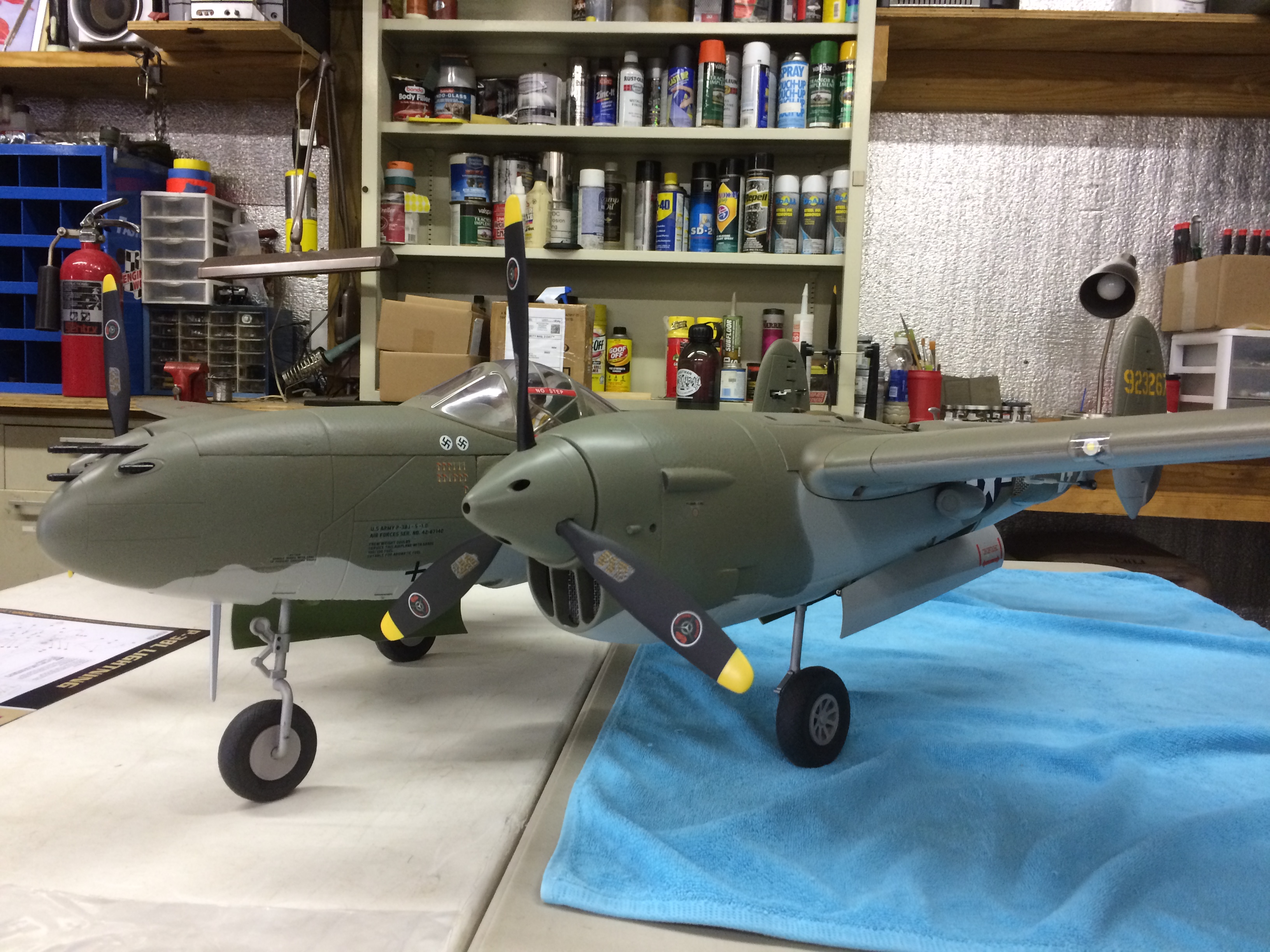

      I primed the spinners and cowls with an alkyd olive drab to cover the yellow, once they dry for a day I'll paint them with the same acrylic paint I used on the nose.

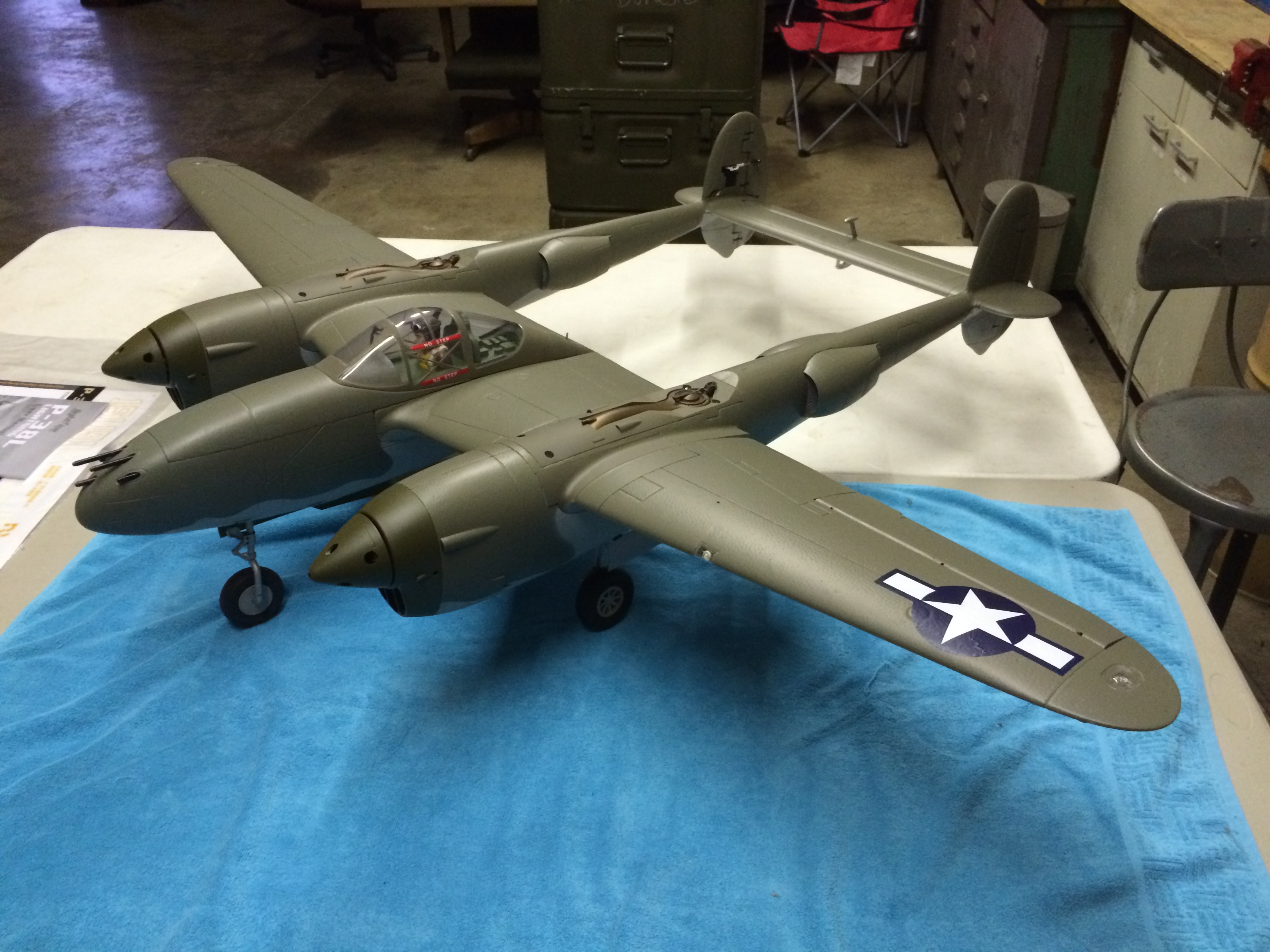

                A little more paint work...and some of the decals modified/applied
                No more yellow, can't wait to get my nose-art done.

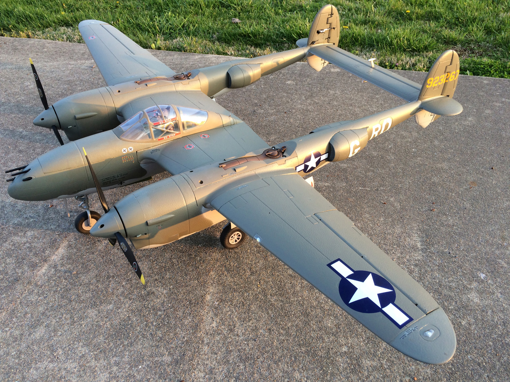

                Had to cover up all that clear plastic.

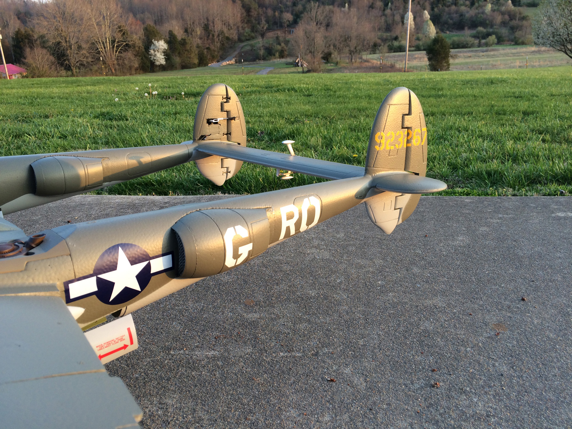

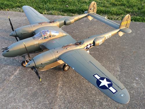

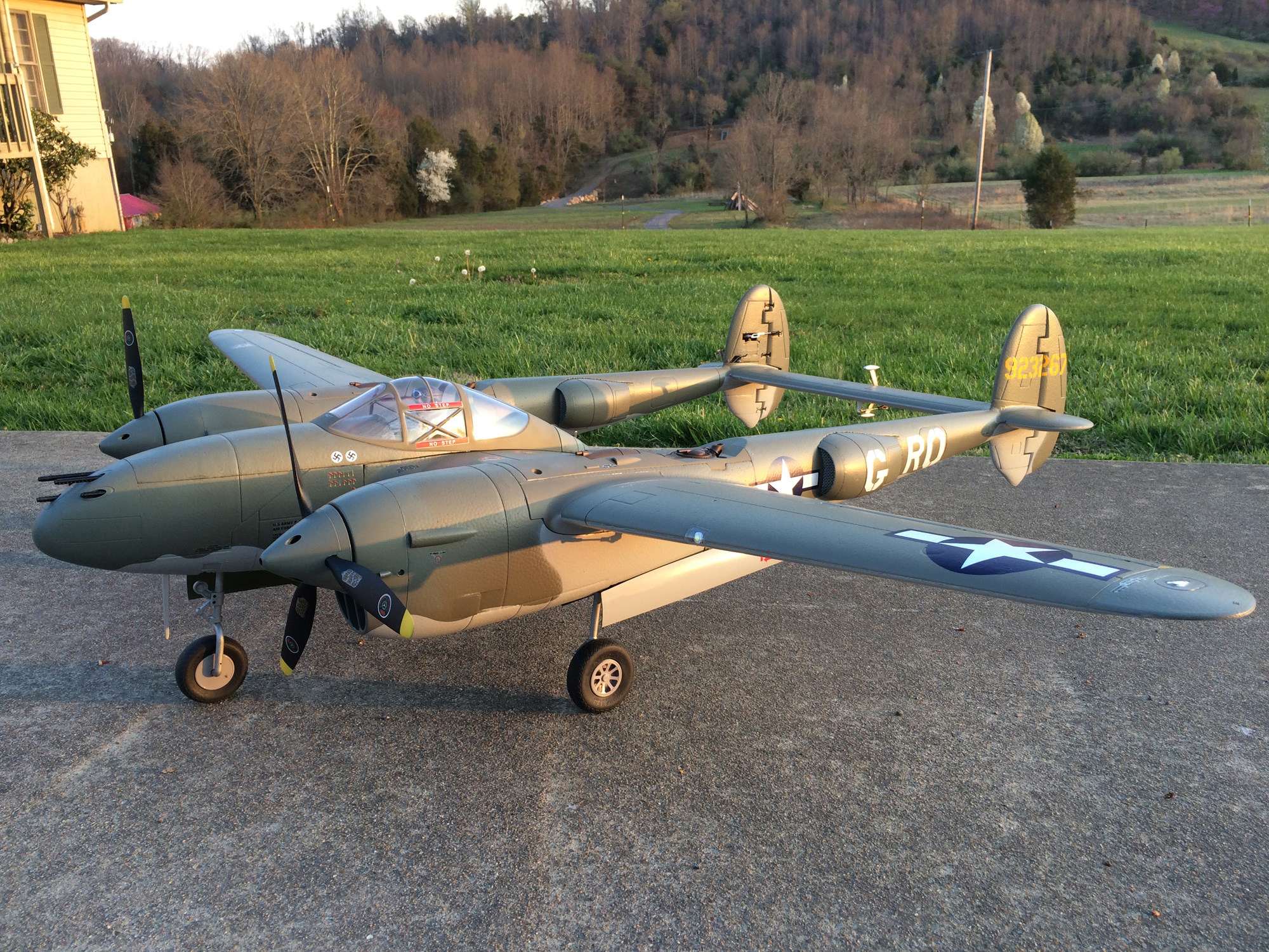

                      Now thats is a good looking aircraft! What did you use for the screens?
                      Kevin
                      Off with one helluva roar!
                      AMA 1085465
                        Kevin
                        He stated it was aluminum screen material. Mine are hard to see (I used black fabric screen material as I had a roll on hand). I think I'll paint mine silver so they stand out a little more.
                          Yes, aluminum screen.

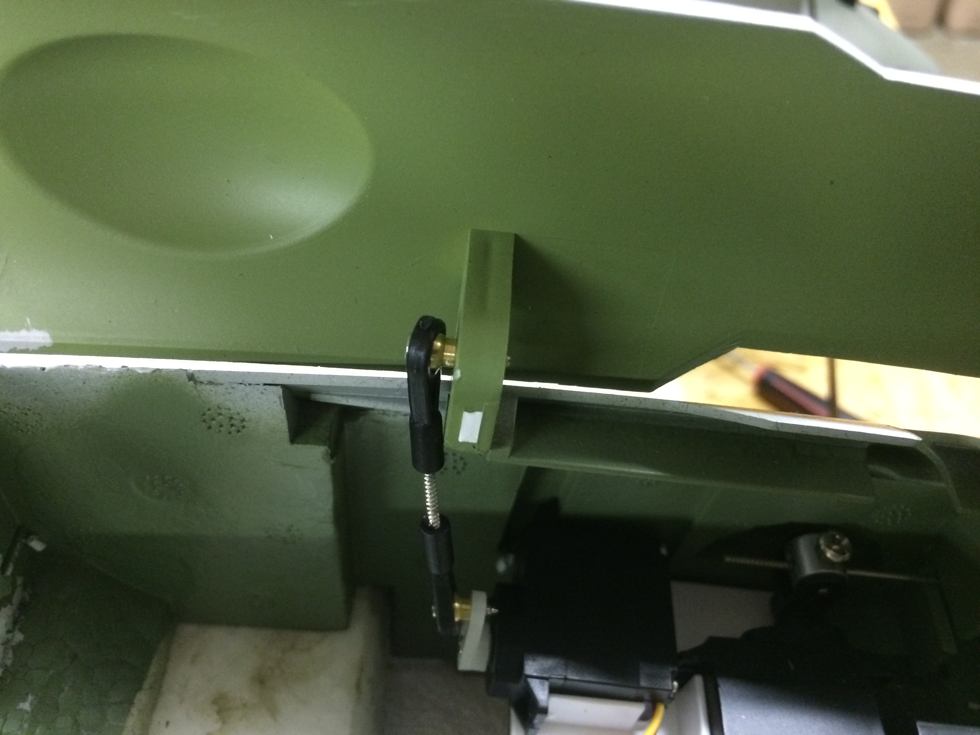

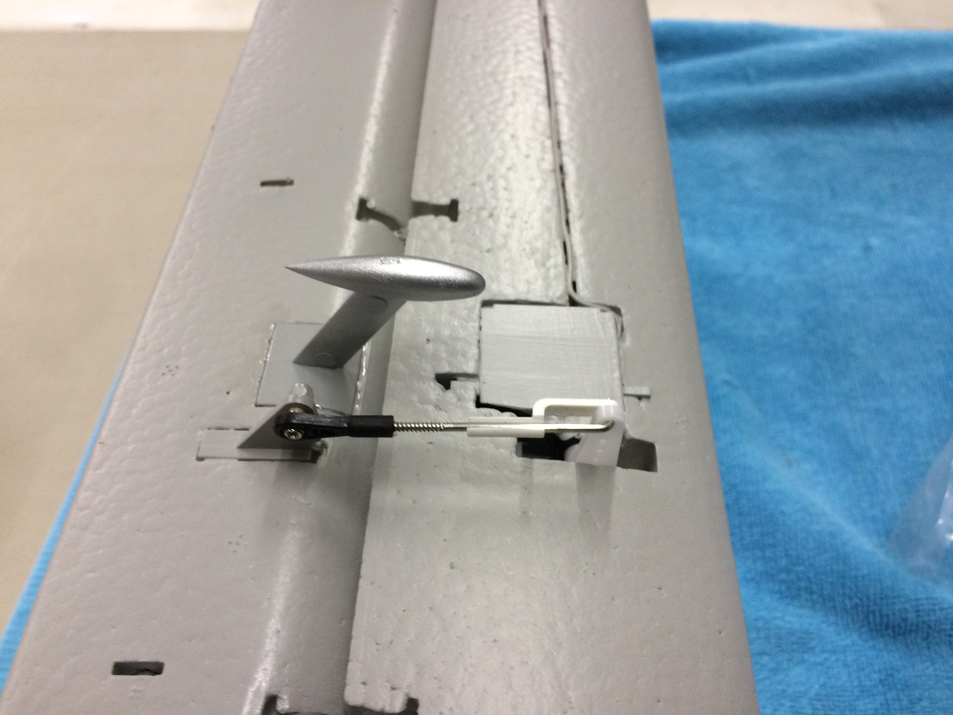

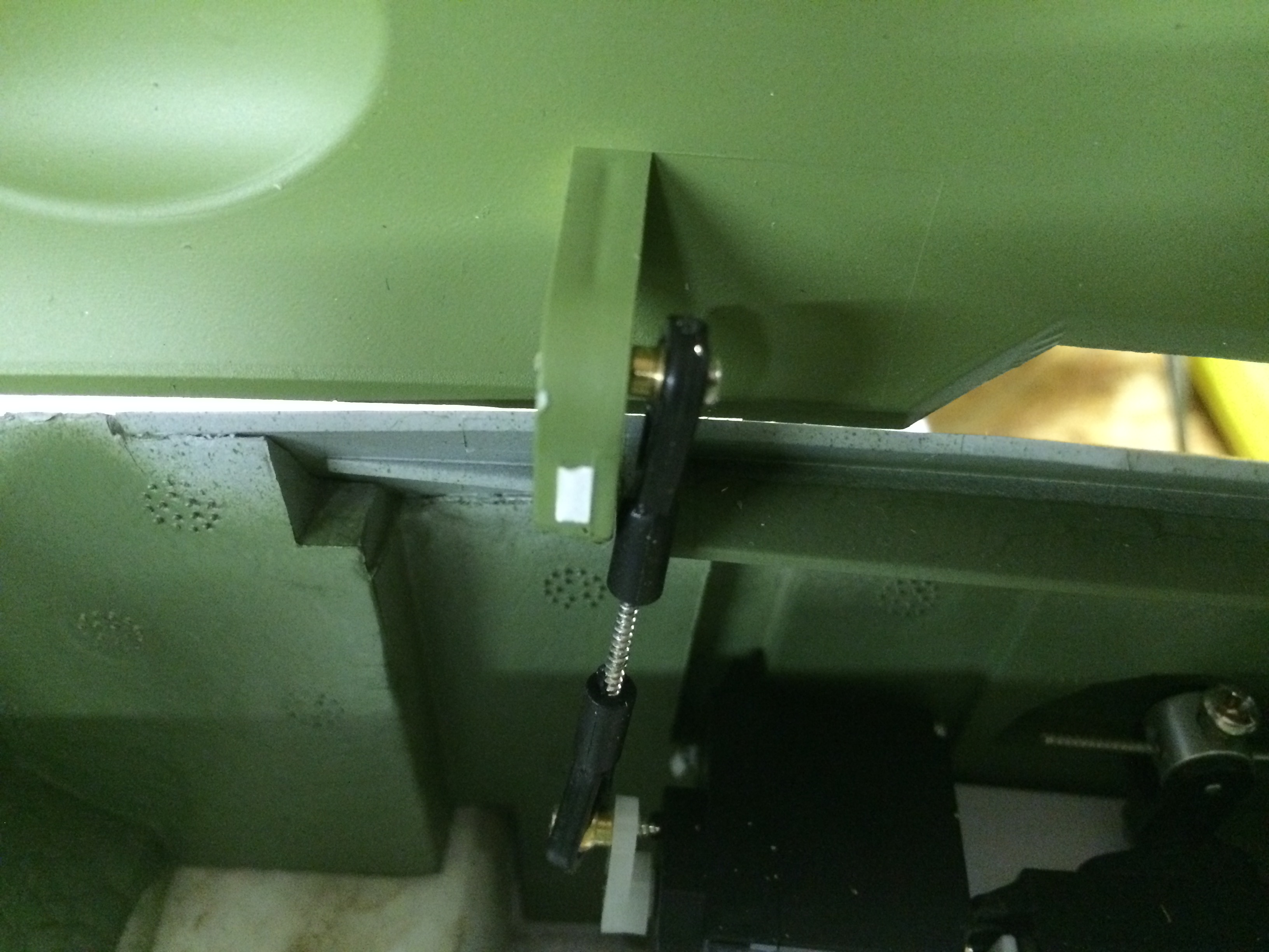

                            I found a solution for getting the nose gear door to shut when adding washers under the rear mounting tabs to correct the rake, if you move the door pull rod to the other side of the mounting tab it will allow the door to shut.
                            Stock position.
                            New position.

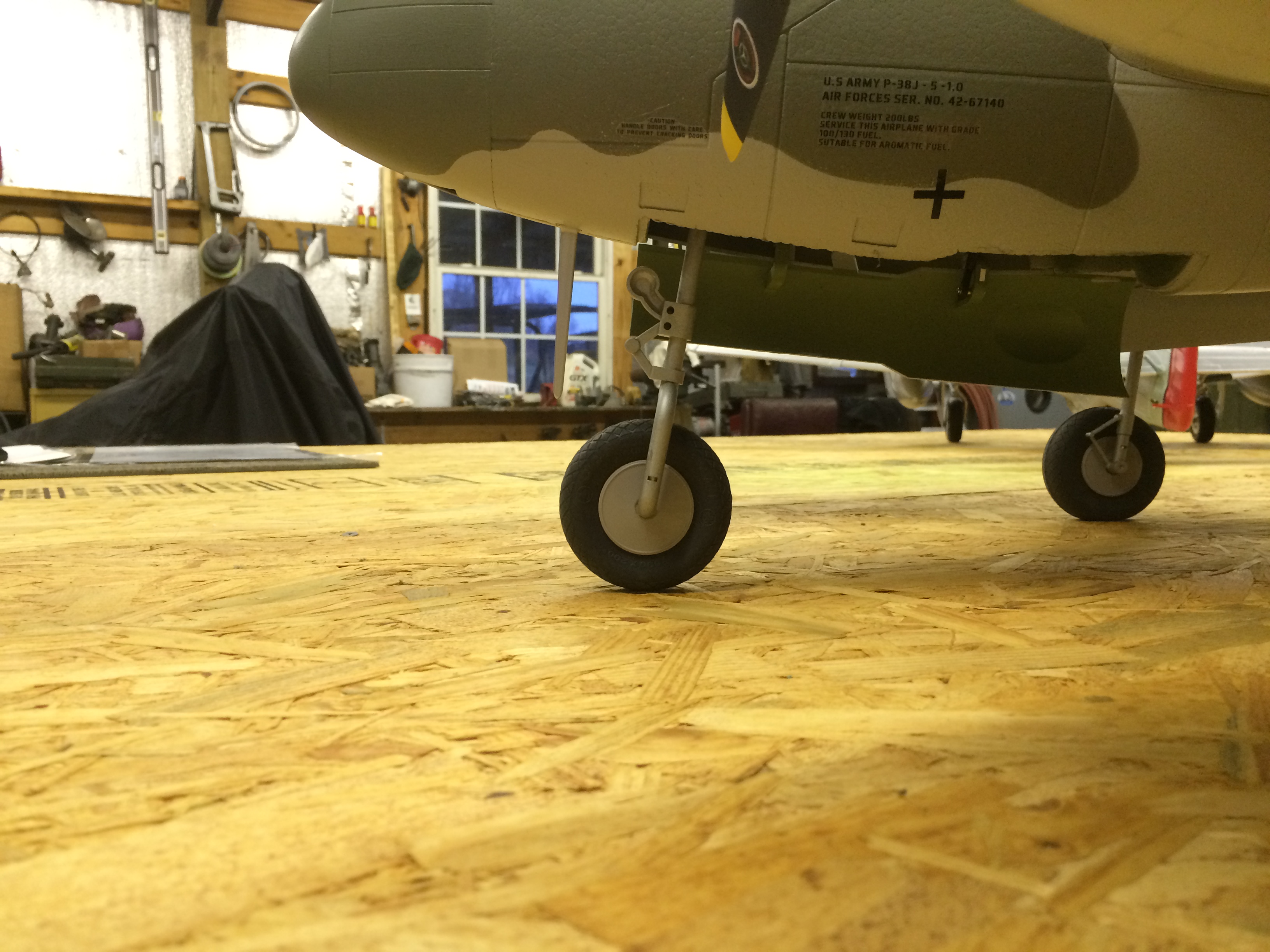

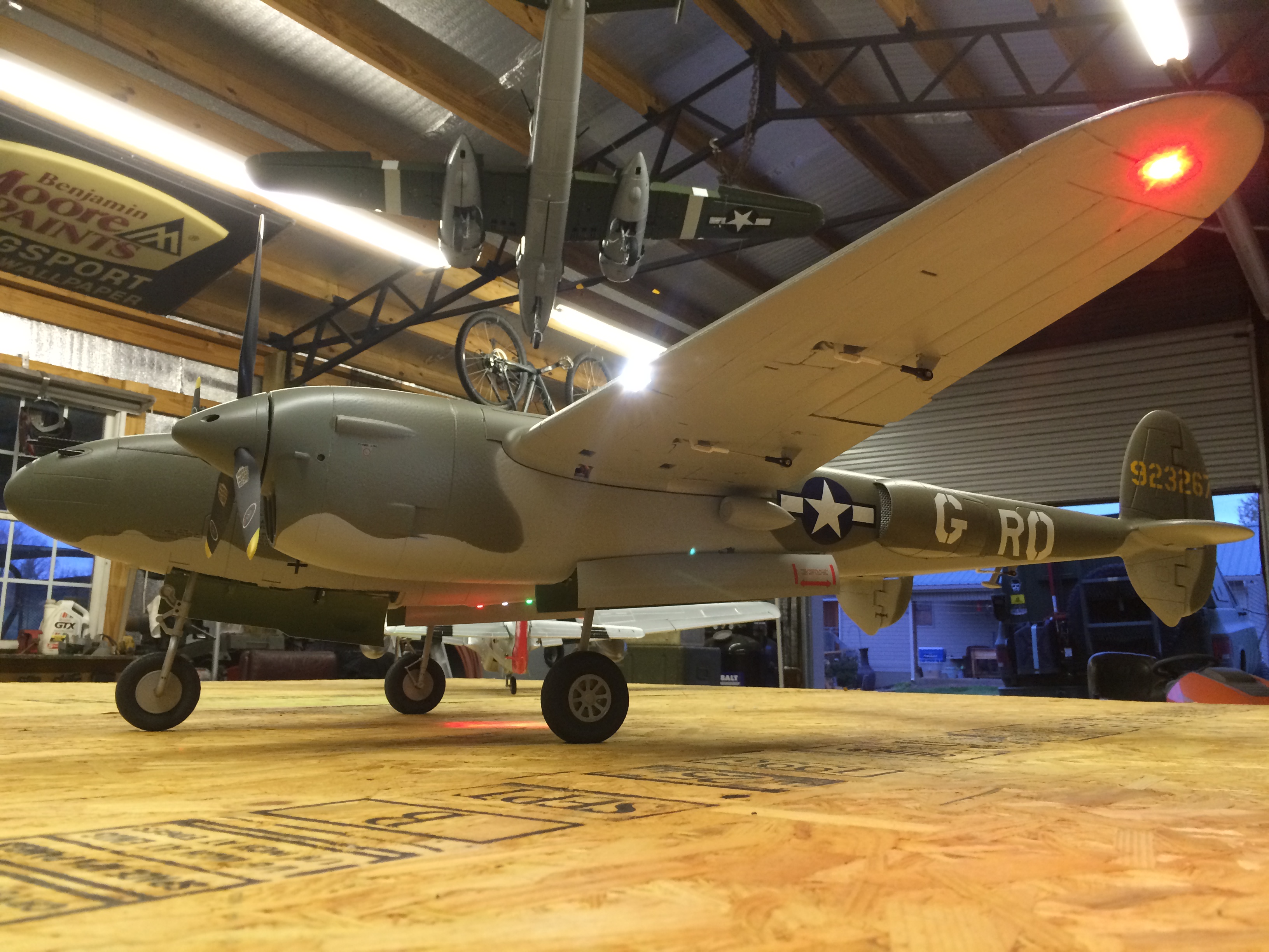

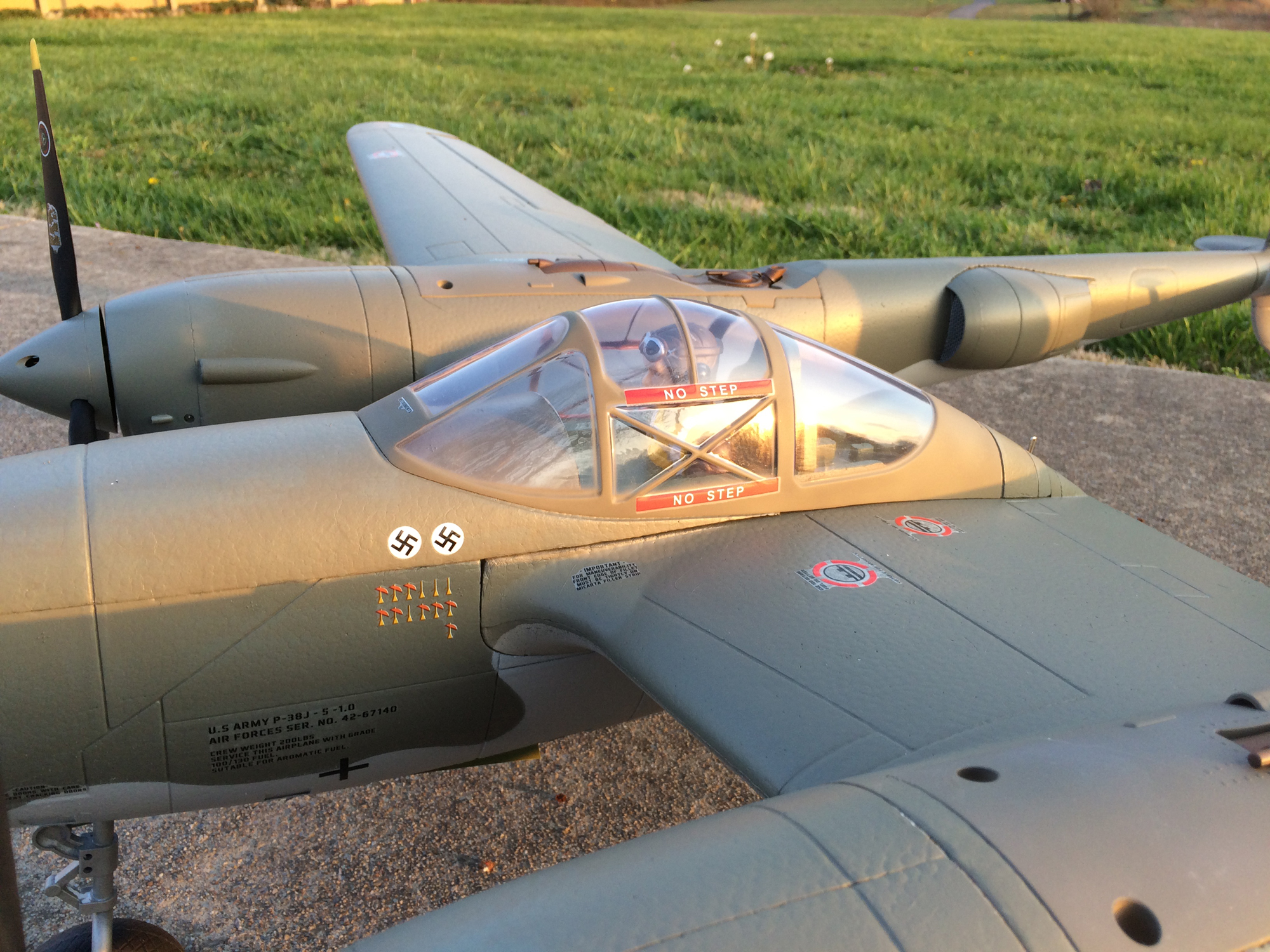

                              I love these lights...
                                • 7383
                                Those are great lights, what are they?
                                  #17
                                  They're stock. ;)
