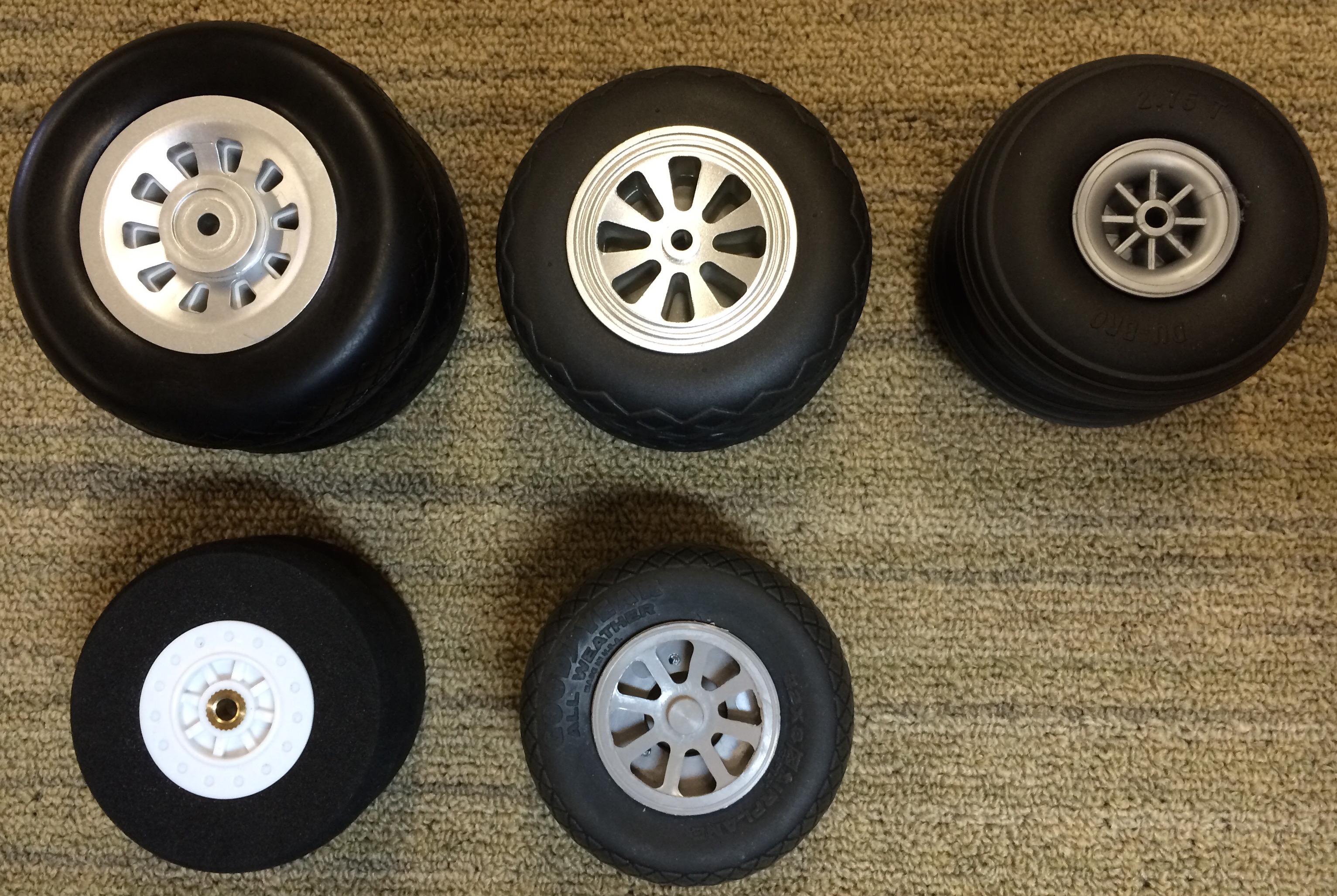

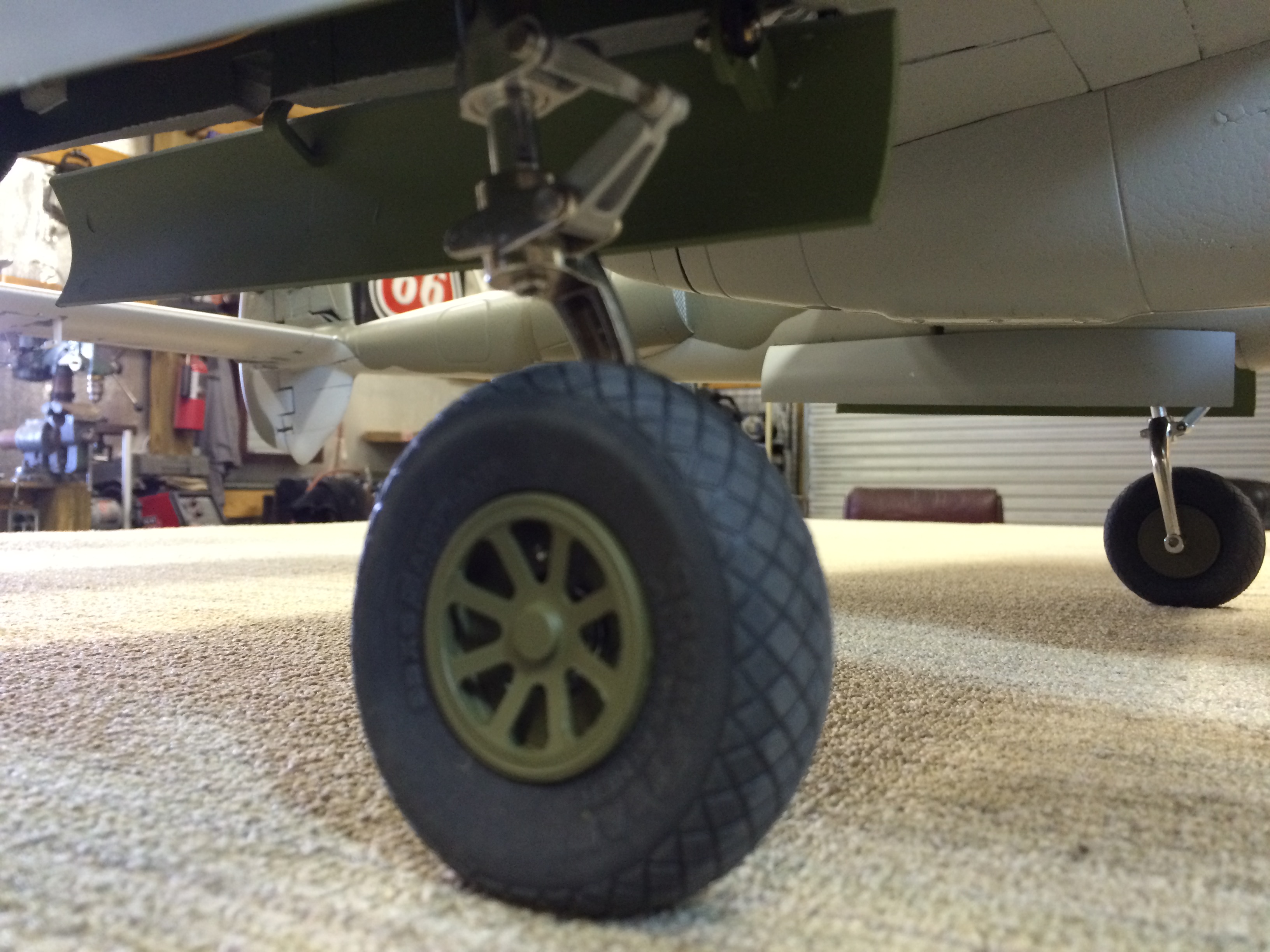

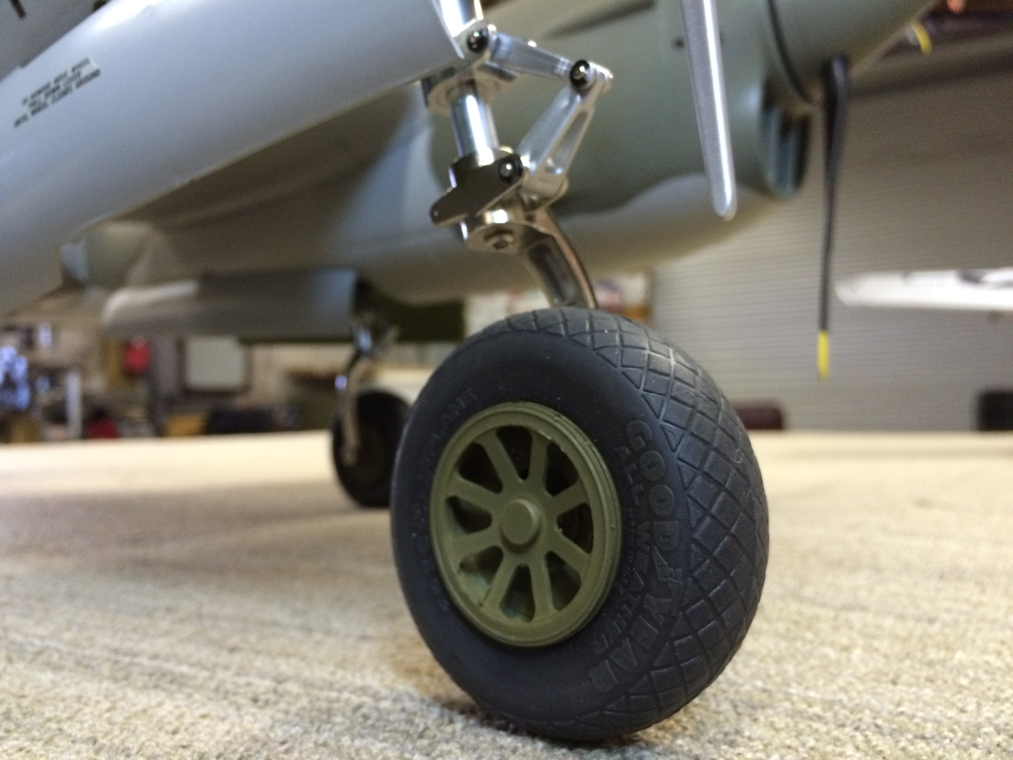

      I finally finished the strut swap and after trying several different wheels I have decided on the Robart 2.75" on the mains and the 2.5" on the nose.

      Very nice detail and texture on the Robart wheels/tires.

        what made you go with those? were the FMS not clearing?
        www.TSHobbies.com
        • #44
          They fit but I just like the detail of the Robarts.

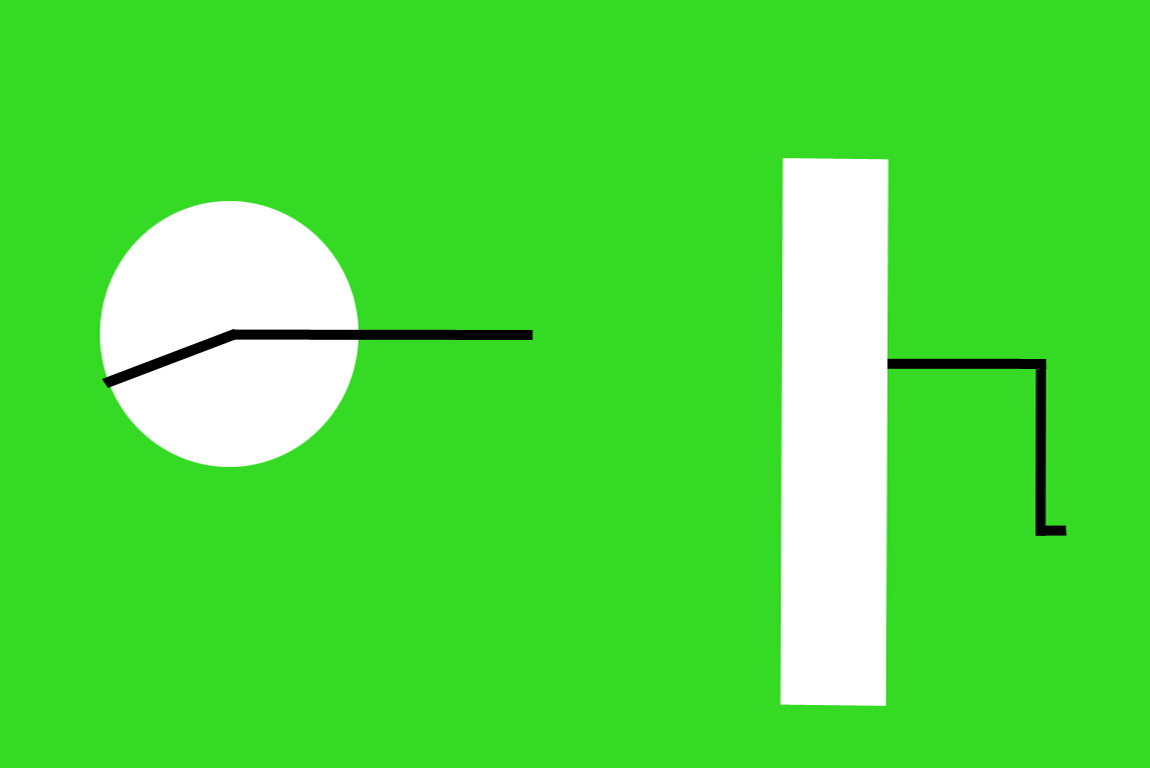

            I'm a little unclear on how you did the nose strut drilling.
            • #46
              Never mind, I get it. Nice work!

                Here you go...

                    Yep I went with the Robarts for the same reason...Love the diamond tread and detail. Now I need to catch up with the awesome oleo strut mod.

                      Alright you have impressed me with your mods...Now let's see if you can take it to the next level... ;)
                      The tell-tale drag struts above the oleo... :)
                      • #51
                        Hmmm......

                          Ok.........I don't quite get the "pin" and it's grooves. I don't have my struts but would you please explain what I'm looking at there.......thanks in advance, Andy
                          • #53
                            You don't need to do that, the pins that come on the struts work perfect. I had taken the struts off my P-51 and the pin stayed in the retract so I made those but replaced them when the parts came in.
