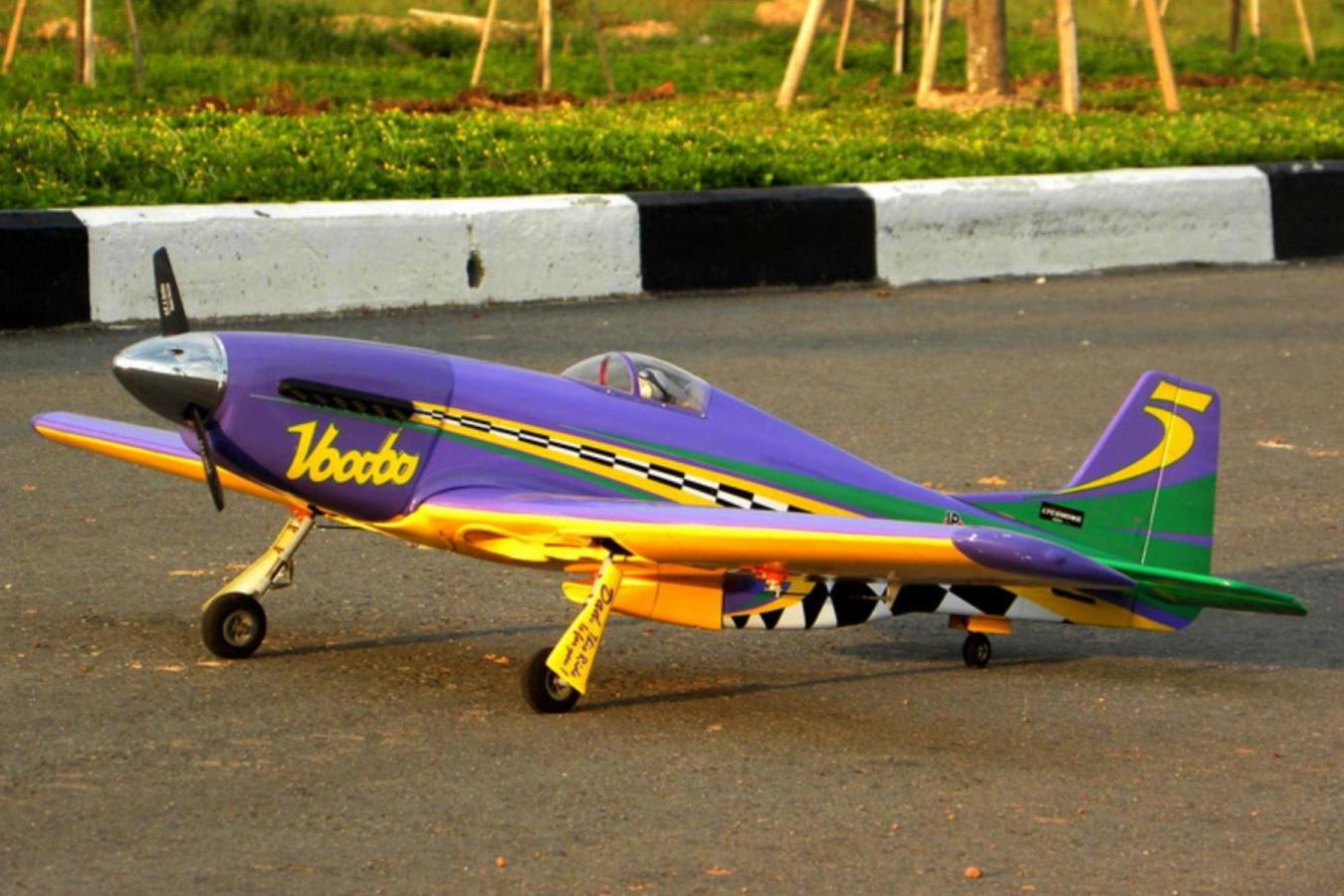

    1 Is the paint match on the production Voodoo cowl as bad as the pictures show ?
    2 And the pictures don't show flaps - do t he production Voodoos/Dagos have flaps ?
          I just got the purple one and the colors match very well.

              I have an original VQ Dago Red and the cowl/fuse color match is 100% perfect. It's a beautiful airplane and flies superb. Very fast with a 5065 motor on 6S. The only thing that could be improved would be the addition of a top battery hatch. I thought maybe these Nexa versions would have the hatch but viewing the photos it doesn't appear they do. However, I can tell you from personal experience it is VERY easy to cut your own hatch. It's as simple as cutting on the forward edge of the former behind the cowl and the aft edge of the former just in front of the cockpit. Then make your two lower cuts on the side of the fuselage at the height that equates to where the "arch" in the hatch ends. It will literally "pop" off in one piece. From there you just add magnets at each corner of the hatch and matching ones in the fuse and it holds in place like it was meant to be that way. It does help to have a little bit of red film covering just to give the edges a more finished look and if you need to snug anything up you can use some narrow black foam tape to close the gap. This is by far the best "Reno Racer" type of P-51 on the market and I'm so glad to see Motion bringing it to us. If you're thinking of buying one don't hesitate. You'll love it. (And don't forget to get the electric retracts. They're a super easy install and really clean up the in-flight look.)
              • #8
                It does have a top fuel/battery hatch just in front of the canopy. The plane was obviously built as a gasser. Trying to fit a 6S battery in the compartment without cutting the rear cross piece where the hatch sits is near impossible. As a nit-pic unlike the photo they do not include decals to carry the side pattern onto the cowl so the side decal stops abruptly where the cowl starts.

                  Yes it does have Flaps

                          Correction to my previous statement about no decals, there are decals, I just missed seeing them in the packet with the rest of the paprwork.
