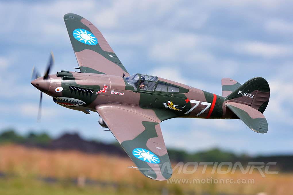

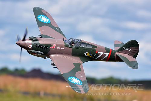

    I am not really a warbird fan but this looks like a cool plane. I have a question for those who own it.
    Do the blue decals come already in place? If not I prefer to leave them off. Looks like a nice flyer. Those low passes look really cool.
    From what I read it does really good on grass which is a plus.

    Hello Jobinseattle,
    The decals on FMS birds are already in place. The Flying Tigers, known officially as the 1st American Volunteer Group (AVG), were a unit of the Chinese Air Force thus the blue Chinese star and the pilots were recruited from U.S. aviators. From late 1941, the P-40B was used by the Flying Tigers. They were divided into three pursuit squadrons, the "Adam & Eves", the "Panda Bears" and the "Hell's Angels. Without the blue star you should also remove the remaining "Flying Tigers" scheme that was emblematic of the AVG. It IS a cool looking warbird but please don't disparage the Flying Tigers by removing just the star because you don't like the look of the Chinese star.

      Thanks, If already there I would just leave it. I like the plane. Watched many videos online and it looks good in the air.

          Before Horizon Hobby became the distributor of FMS a few weeks ago, you could have bought a replacement fuselage and wing at a decent price. They don't have the markings applied. Now that Horizon is involved and the prices have been jacked up, it's no longer worth the expense.
          The AVG P-40Bs came from aircraft that were being built for the British. Consequently, they are in a British camouflage scheme using DuPont's version of British colors. Curtiss used rubber templates to apply the camouflage. The templates even had cut outs to assist with the placement of the standard British markings.
          You could always put British markings over the Chinese markings on the wings (they are the same size), buy a replacement fuselage, and now you have a RAF Tomahawk. Or you could take it one step further, paint over the Dark Green with Middlestone, and now you have a Desert Air Force (British/Australian/South African) Tomahawk.

            My main gripes with it are about the decals. Mine aren't on very straight and the eyes shouldn't be slanted at a 60 degree angle.
