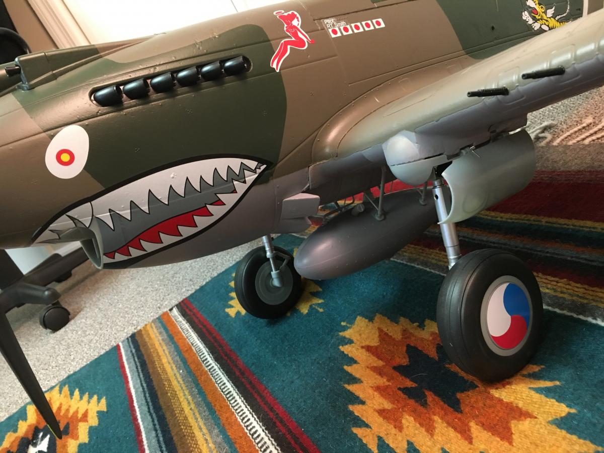

                                    Yeah, I hear you, I got rid of the yellow pupils in the eyes as well, and I agree that the slant isn't enough, they're almost vertical!
                                    The one thing I really didn't like was the Tiger emblem, they got that wrong. I had Callie make me new ones that are much more accurate as you can see from the before and after picture.
                                    As for the stock ESC, from the spare parts page, it will handle a 5s battery, so I'm thinking that route as well.
                                    Wow, I didn’t even notice the tiger but you’re right on that color. Yuck. I’ll get Callie to make me up some. She made my wheel covers for me.
