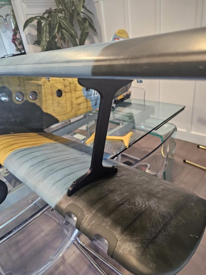

              We are close to the maiden. Unfortunately, the wing struts do NOT fit, not even close. Black Horse is supposed to be making me new ones and shipping them from Vietnam. I can't wait that long, so I CAD and designed my own and 3d printed them out of CF PETG and they work and look great.

                Here is my wing strut printed in CF PETG. Stock struts are 37g, this is 47g, negligible and super stiff but still provides slight flex. They should be more than adequate.

                  I've attached the STL for the brace. 2 identical prints will work, or if you are OCD about the plate side of the print facing the outer or inner of the plane, you can flip on X or Y axis in the slicer.

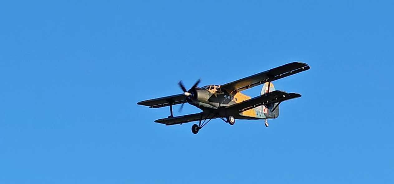

                        We have successfully flown this AN-2. We got 2 flights so far. The plane flies more easily than expected. Only some minor trim needed. My 14 year old son is the pilot. He said it was quite boring to fly, which I guess was a good thing. He also almost always exclusively flies EDF's the last few months. The first flight was a quick 2 lap shakedown. We set the plane up with slightly more throws than suggested, as we always do that, to make sure we don't get in a position where we don't have enough elevator authority etc...
                        The only major knock is that the landing gear is so stiff that it's hard to avoid a bounce on landing. I'm not sure what can be done about that. The 2nd flight, he landed it quite smooth with only a very minor boune of a few inches.
                        We did the stock CG. I used an angle sensor to get the plane level with about half a degree. I zip tied a 2200 3s battery up inside the tail wheel assembly to achieve this, I think it was about 170g. I custom 3d printed some modular battery trays designed specifically for two 5000 packs. We will be using 7000 packs next. I will attempt to design and print those mounts to achieve the CG without the battery in the rear.
