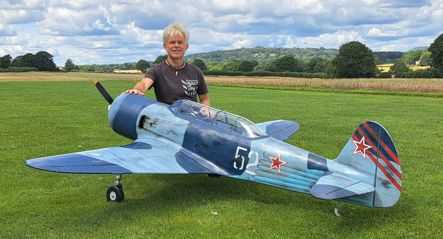

    I Live in the UK and purchased one of these beautiful Yak's in April this year. I decided on an electric set up with a Dualsky GA6000.9 160kv motor on 12s driving a Falcon 25x10 scale prop.
    As usual with Black horse models a fantastic kit and went together very easily. Upgraded the pilot to a Russian 1/4 scale 'WarbirdPilot" and changed the wheels to nice aluminium scale wheels with bearings. Again being Black Horse, she flies on rails, looks fantastic in the air and the sound of the prop.....just like the real thing. Landing and taking off no problem. With both half and full flap no elevator adjustment required. Would throughly recommend.

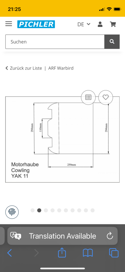

          hello andrew, do you know the diameter of the cowl? no info here in the usa if a saito 90 will fit without modifications? hopefully blackhorse finally got this right on this model and made the cowl over 250mm diameter?

            Hello please find attachment with the cowl dimensions hope this helps

              Here you go

                Ums 100 swims in the cowl, saito fg90r3 fits as wel

                            Question. Does anyone know what's the diameter of the cowl?
