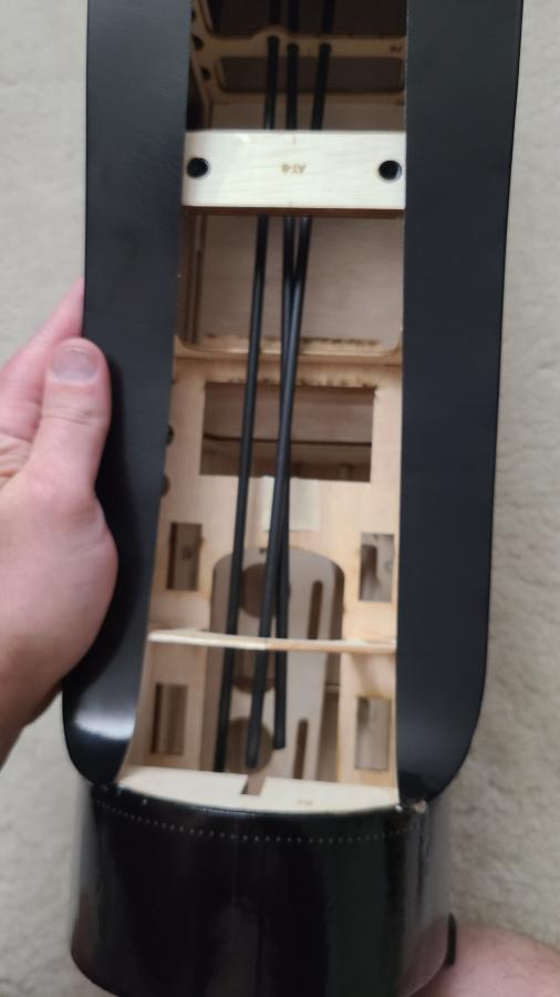

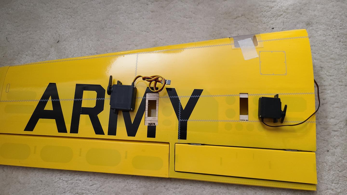

ID:	393258I received mine today. There are discrepancies on the website compared to the box. One is flying weight. Box says lighter at 5.7lbs 2600g. Website says 3300g without battery.
          Other discrepancy are the servos. Flaps have 3 separate sections requiring a mini servo in similar size of the hitec HS 82mg each. The ailerons have a hole for a larger mini servo similar in size to the recommended hitec HS 225mg which is larger than the 82mg. However you can trim the aileron holes to take a full size servo.
          In the underside of the fuse go up to 3 full size servos, 2 if running electric for rudder and elevator.
          The electric retracts you can order are with wire struts. There was no picture. Had I known that I may have looked for another option. It does come with strut covers that help hide it.
          Let me know if you have any questions or want specific pictures. I can take them after work tomorrow.

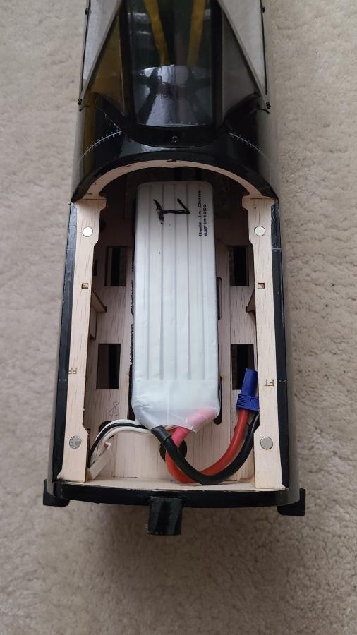

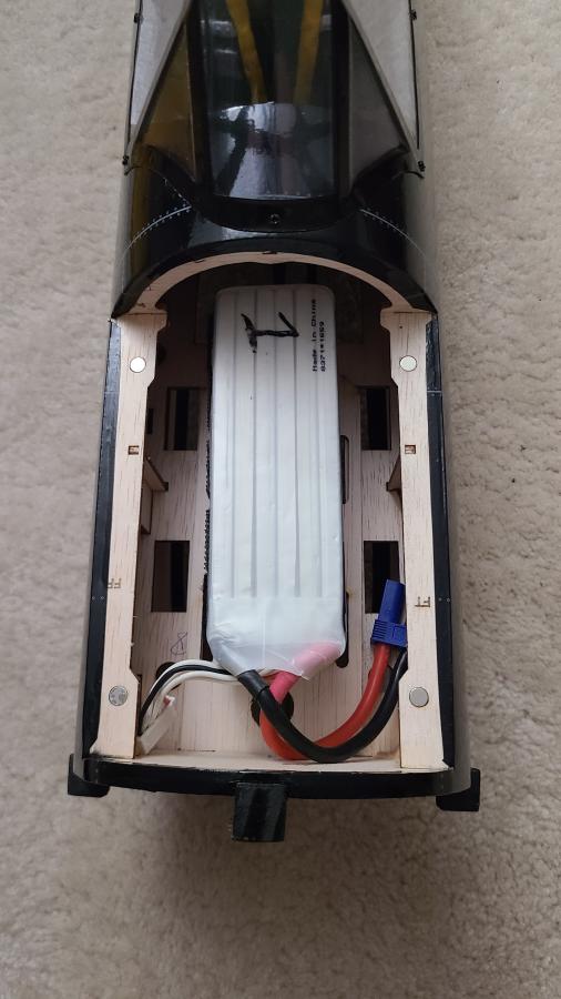

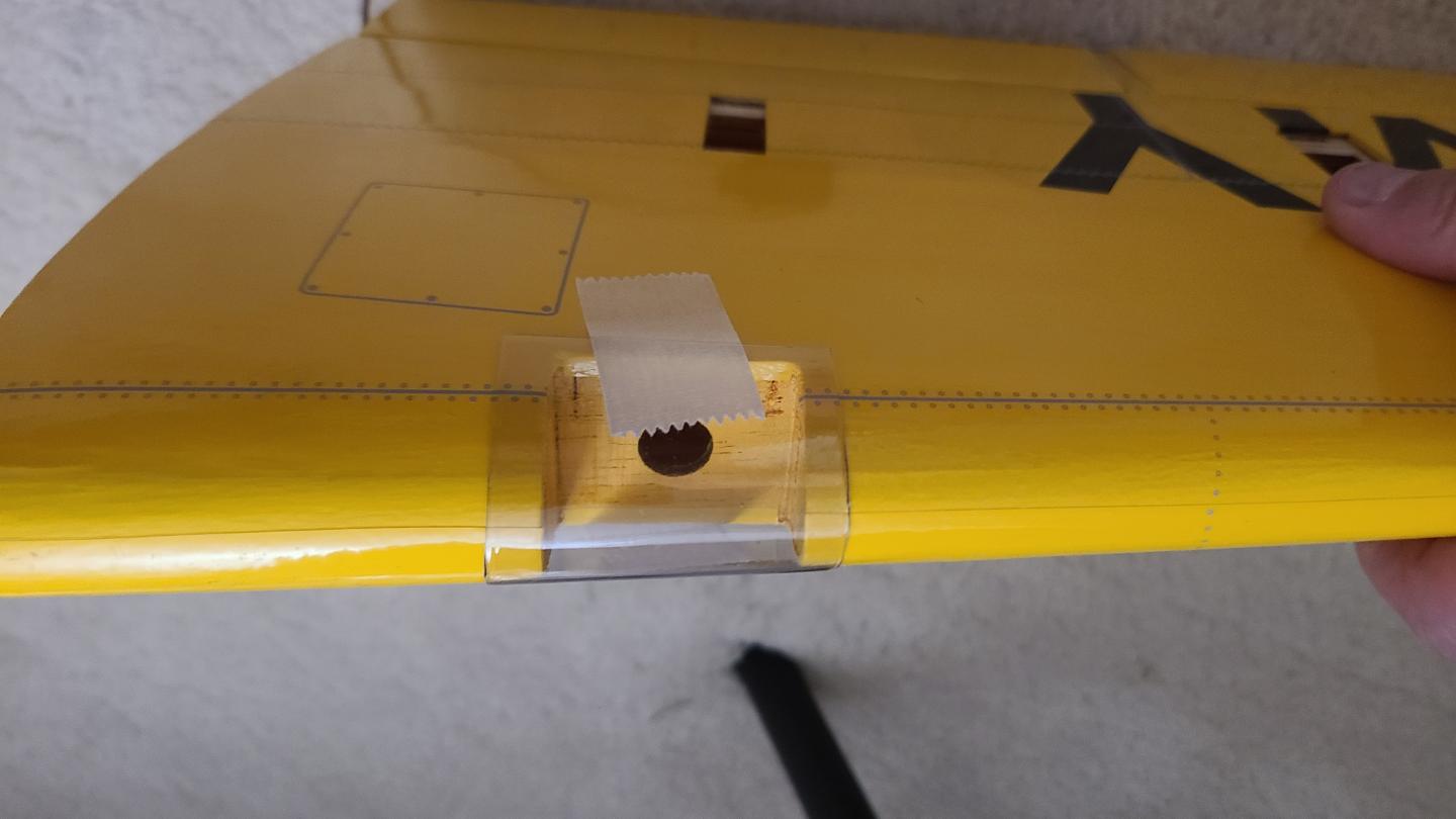

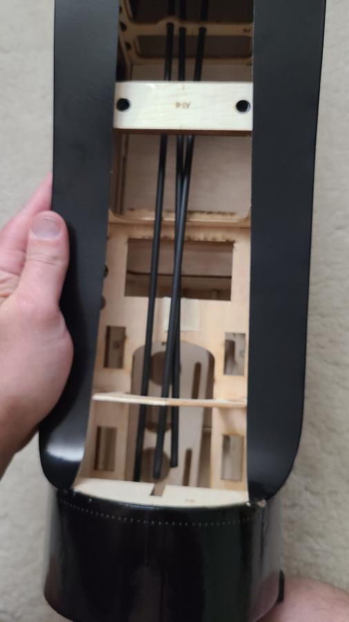

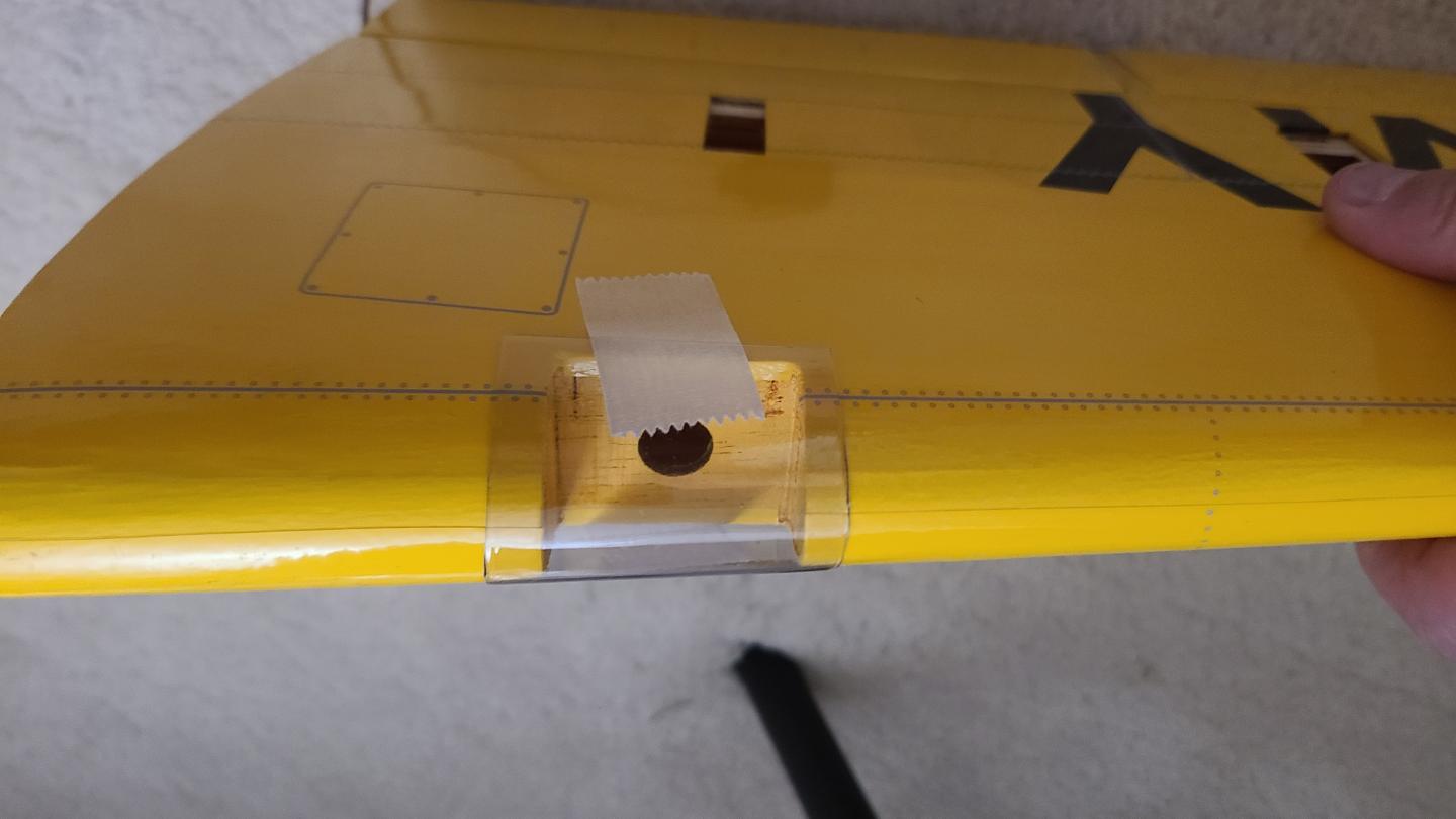

              Here is a few more pictures. Battery in the fuse is a roaring top 6s 3700. It has to be laid on it's side or the hatch won't close.
              Servos on the wing is a full size hitec D645mw on the left at the aileron and the hitec hs 225mg next to the flap cut out. That servo is too big without decent modification. I'm going with a smaller servo for the flaps.
              It does have a space for lights in the wing. Click image for larger version

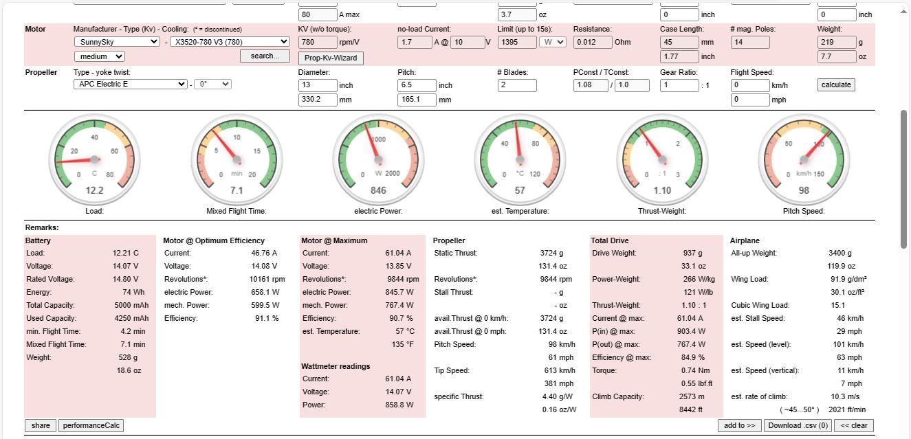

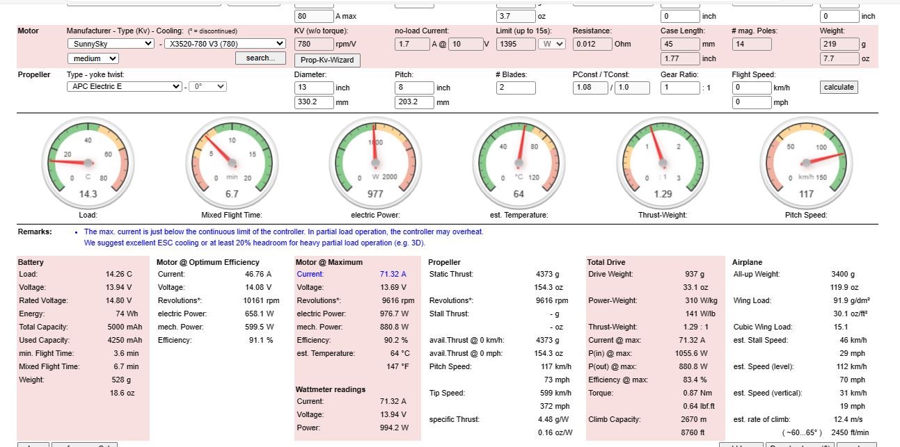

                      If I bought this plane, I would have planned on using a 6s, but based on Fall guy's input, that isn't going to work out well. Just for grins, I ran ecalcs using a 780kv (close to 770kv), 4S using a 13x6.5 APC prop. The numbers look very good. I then ran it for a 13x8 prop. The numbers look great. If anyone is looking for potentially more top speed (sometimes it just isn't there due to drag) and certainly more vertical, I would recommend the 13x8 apc with the suggested setup.
                      I've been using ecals for a couple of years, built many ARF planes using the data, it's an excellent tool. It' s not perfect, but it will get you real close and keep you from making a big mistake.
                      Here's a summary of the data for those who care about this sort of thing.
                      • marty 72
                        • May 2021
                        • 36
                        Here's the 13x8 prop.
