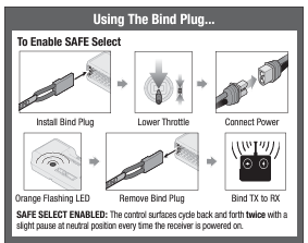

          Suggest rebinding in this manner. Then move the model around to observe control surfaces.
          If still not working you might delete the model in your transmitter that add it back and bind as shown above. This would enable safe always until you put it on a switch. ​
