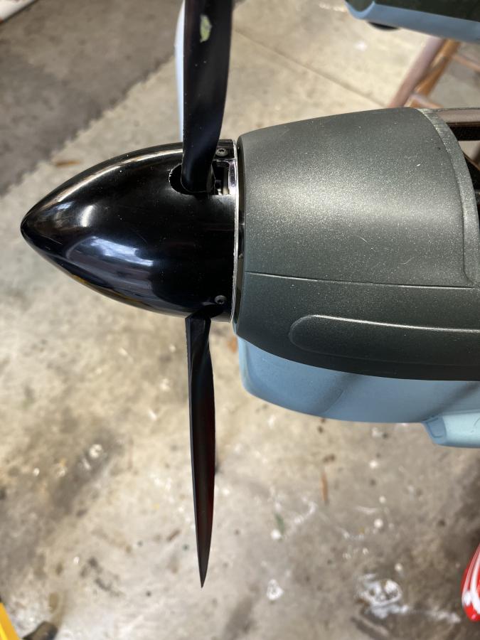

                Still assembling the 98” HE 111. Some tips. The specs call out for 19” propellers. Physically too big. 18”maximum.

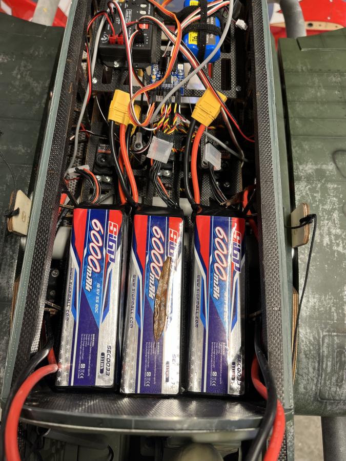

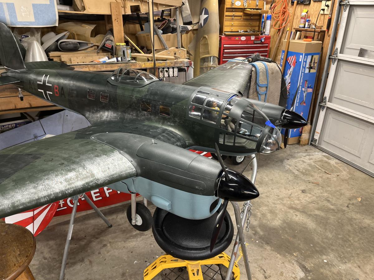

                                The cg for the smaller Blackhorse 111 is also listing 130mm in the manual and the same number is in the big one. The big one also comes with a cg sling that puts the ch at about 175 mm from the leading edge.
                                mine with the GP26 motors and 4 5s 6000 packs balances just about right on the sling. I may move the ESCs as far forward as possible in the nacelles.

                                    Three batteries fit side by side with room for #4 on top of them.

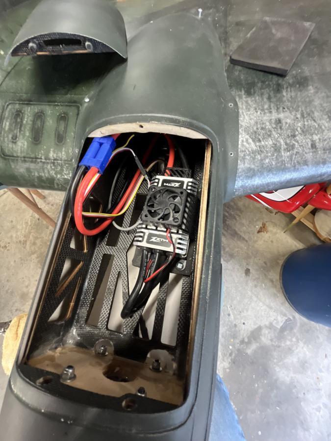

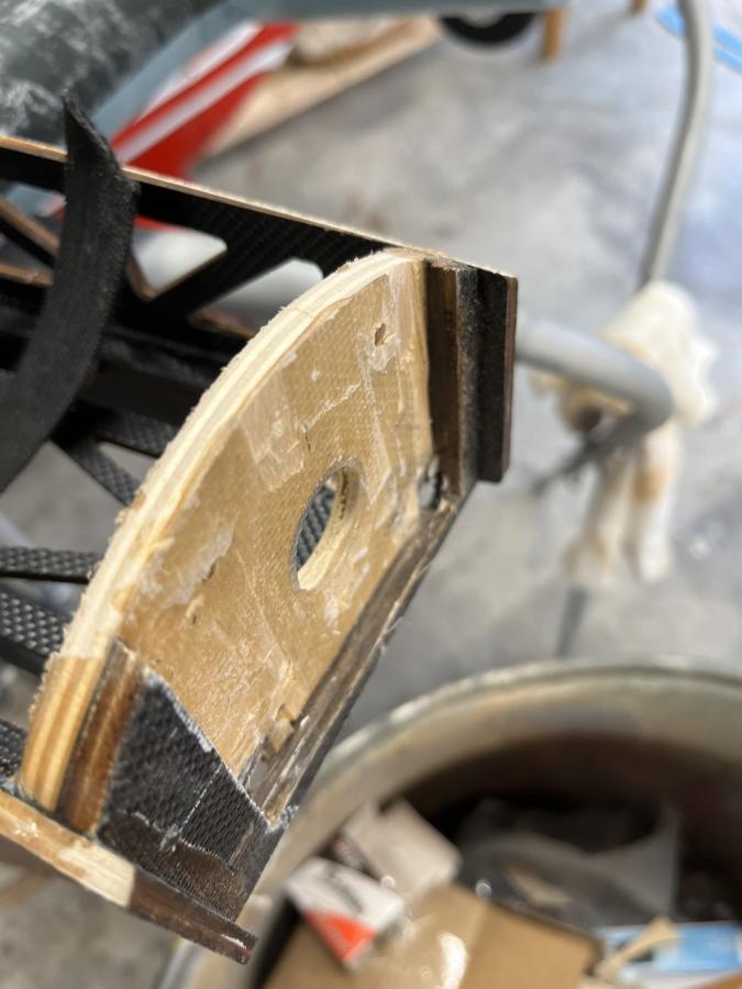

                                      I found the original firewalls to flex under load from the motors so I doubled them up and recessed the mount to get better spinner clearance.
