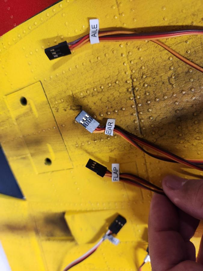

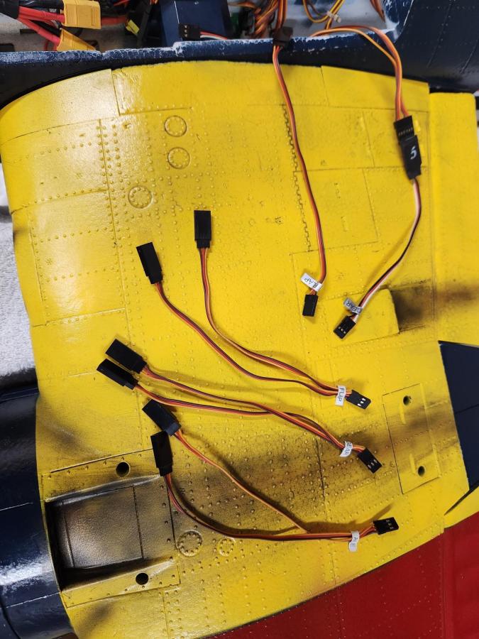

    Just getting back to the hobby after a break and I acquired an FMS F7F Tigercat. I looked for an official thread but couldn't find one. Anyway, I got this bird on trade 2nd hand and when I got it a lot of the stock connections/wires were disconnected so I am trying to figure out how it all goes back in.
    I've managed to get the ailerons, elevators, throttle and rudder working but for the life of me I can't figure out the flaps, gear retract and doors. I have three "Y" harnesses left over and I can't seem to figure out where they go. I'm assuming everything hard wired to the board goes into the receiver. I have two of those labeled FLAP/CHAN5 and GEAR/CHAN6...those go to the receiver, I guess?
    I have a black/red/white from the nose that I assume plugs into the board somewhere for the nose gear retract.
    And again, I have the three "Y" harnesses that have labels on them for GEAR, FLAPS and AILE out of all things, but I have the ailerons working and don't see how I'd have a harness for that since they are run through the connection ports in the wings then to the board from there.
    I have four open posts on the control board for channels 5 and 6, and the two wires coming off the boards that are labeled as "plug for landing gear doors" that has that splitter on it with a "5" and then one labeled as "plug for worm-gear retract servo".
    It is all very confusing. Can anyone help?

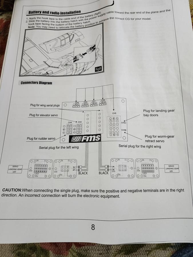

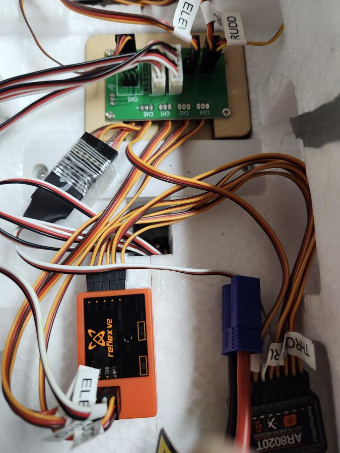

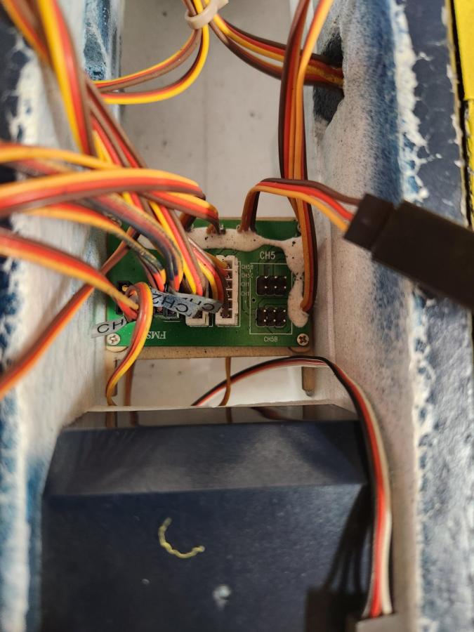

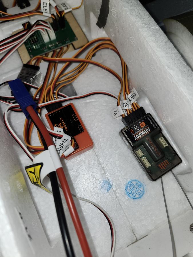

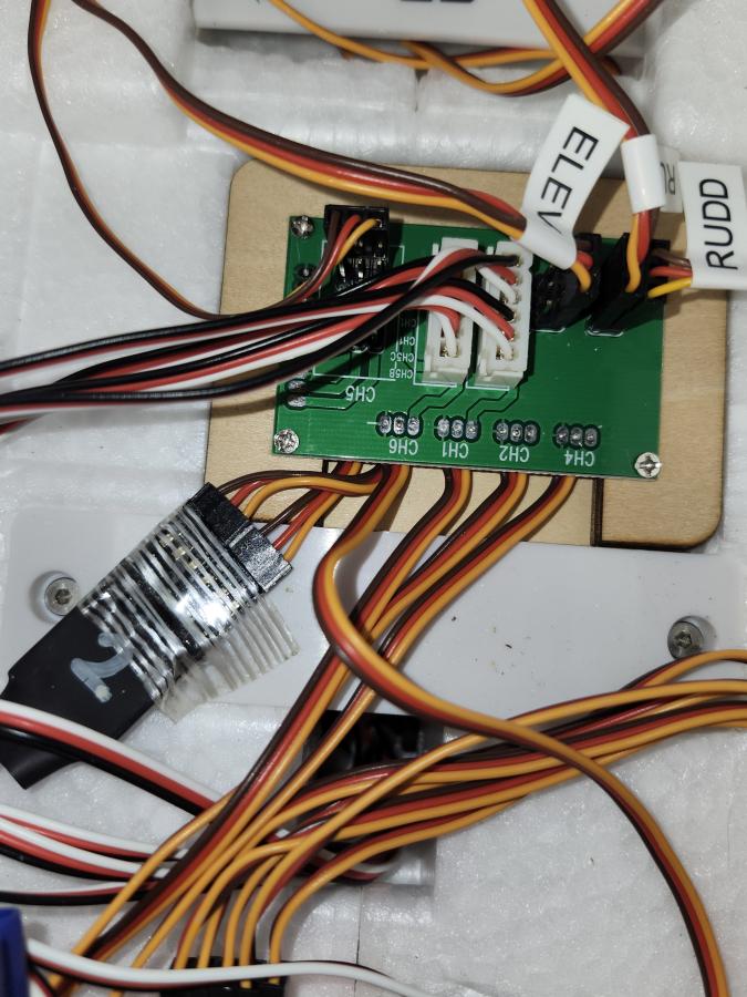

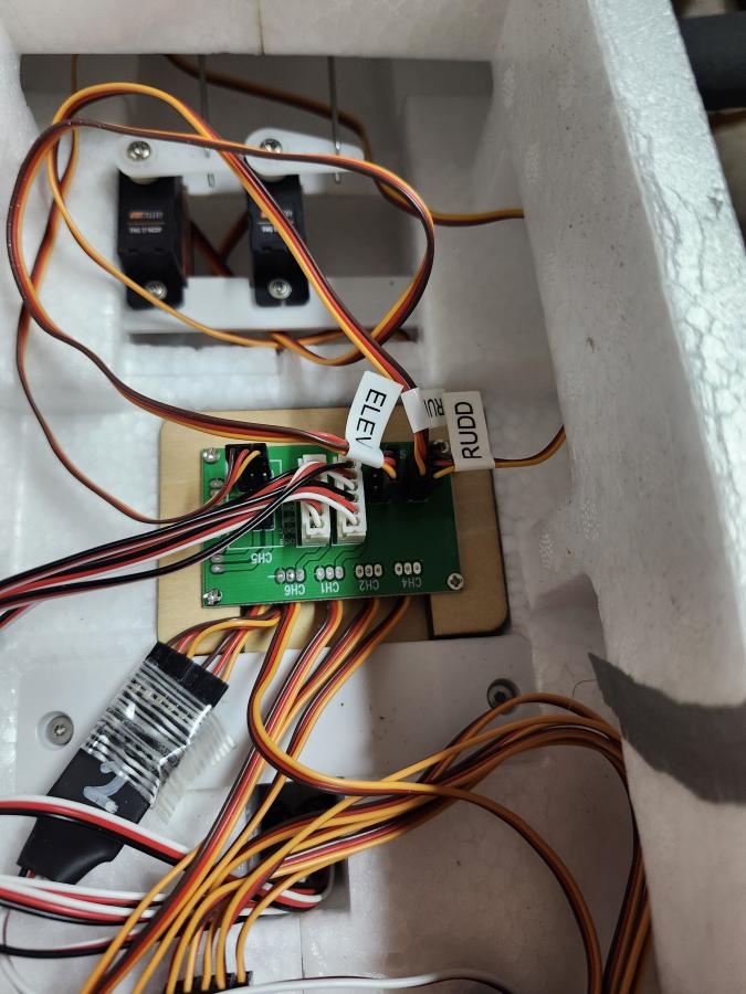

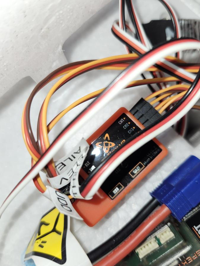

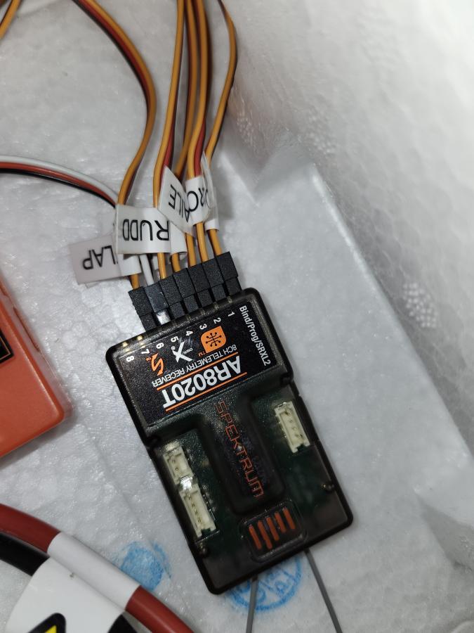

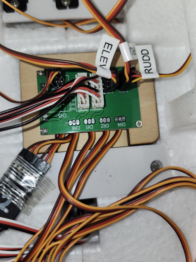

        Splat here is a pic of my FMS 1500 P47 manual showing the board. Als if this works are pics of my set up inside.
        The only difference should be your 2 motors to my 1.
        the manual shows the board hook ups and where they go from the board. The pics show the gear and gear door delay electronics has a 2 on it.
        The only thing I can think of where you would need Y connectors is for 2 batteries if you require 2 and of course 2 esc's .
        Let me know if you see something in the pics and I can give more detail for you.
        Cheers
        ​​​​​​​Bob

                In the meantime I did some troubleshooting and I think I have a bad door sequencer switch (black covered dual plug in thingy with a number 5 marked on it and a GEAR marker). I used one of the Y harnesses that I had...I swear the others didn't come with the plane because they don't go to anything...and hardwired the gear (by passing the doors) and the gear worked fine. I took the main gear doors off because hey they are just cool factor for looks and I don't need them or feel like sinking more money into this project. Everything works now, enough to fly her so I might just call it good lol. Not worth the frustration.
