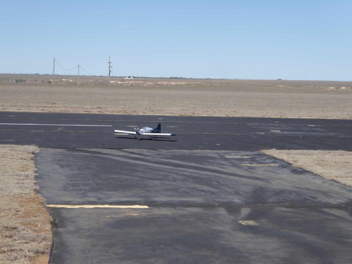

            Maiden my Maracana on March 16, 2025. It needed a little down and left aileron trim, but no surprises. The plane flew well with a .55 2-stroke at 3700' ASL.
            Well packaged, well designed plane, went together fairly well. Only problems I had were (1) needed to sand the main wing joiner to get it to fit in each wing, (2) the landing gear/wheels gave the plane about a 4 degree up stance. There was no way to adjust the gear so I installed a smaller nosewheel to reduce the up stance to about 2 degrees.
            Taxiing in after maiden flight

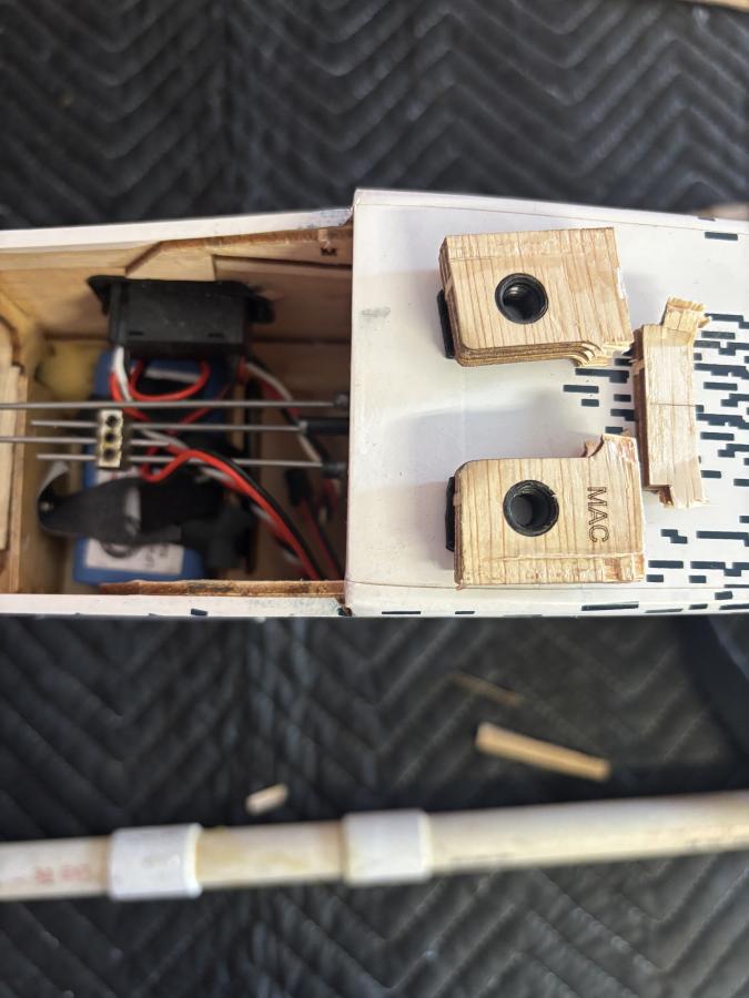

              I have 22 uneventful flight on my Maracana since March, 2025. After landing a couple of days ago, I was taking the plane apart for transport. When I took the wing off, the wing bolt mounts just fell into the fuselage. Later at home, I picked pieces out and set them on the bottom of the fuse for the attached picture. I have totally rebuilt the wing bolt support area since then. I have been using a small electric drive screwdriver to screw the wingbolts in place. I use about the same amount of toque on these bolts as on the bolts of multiple other ARFs. There did not seem to be much glue in the area.
