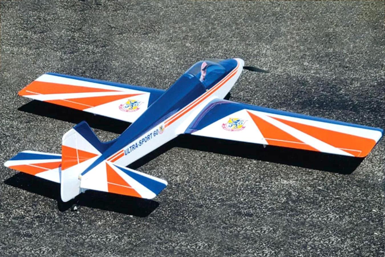

                  • #10
                    Incidently, the lead photo in Motion's Taipan listing is an Ultra Sport 60 built by a modeler here in the US from a Great Planes kit. Look carefully and you can detect the dihedral in the wings and the fuselage to wing fairings, which the Taipan does not have. They even borrowed his color scheme, but of course the Taipan does not come with the RCM magazine stickers.

                            The main photo and a couple of the detail photos are actually the US 60 I built using a Balsaworkbench short kit and RCM plans from Outerzone.
                            The wing was built, per plans, with a flat top. The only dihedral comes from the rib taper on the wing bottom.

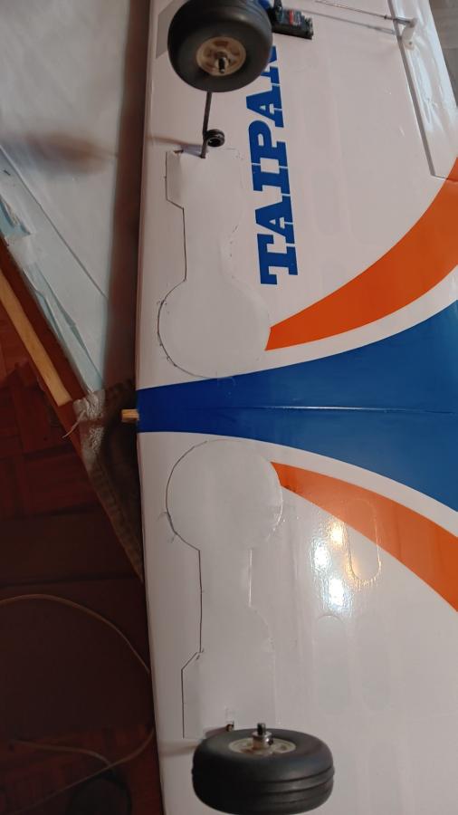

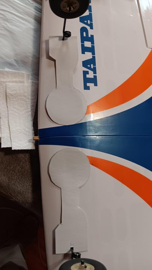

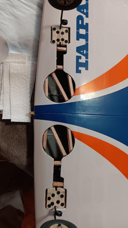

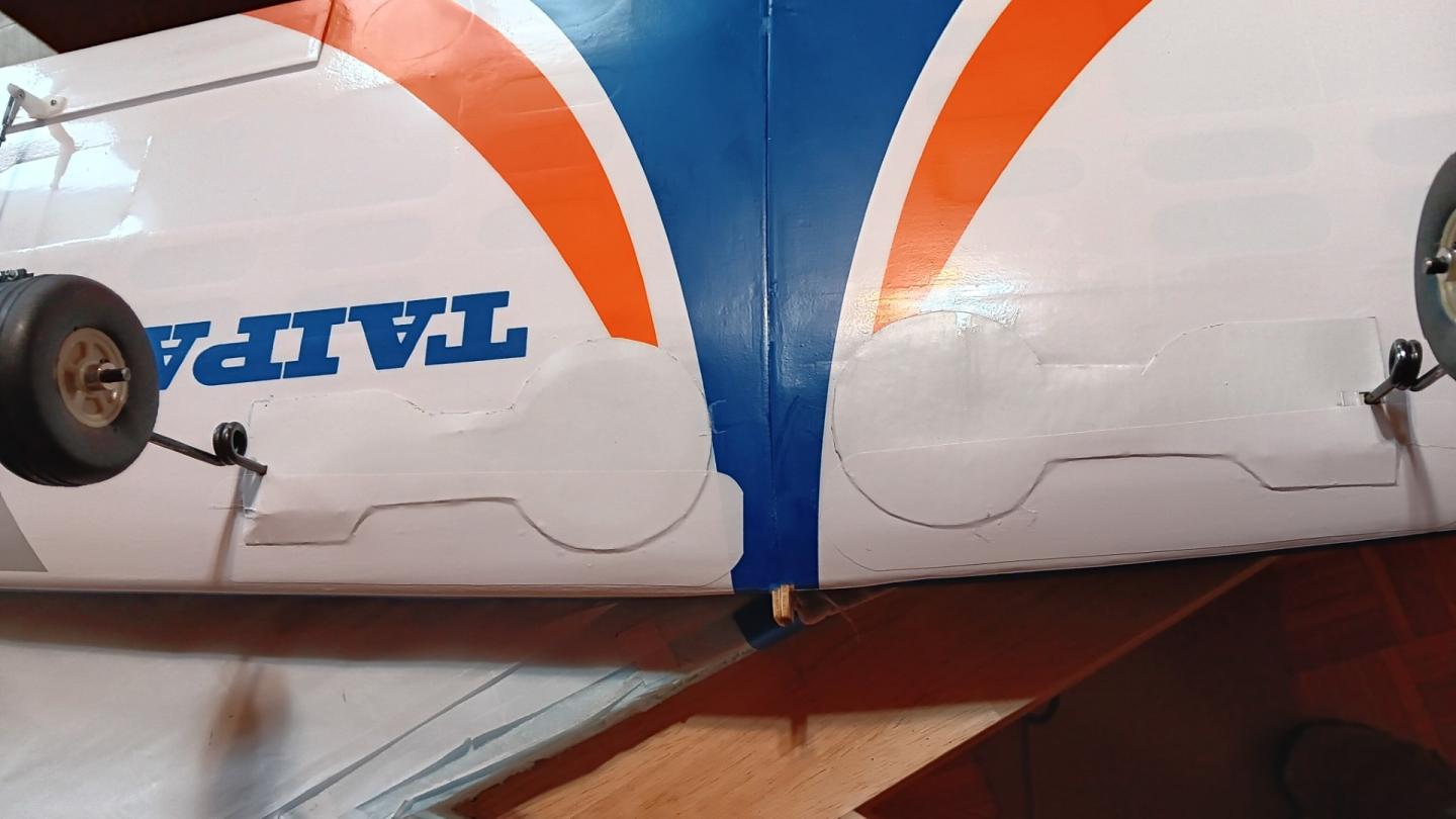

                                I used the fixed landing gear from the kit. I did not like the provided plastic cut-outs for the open holes in the wing. I made the hole covers from cereal box cardboard and spray paint. I attached them to the wing with thin CA. I used the patch fabric in the kit to cover the leading edge of the plugs to keep them from peeling back. I may cover the rear half of the plugs for additional cleanup if they start peeling.
