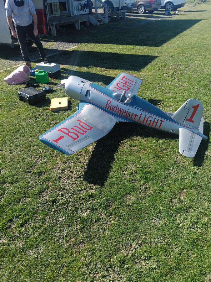

      I saw a large Corsair fly (2.5 m span gas ,) at my new field .. Click image for larger version
ID:	440921 was beautiful. Except 4 1 thing. The damb. 2 blade prop. Just does not look right.... So I'm on your side aros

          #124
          I saw a large Corsair fly (2.5 m span gas ,) at my new field .. was beautiful. Except 4 1 thing. The damb. 2 blade prop. Just does not look right.... So I'm on your side aros
          AMEN Ausie!
          There is NO WAY on God's green earth I am slapping some non-scale 2-blade on ANY of my warbirds, end of story, period. I don't care how much more efficient they are or better top speed. Bleck.
          Give me scale or give me death!

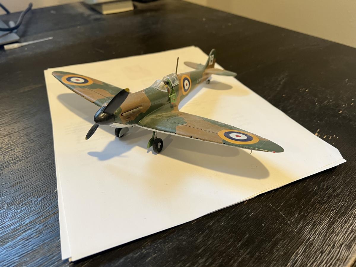

              Craig, the only dispensation I could grant you for flying a 2-blade prop might be a Mk.I Spitfire that had a fixed pitch, wood prop very early in WWII. But that didn't last long. But I agree with you, a P-51 with a two-blade prop on it just to get a bit more performance on it just doesn't work for me!
              Cheers

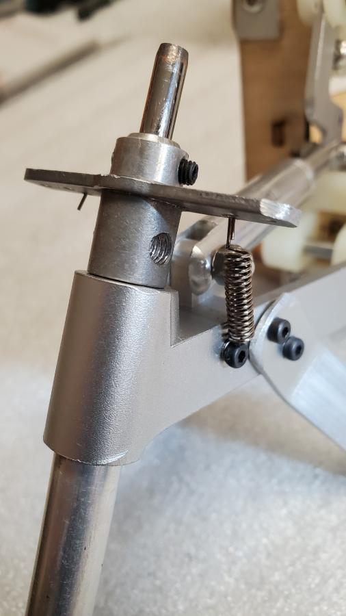

                                    Have you had any problems with your TopRC tailgear steering arm? Someone on RC Universe back in 2021 (?) reported an issue with the soft aluminum not holding the set screws.
                                    Mine has the same issue. The tailgear shaft slips a lot from just the force of the attached springs.
                                    I have searched all over the internet for a replacement. The only double steering arm I could find has a single set screw and is sold by aliexpress. Copies of that can be found on ebay.
                                    The plane is not safe to take off or land with an unsteerable tail wheel.
                                        Yikes! I was NOT aware of that issue! I will look at mine closely. I'm still months away from the maiden. Thank you for pointing that out.

                                          I filed down the existing flat spots on the shaft to allow the set screws to turn in deeper and get more thread contact, and they seem to be holding a lot better now. They will need to be checked carefully before each flight.
